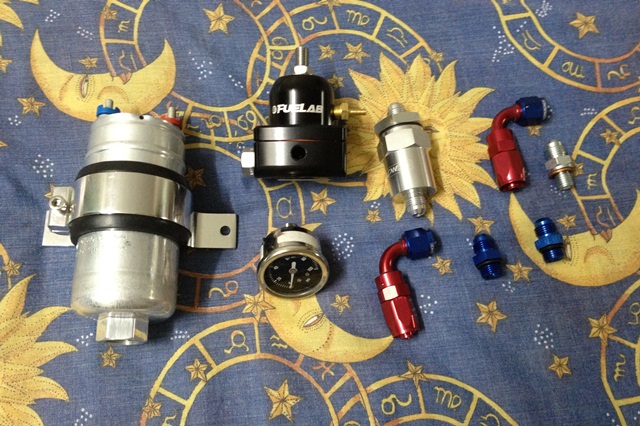

Over the last couple of weekends I fitted up the fuel system.

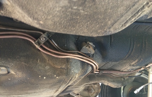

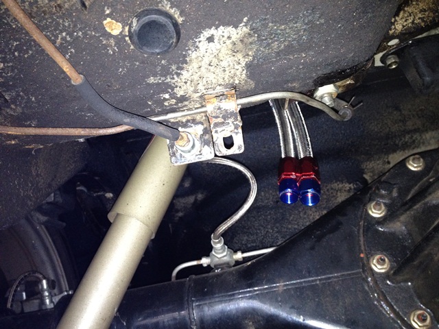

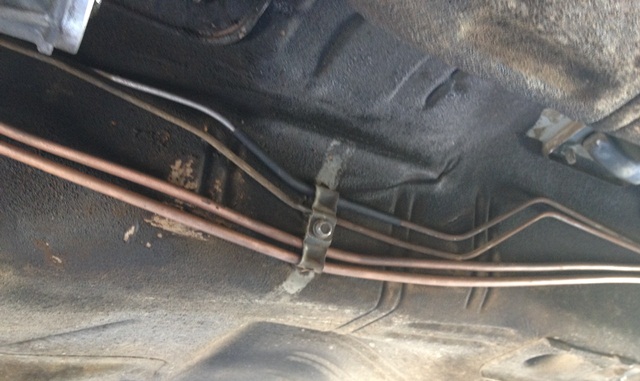

New Bundy lines
Some bits and pieces

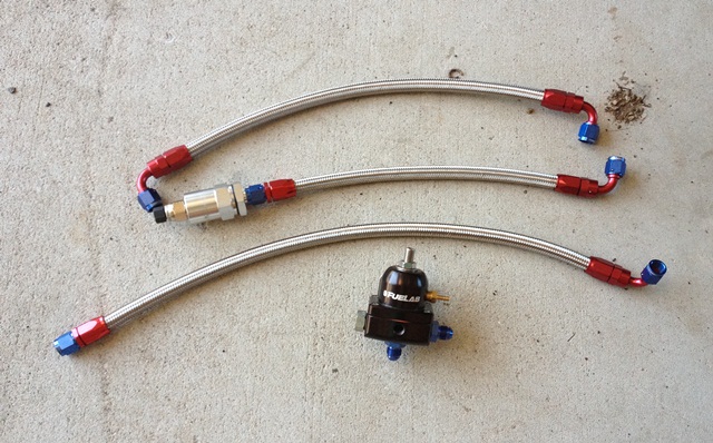

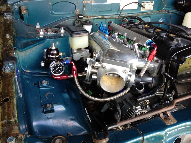

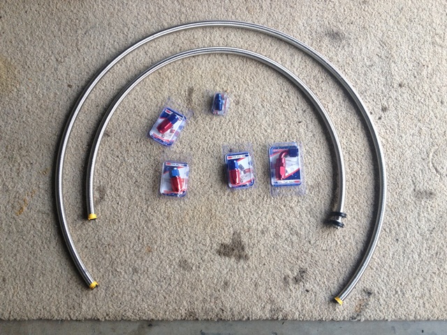

Stainless steel braid lines that go between the tank and the Bundy lines
More stainless steel braid lines between the bundy lines and the fuel pressure regulator/ fuel rail

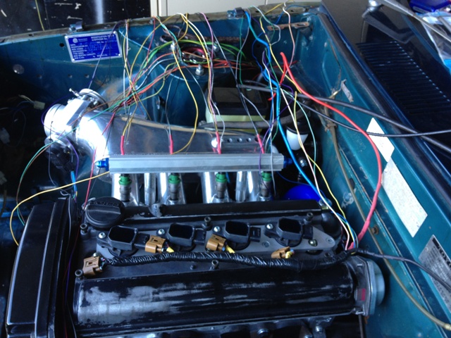

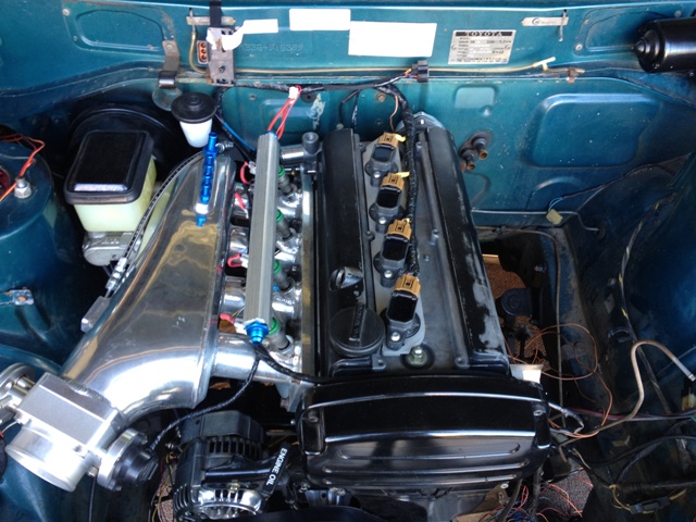

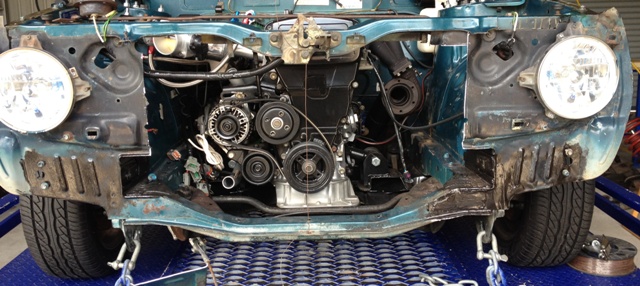

An engine bay shot

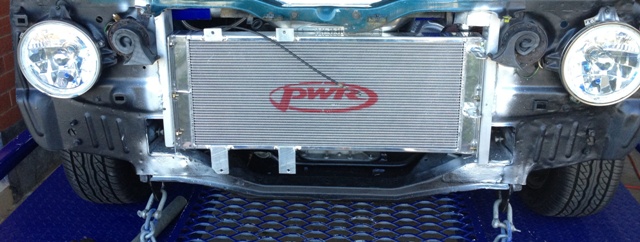

It’s been a little while between updates …. I have been sorting out the radiator.

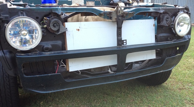

I wanted a bigger then standard radiator so the only way it was going to happen was to do some slight modification to the radiator support.
The below pictures shows where I was going to make for a bigger radiator (see the white line as a guide line ~ being equal distance from the centre of the car)
The result

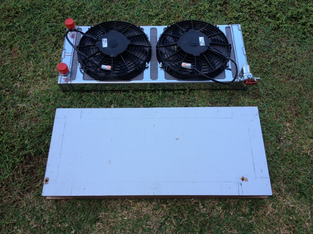

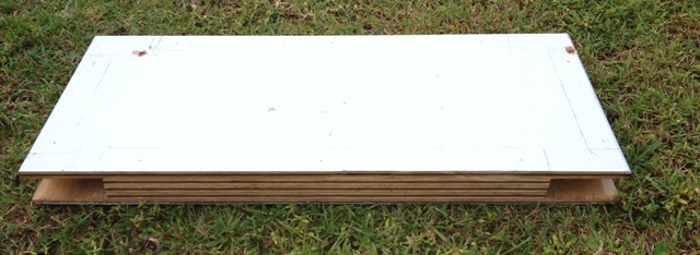

After contacting PWR about core thicknesses, I made up a dummy radiator (out of timber full size) to see if it will fit with the engine/engine bay.

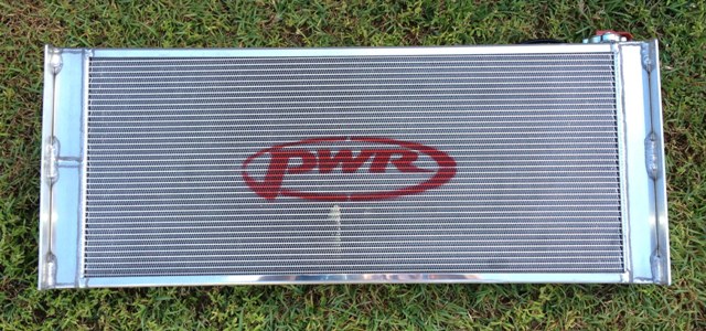

It all measured up how I planned so I placed an order to have a new twin core radiator made up to my specifications and about 3 weeks later it arrived.

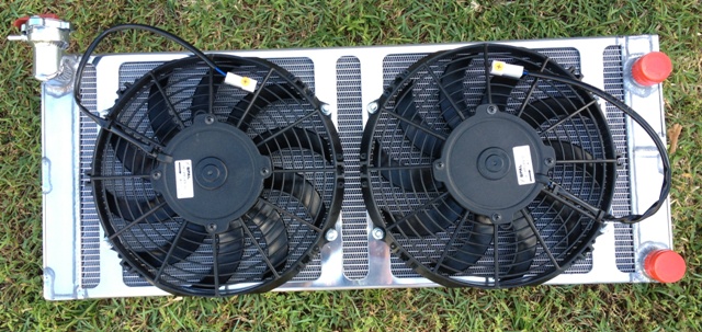

Dummy radiator and the new radiator
All fitted up with new radiator supports welded in.

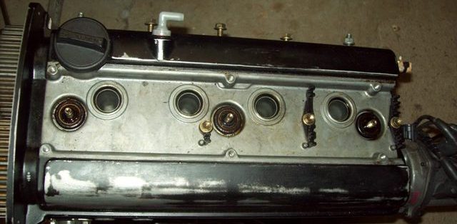

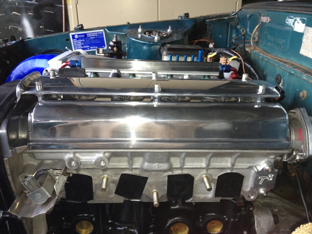

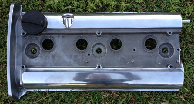

Hit the cam covers with some paint stripper and then a little bit of polishing.
Before
After
What it looked like in the car
Before
After, but this time with an aluminium valley cover
Before
I did not get a lot of pictures of making the aluminium valley cover
I thought about buying one of the Carbon fibre things that do not fit properly, and I think a plastic look would not look right on a vehicle of this age (and I like shiny things) :)

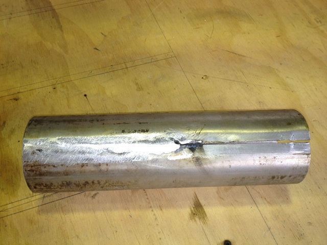

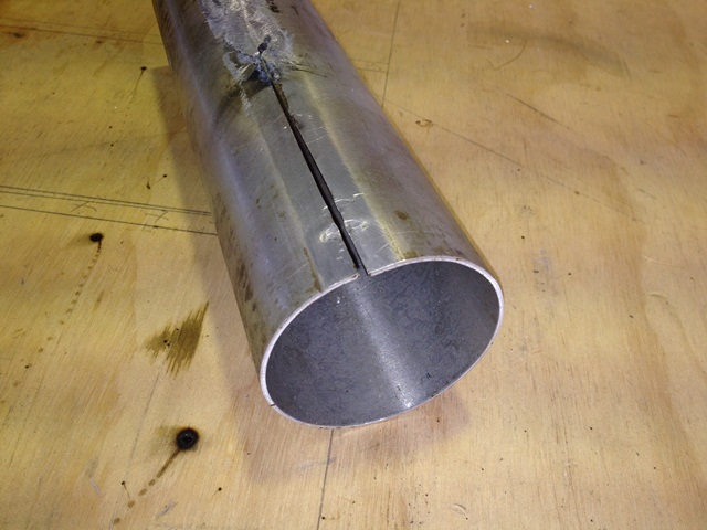

Been looking all week and do you think I could find any 70mm diameter aluminium tube anywhere......... Noooo
Need some to start making the intercooler piping !
Looks like I will have to make one

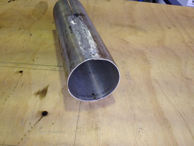

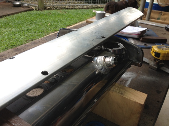

I had some aluminium sheet that I cut to make a 70mm diameter tube/pipe once it was rolled. I made the pipe length longer then I needed.
Pictures in the making
The finished tube/pipe all polished up with a side piece for the blow off valve

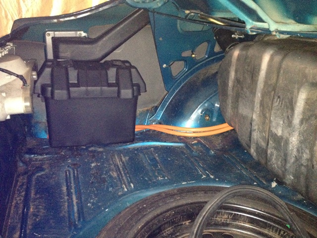

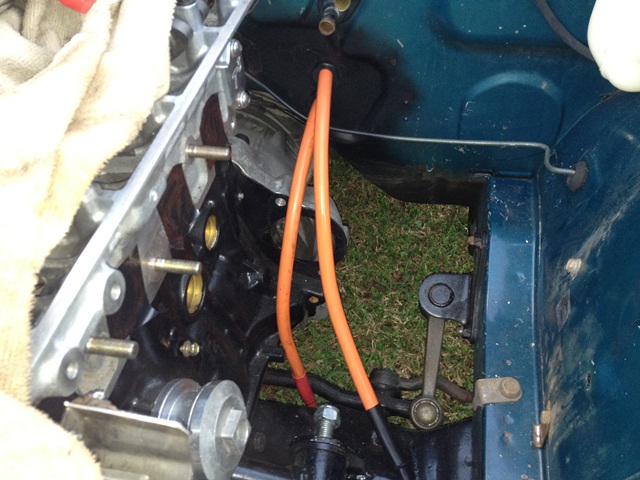

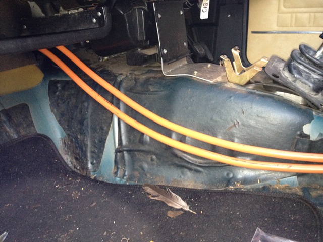

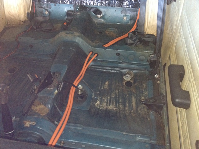

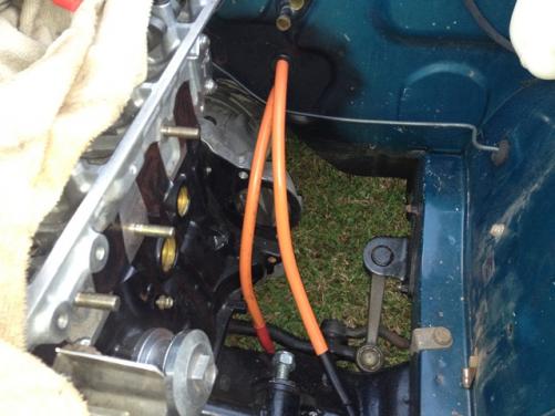

Finished off all of the wiring over the last couple of weeks with the last of it being the wires that run from the battery in the boot. The battery wires are 50mm² which are huge. They run through the car, coming out through the firewall into the engine bay.
The list to do is getting smaller and smaller, the next thing to do is the intercooler and piping and the oil cooler.
