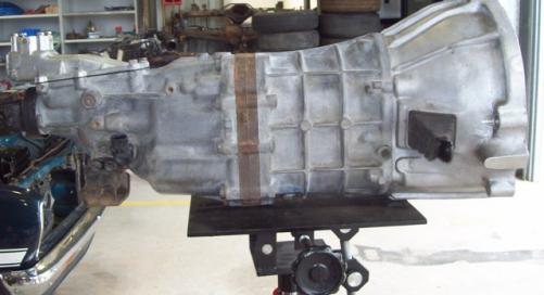

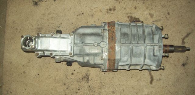

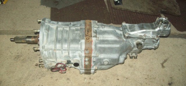

My W58 gearbox turned up last week.
Now I know that the W55, W57 and the W58 all look the same from the outside but below is a simple little trick to find out what W5* box you have with out pulling it apart.
If you turn input shaft 25 full turns in first gear the output shaft will turn;
W55 1st gear = 7.01 on output shaft
W57 1st gear = 7.61 on output shaft
W58 1st gear = 7.61 on output shaft
If you turn input shaft 25 full turns in fifth gear the output shaft will turn;
W55 5th gear = 29.4 on output shaft
W57 5th gear = 29.03 on output shaft
W58 5th gear = 31.93on output shaft
Its best to use an old clutch plate on the input and an old yoke on the output shaft, place a white dot on them, now all you have to do is turn input 25 times & count the output.

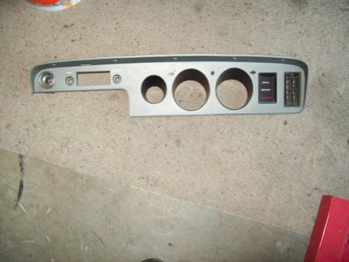

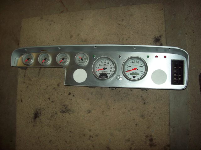

Ok, some more pics for you all.

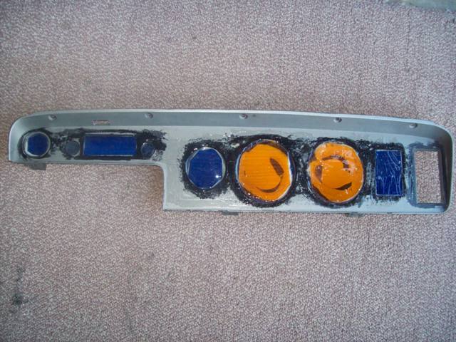

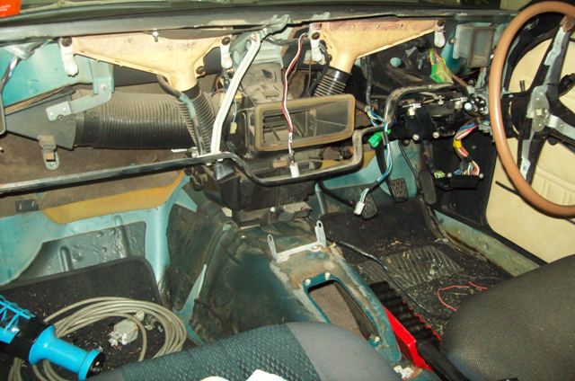

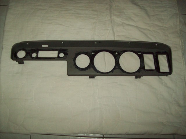

Dash is nearly all stripped out (going to total rewire everything as I am fussy at what I do)

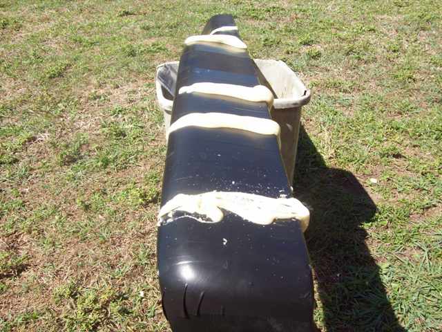

Filling in the cracks in the dash pad

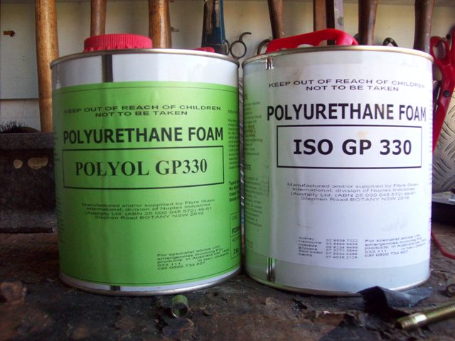

I used a 2 pack Polyurethane Foam

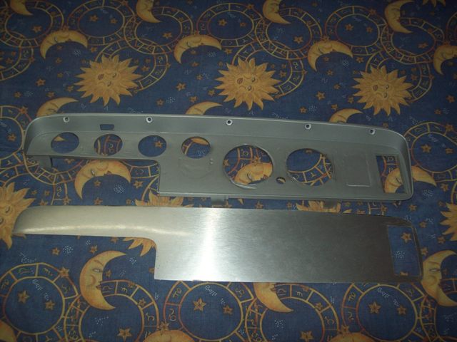

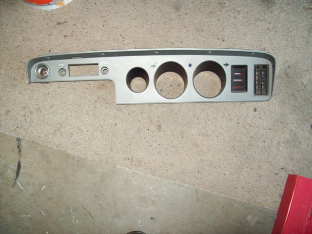

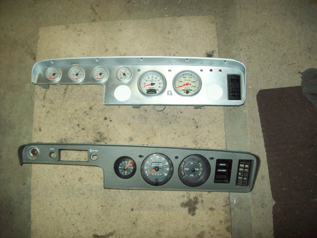

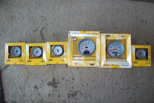

I bought these Autopro gauges
Standard dash panel removed
Got out the angle grinder and removed all of the raised webbing front and rear
Holes in the dash panel filled and then glassed overed
Dash all glassed up and ready for the stainless sheet face
New dash panel
New to the old (with allowance for 2 more gauges if I need in the future)

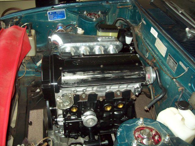

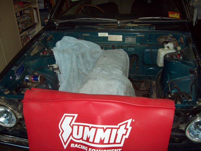

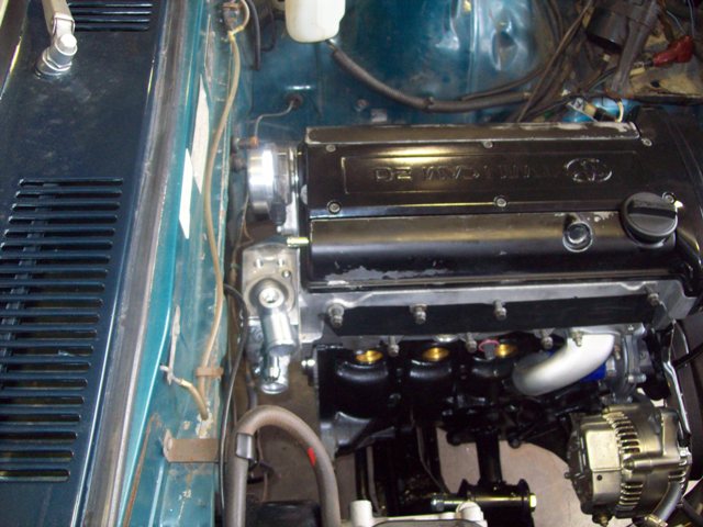

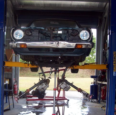

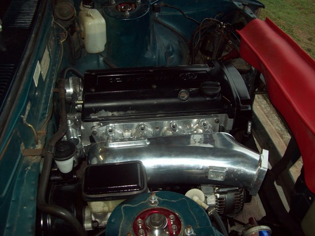

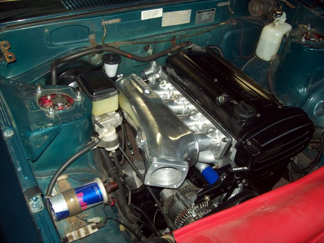

The last two weekends my little bomb has undergone a heart transplant. Well I’ll let the pictures do most of the talking.

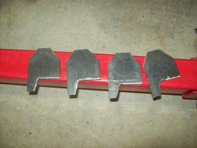

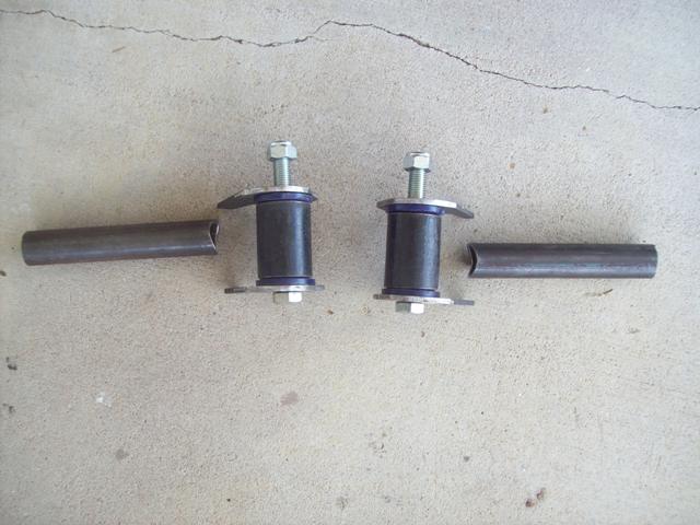

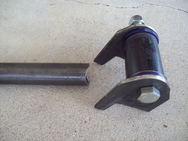

First of all I premade the engine mounts.
Removal of the engine

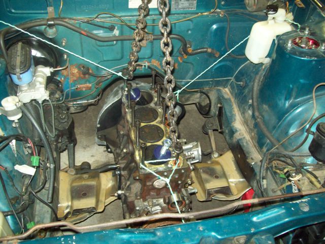

Fitment of a test block, making sure it was sitting in alignment before welding any of the engine mounts. To help the test block sit in alignment (level and in the centre) I used rope to hold it in place before tack welding the mounts to the engine.

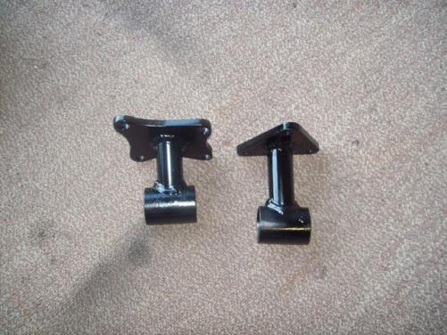

Engine mounts all welded up

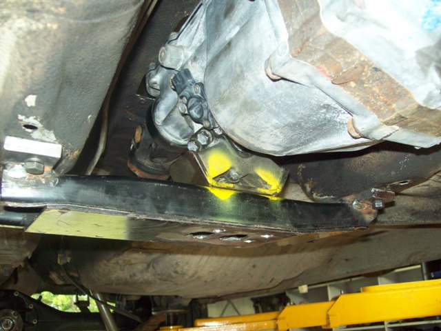

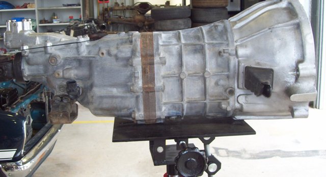

W58 on standard KE35 gearbox mount

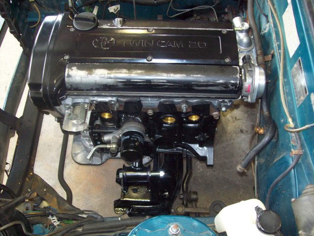

How the engine sits in the engine bay
W58 Gearbox and Nites Bellhousing

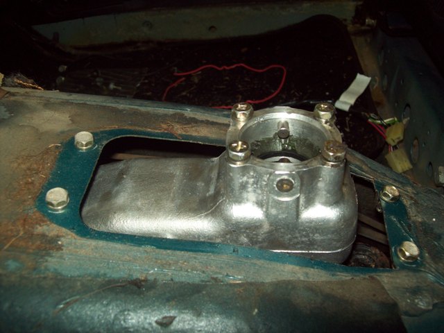

How the gear shifter comes through into the car.

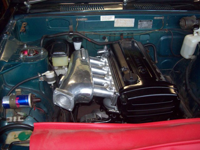

Engine sitting in place
  On 8/15/2011 at 11:17 AM, cuzzo said:
Did you want a shifter housing a bit further forward towards the firewall?
No, I think the shifter will be fine in this position (as I do not have to cut/extend holes in the transmission tunnel) and I can always bend the gearstick to suit if I feel the need to adjust it. Well that is what I am thinking now, because I ordered the gearbox to suit the hole in the transmission tunnel.
Do you have the shifter position closer to the firewall in yours?
