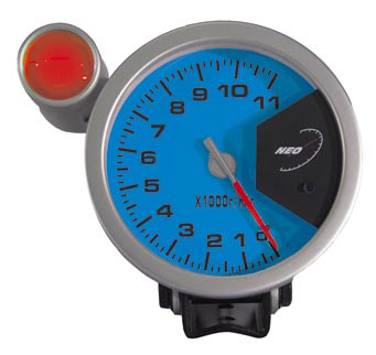

I got a hold of a dash cluster with a tacho in it for my ae92... when i fitted it all sorts of things were wrong because the wiring film on the back didn't match up to the lume I was plugging it into to. That and my speed ended up 15kph out so after 30,000kms I got really annoyed and changed it back.
I now find it just as easy to drive with out a tacho....
Hmmm so you have:
:wink:
If there is something wrong with the contact strip let me know and I will send you one I have here, You just pay postage, The one I have is green 221.
