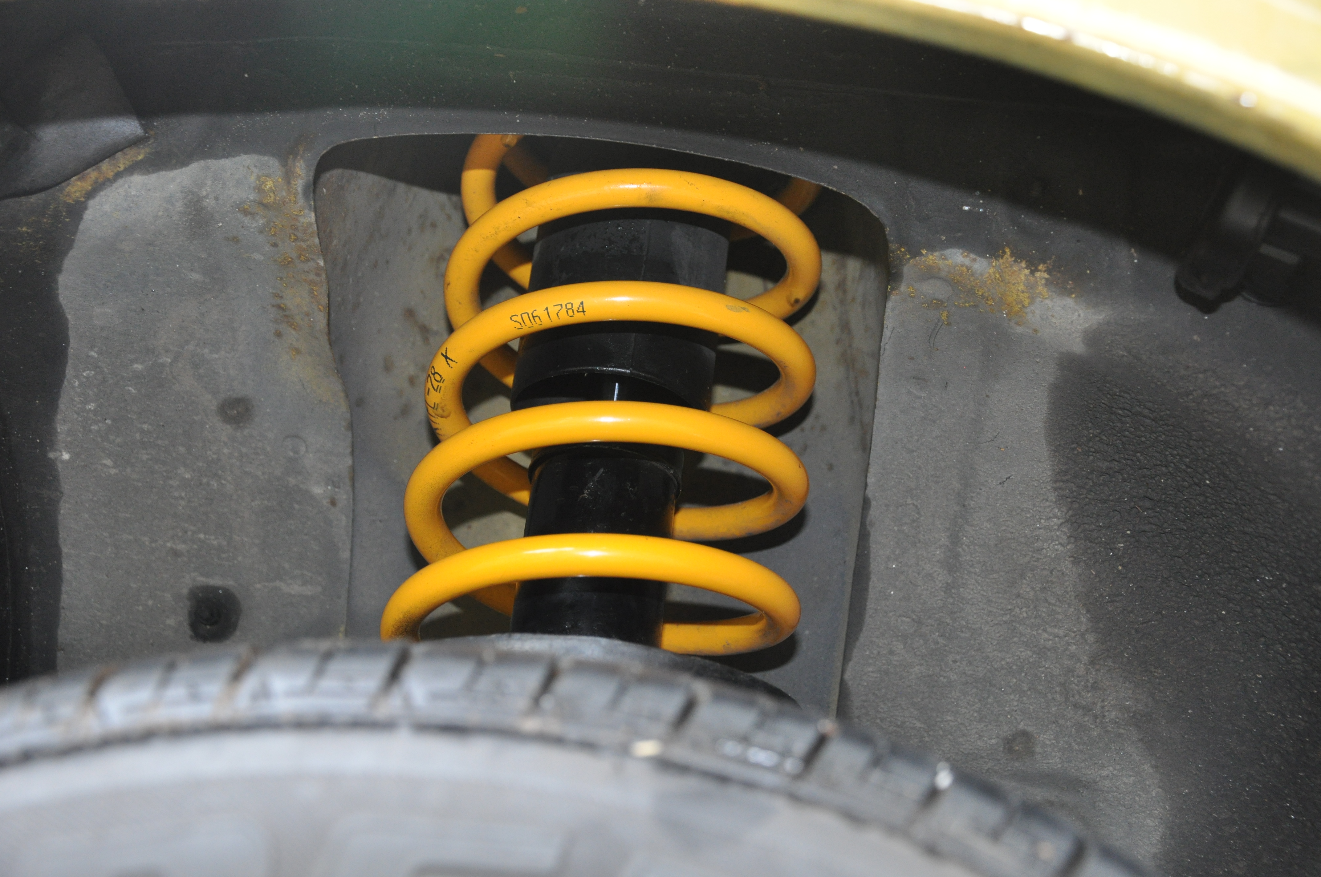

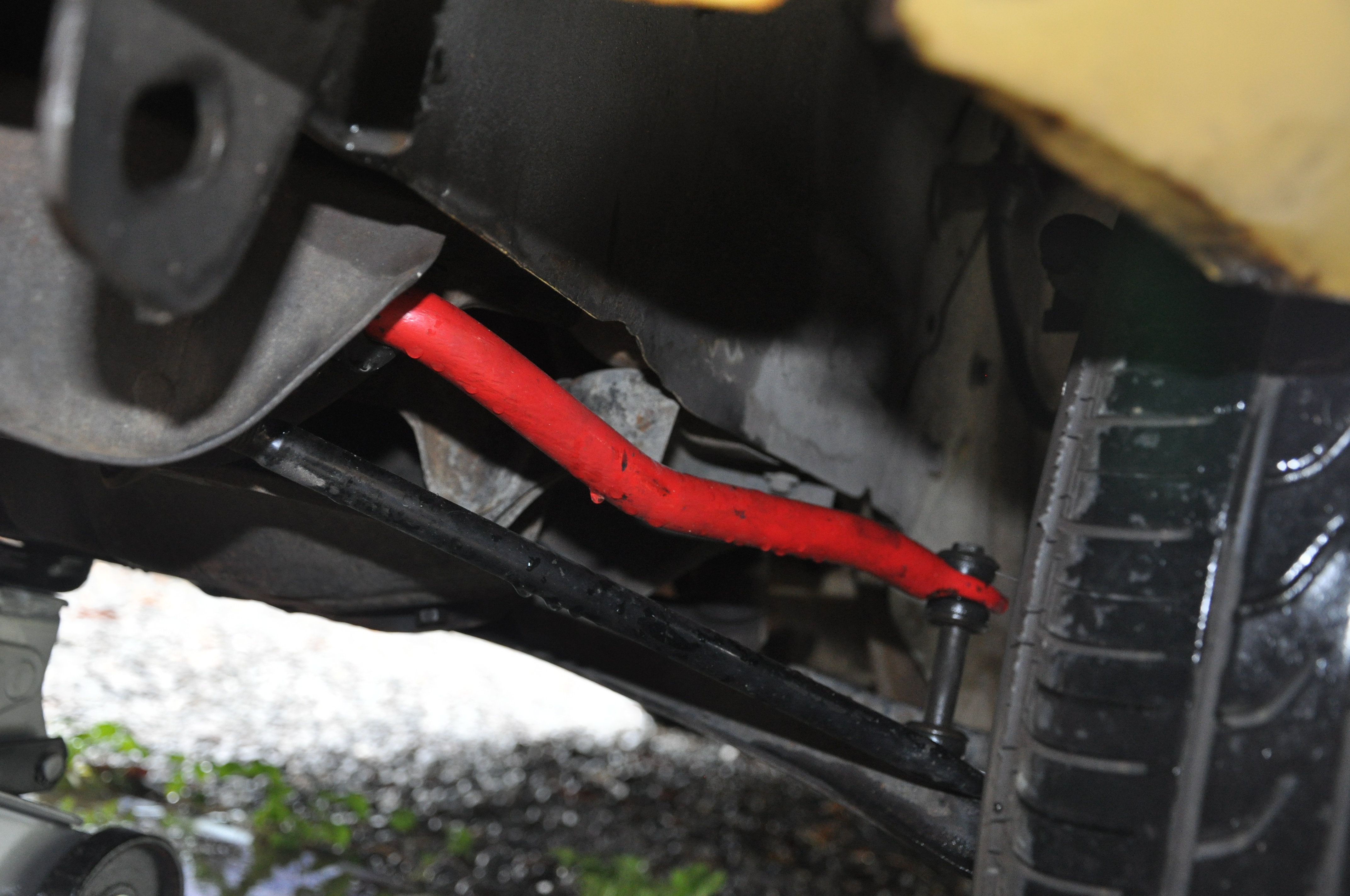

sNoOkDoG Posted March 8, 2011 Author Report Posted March 8, 2011 sweet no probs ryan, cheers i thought all t50 were a hydro clutch? I'm planning on setting up a hydro clutch anyway cas heavy duty clutches rape cables, got my eye on a t50 atm, not sure what its off yet tho. what do you mean hoe 'far'? ill be shoving the 3t crank and pistons in the 2tg block haha ill port the head and possibly shave it down a bit, may get a bore hone aswell, but new pistons will be $$$ so we'll see how much cash i have at the time yeah it will be a good small, light car and great for where i live (in the hillz :dance:) love your little beast aswell, wish mine was half that straight. no joke, i had no idea about rollas when i bought it aswell, haha its nice to have an uncommon rolla. just realized i havnt shown you boys what i did with th suspension! so here we go... put some nice king springs low springs in the front got a whiteline 22mm swaybar still need to replace the links to strut arm and the bushes on the tc rod a novelty added for fun also chucked another small leaf into the leaf packs, the difference is insane, going from some cut pedders springs (for sale $10 haha), stock 16.5mm sway bar and a stock leaf pack (with huge lowering blocks), to this^^^ i get just about no body roll which is handy to say the least! Quote

mgsmith Posted March 9, 2011 Report Posted March 9, 2011 hey man looks like a fun project just wondering how much you picked up the new king springs for the front for? and did you cut any coils off yourself? would love to see how the wheel arches sit now :yes: good luck Quote
parrot Posted March 9, 2011 Report Posted March 9, 2011 Loving your thread. Don't get too attached to that swaybar. Once the 2TG goes in, it won't fit anymore. Quote
sNoOkDoG Posted March 9, 2011 Author Report Posted March 9, 2011 ill get a pick up of the ride height now, its a bit too high in the front, but it still looks good, i think i got the springs for $120, got a mate at supercheap who got me 25% off :thumbsup: think they are around $160 normally? cheers parrot, is it really going to inter fear? dammit! i love this swaybar Quote
sNoOkDoG Posted March 9, 2011 Author Report Posted March 9, 2011 and no i took the cut springs out and put some lowered kingys in Quote
Tally Posted March 9, 2011 Report Posted March 9, 2011 Ta22 sway bar will fit around the 2tg :) Quote
sNoOkDoG Posted March 10, 2011 Author Report Posted March 10, 2011 sick thanks tally, do you know how well the ta22 sway bar lines up with the strut arm links? Quote
