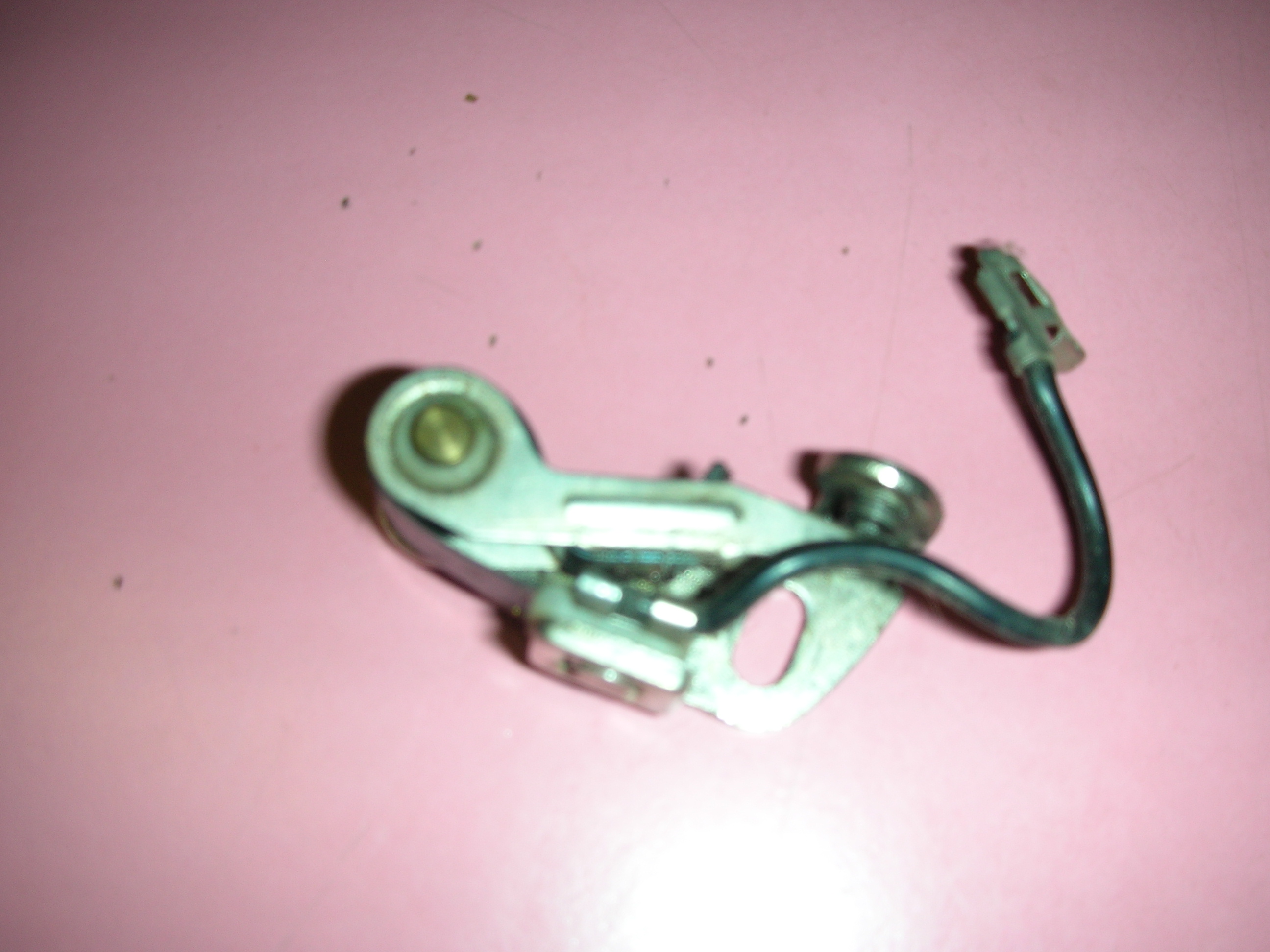

Old fella Posted March 7, 2011 Report Posted March 7, 2011 G`day Reed, these are what I found in an old Bosch 4K-C dizzy in the scrap heap. I`ve got some brand new ones somewhere but where is the problem. Cheers. Quote
B.L.Z.BUB Posted March 8, 2011 Report Posted March 8, 2011 (edited) Yeah, that's the points set I need. I'll get them to replace the ones they gave me. EDIT: Cheers Trevor I just stole that pic so I have something to show them. Edited March 8, 2011 by blzbub666 Quote
