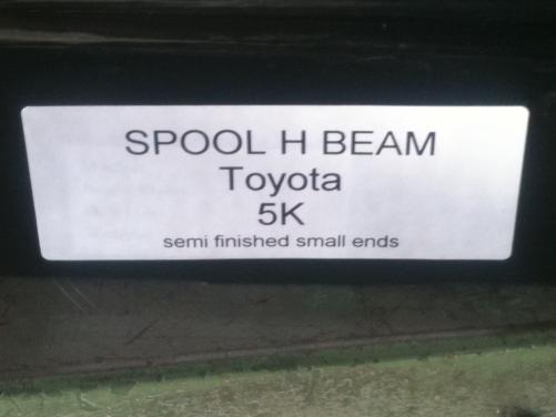

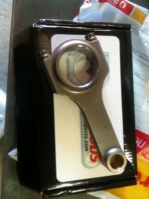

Taz_Rx Posted September 22, 2010 Report Posted September 22, 2010 On 9/22/2010 at 4:35 AM, 7FOUR7 said: Also, has anyone pushed the limits of stock rods yet? Just wondering if it would be worth getting the spool rods for the 5k or not? What are the advantages of a 4k head on the 5k? And how hard is it to come by an efi setup for one I've ran 22psi on stock rods. :happy: The spool would be a good idea if you can afford them though. 4k head on a 5k = low comp motor. Not hard to find 7ke (like mine) from a KR42R townace if you look in the right spots. Do a ring around of some commercial wreckers who deal in vans and trucks. On 9/22/2010 at 4:45 AM, 67Rolla-Ken said: You can buy EFI setups, I think they were off the 7K and some 5K's??? I'd rather stay as low tech as possible :wink: As above, 7ke from KR42R. There's also 4ke stuff but its overpriced and not real great. No 5k came out with stock EFI. On 9/22/2010 at 5:05 AM, SLW42 said: I will push the limits of a stock 5k for ya and tell you how long it lasts on 12pound of boostfed goodness, then up to 16 and by then i will have gone up to a bigger turbo than the t28bb :D Why? A BB T28 is pretty much ideal for a 5k. You won't want to go much bigger, and being ball bearing you can run over 20psi with no dramas. Quote
