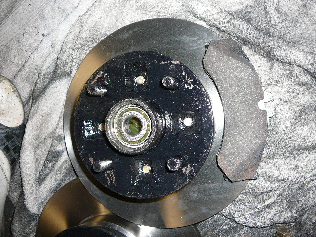

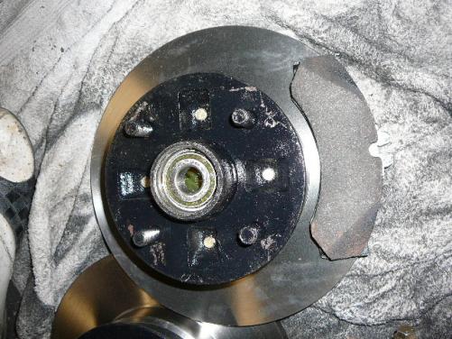

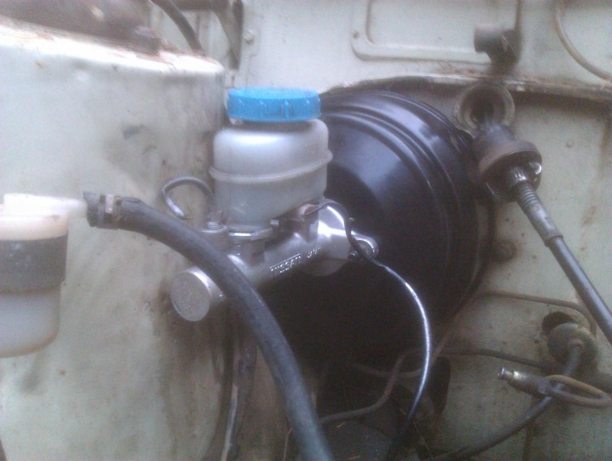

Evan G Posted May 13, 2012 Author Report Posted May 13, 2012 (edited) cheers bloke! basically this rebuilt hilux g series lsd diff w50 xt130's with sercet spring combo (maybe go 5 stud if I'm still getting the lsd) and secret 13/16 master/booster combo all behind a 4k. overkill? i don't think so Edited May 13, 2012 by Evan G Quote

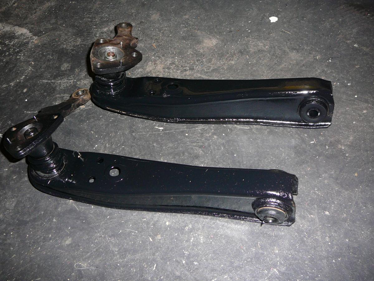

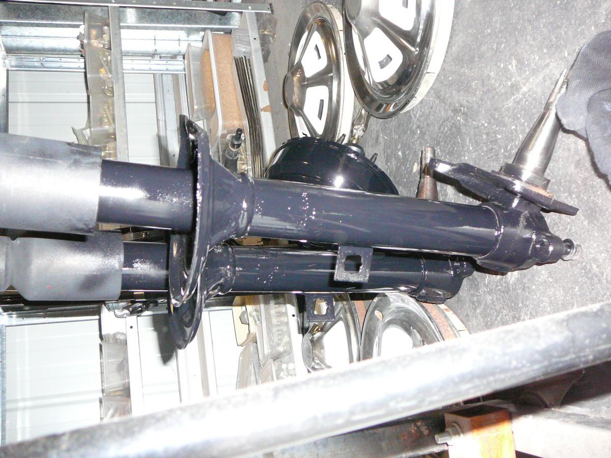

Jono.C Posted May 13, 2012 Report Posted May 13, 2012 What're the steering arms on those lca's? :S Quote
mhmills Posted May 13, 2012 Report Posted May 13, 2012 On 5/13/2012 at 2:10 PM, Jono.C said: What're the steering arms on those lca's? :S Those are the original sigma steering arms. Quote

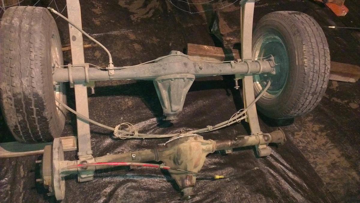

Evan G Posted May 14, 2012 Author Report Posted May 14, 2012 oright operation g series has comenced. will be removed tomorrow night g series and w50 for $400 ʞ©$ɟING WINNING! stay tuned Quote

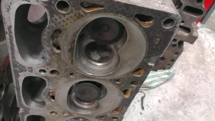

Evan G Posted May 15, 2012 Author Report Posted May 15, 2012 (edited) please take note of leaf spring mounts :D also since I'm going to have a bullet proof driveline. options current dirty 4k 7k complete with efi etc etc $1250. + turbo gear etc etc rebuild my 5k (big cc head and the mega dished pistons + 14psi) turbo gear etc etc etc ive oready decied 5k. new pistons. set of chromemoly rings and bearings thru her. and blower cam Edited May 15, 2012 by Evan G Quote
kickn5k Posted May 15, 2012 Report Posted May 15, 2012 That combo 5k d-dish pistons/4k large chamber head from memory gives 8.2:1 from memory. That's low enough for 14psi with a camshaft. Quote
Evan G Posted May 15, 2012 Author Report Posted May 15, 2012 cheers stu that was the aim for compression. i know the crank/rods are gonna be fine for 12psi. more that this i not sure the endurotec or the other more expensive pistons will last. my machinist also said that 7k pistons sit 2mm lower in the bore. even less compression? LOL Quote
