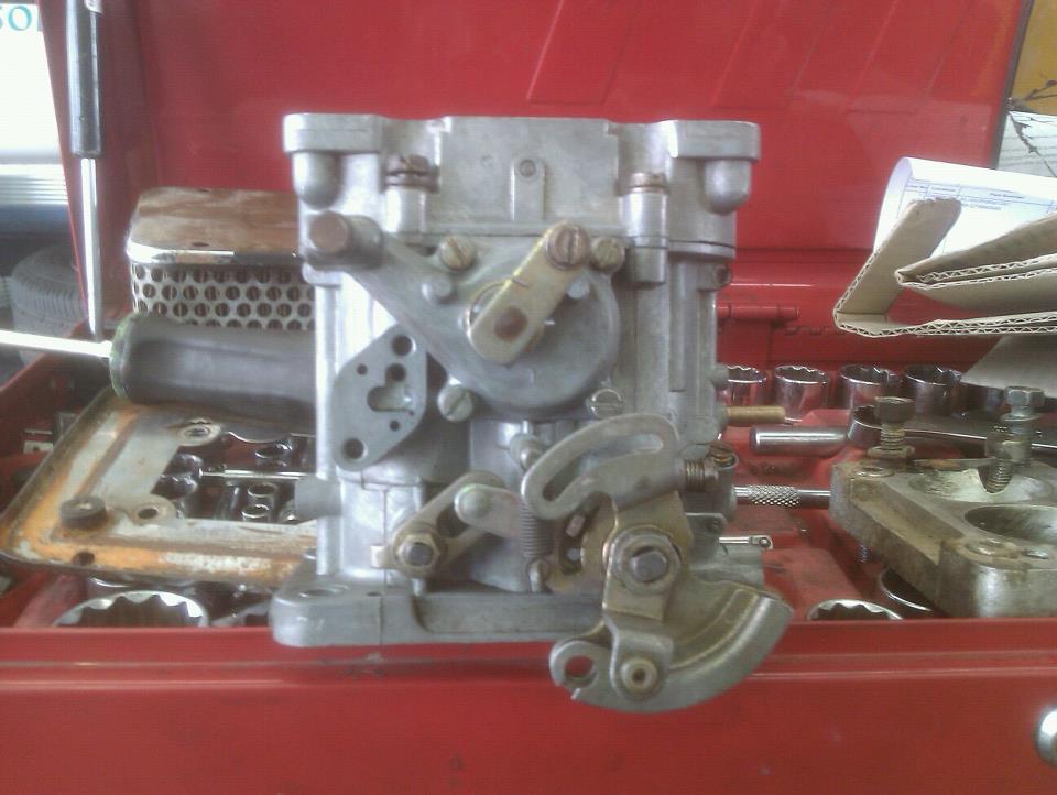

Evan G Posted January 10, 2012 Author Report Posted January 10, 2012 hohoho 28/36 DCD. mechanical sec :D so currently have 3 32/36dgav, 1 28/36 and a 28/36 dcd LOL anyone need a weber? wheel bearings are done for GOR! just need some decent 195/60R14 tyres! these 175/70 can't handle corners or the might 4k power! nomnomnomnom Quote
altezzaclub Posted January 10, 2012 Report Posted January 10, 2012 One day you will discover the mighty DCOE and all will change! :laff: Quote
