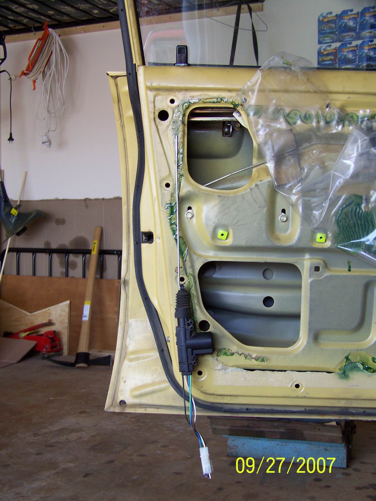

philthy30 Posted April 8, 2010 Report Posted April 8, 2010 InTrenches said: So today I bought a remote central and alarm kit for all 4 doors of my KE30. However they were going cheap at jb hifi so I bought them without checking if they can actully be fitted. Not a massive deal if they can't I can always sell them. Has anyone ever fitted them to a rolla? And any tips etc? From memory when i fitted mine there was a spot directly below the lock at the bottom of the door where theres a decent flat bit of steel to mount the actuator too. They work really well. Quote
towe001 Posted April 8, 2010 Report Posted April 8, 2010 About there (the door's from a '55 but it'd be the same) The back doors were a lot harder to fit up. Solenoid was at the top of the door, about midway between the door release and the rear part of the door and i had the cut up some of door near the release for the solenoids rod to go through. Never bothered with photos cause i always and still do reckon it was a hack job. Quote

oh what a nissan feeling! Posted April 13, 2010 Report Posted April 13, 2010 Have done my ke30 front and rear, was pretty easy, rear gets mounted on a horizontal, fronts vertical as shown. Can take pics i think...... not sure if i removed for sandblasting............ Quote
