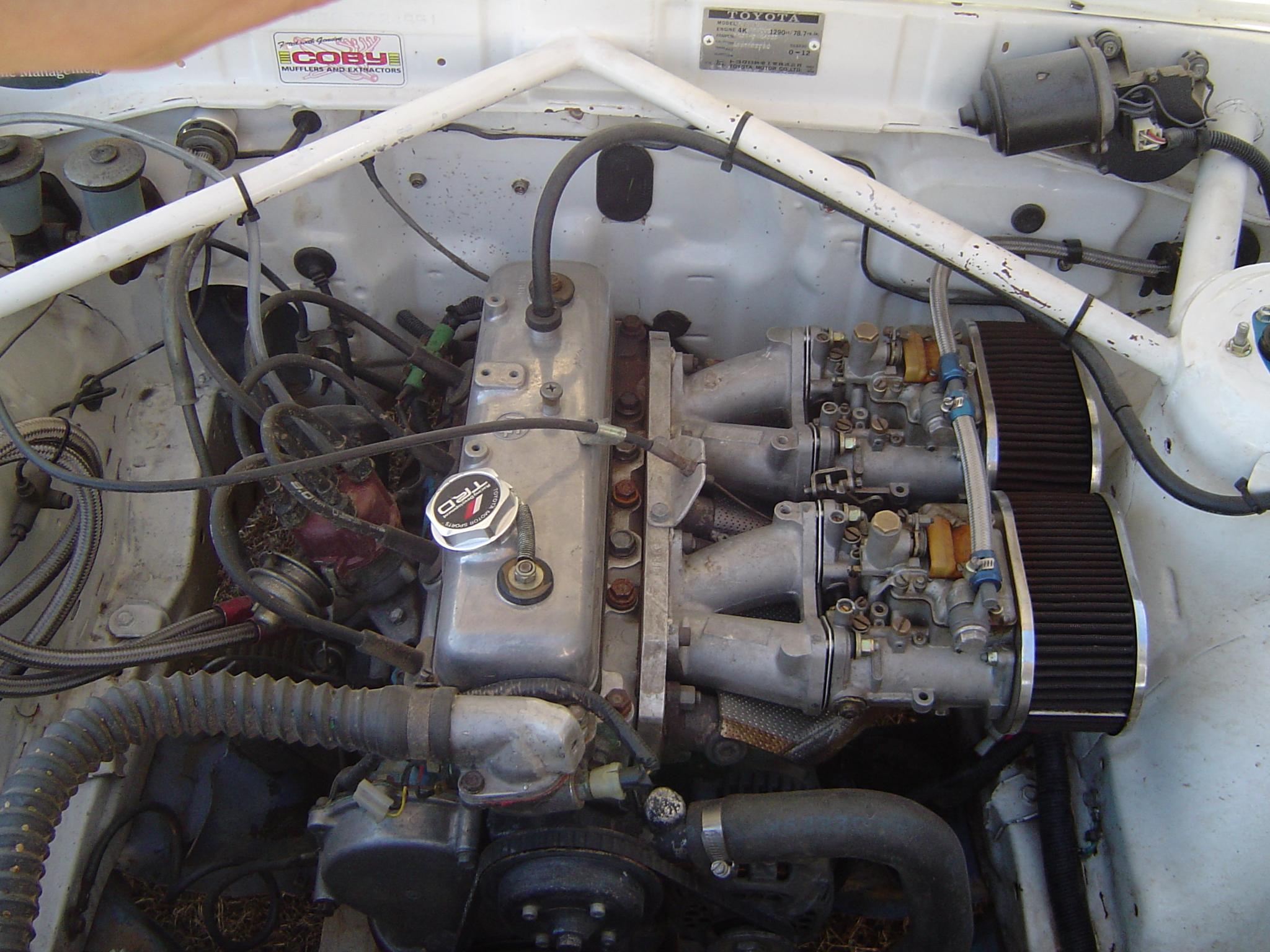

TRD ke70 Posted April 11, 2010 Author Report Posted April 11, 2010 here is the old engine, manifolds with base plate, engine mounts, oil pick up, gear stick, sump, extractors, all have to be modified or changed. Quote

jimi91 Posted May 18, 2010 Report Posted May 18, 2010 here is the old engine, manifolds with base plate, engine mounts, oil pick up, gear stick, sump, extractors, all have to be modified or changed. hey just woundering if ya had any measurments or plans on that upright kit I'm looking at doing one myself for my rolla at home see ya jimi Quote
Taz_Rx Posted May 18, 2010 Report Posted May 18, 2010 The engine mounts for uprighting is pretty simple. Its doing something about the new angle of the gear stick shifter that can be somewhat of an issue. Quote
Doogs Posted May 19, 2010 Report Posted May 19, 2010 That thing sings ! What a sweet little K motor. :rolls: Looks like a handful of fun mate. Quote
TRD ke70 Posted May 19, 2010 Author Report Posted May 19, 2010 Sorry Jimi, only have the TRD uprite parts info. you would need to find someone who has one in bits to get the measurements. The base plate for the inlet manifolds would be the hardest info to find i think. Have just looked at the shit i have, and i must have photocopied the base plate years ago, and i still have it. Unfortunately my scanner isn't big enough to copy it. Quote
