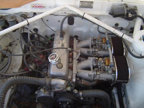

TRD ke70 Posted April 3, 2010 Report Posted April 3, 2010 (edited) We won the mainland rally 1300cc championship in this car in 1992. Edited October 23, 2010 by TRD ke70 Quote
anastasios Posted April 4, 2010 Report Posted April 4, 2010 daymn, how did you build that engine? Quote
TRD ke70 Posted April 4, 2010 Author Report Posted April 4, 2010 It was a standard bottom end, including pistons, the cam was a 43/78, trd uprite kit, 2 dellortos, ported head with 12:1 cr, running avgas, only revved to 8 grand. nothing special!! But f@$k it went like a dog shot in the ass. Up to 100km it would keep up with a mazda 4wd turbo. Quote
anastasios Posted April 4, 2010 Report Posted April 4, 2010 what gearbox did you run behind it? and where did you get the upright kit from? Quote
TRD ke70 Posted April 4, 2010 Author Report Posted April 4, 2010 The gearbox was a standard k50, we did have a TRD close box but never used it in rally's as it was shit.(wrong ratios) We bought the last TRD up rite kit that was available in NZ at the time(1988) if i remember right. Quote

KE70slider Posted April 11, 2010 Report Posted April 11, 2010 It was a standard bottom end, including pistons, the cam was a 43/78, trd uprite kit, 2 dellortos, ported head with 12:1 cr, running avgas, only revved to 8 grand. sounds the same as my motor just no upright kit and webers Quote
Mitch-12 Posted April 11, 2010 Report Posted April 11, 2010 sounds the same as my motor just no upright kit and webers whats a trd upright kit? Quote
Hiro Protagonist Posted April 11, 2010 Report Posted April 11, 2010 whats a trd upright kit? The K-motor normally sits on a lean towards the passengers side (ie the intake/exhaust side). An upright kit rotates the engine so it doesn't sit on a lean, which helps for adding side-draught carbies (otherwise you have clearance issues with the strut tower) Quote
Mitch-12 Posted April 11, 2010 Report Posted April 11, 2010 The K-motor normally sits on a lean towards the passengers side (ie the intake/exhaust side). An upright kit rotates the engine so it doesn't sit on a lean, which helps for adding side-draught carbies (otherwise you have clearance issues with the strut tower) so jus engine mounts and stuff Quote
