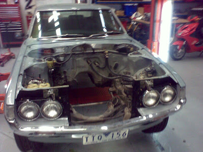

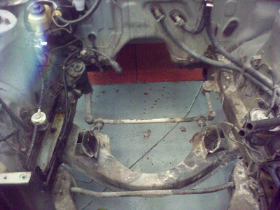

silverra23 Posted November 15, 2010 Author Report Posted November 15, 2010 Well with a workshop free of race cars, I decided last weekend was prime time for doing the engine change in the Celica! Thursday night the guys helped me whip out the old engine in under an hour... many hands, beer and a hoist make light work! Then Friday night the boys helped me give the engine bay a really good clean and it came up great. Lots of kudos to Loctite Natural Blue degreaser... I then painted the cross member flat black as we took off most of the paint with the degreaser and pressure washer :) I then spent Saturday and Sunday fitting everything up... engine was in Saturday night... Sunday was fitting carbs, plumbing things, wiring things etc etc... didn't quite make my Sunday afternoon fire up as planned, but its close. Big thanks to Matt for stopping buy and lending a hand too... and doing a quick dash to Repco when I needed it most! Couple of niggles I need to sort: 1. Clutch only starts to give some pressure near the floor... not sure if it needs more bleeding, or an adjustment at the pedal. I have run out of adjustment on the pushrod... so hopefully will fiddle some more tonight and get it better. 2. Battery was flat so I couldn't get it running... hopefully it charges up today and it will be all good. 3. My gearstick is awfully close to the dash in 1/3/5 gears. I will take it out and try it the other way, but I am pretty sure I already put it in with the bend pointing away from the dash. Are there different sticks for different Toyotas? This isn't the stick that came with the box... it was a god awful shortened thing.. so I sourced a separate stick from someone here years ago..... Anyways pics tell the story... Dodgy gearstick? Oh and in other news I worked out why the front of the car was not sitting at a "lowered" height... got done by another set of standard height king springs sold as "lows" second hand... grrrr... so need to acquire some king lows for the front at some point soon. Quote

silverra23 Posted November 15, 2010 Author Report Posted November 15, 2010 Update... clutch sorted... New issue - no idle mixture screws in my rebuilt carbys.. think they have been left out accidentally :( Anyways I got it to briefly fire tonight so happy days!! Quote
