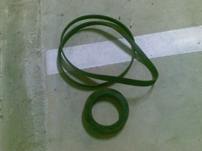

sleepercorty Posted April 15, 2010 Author Report Posted April 15, 2010 had to go to a mates wedding last weekend which was 1000km round trip so took cressida as it is my most reliable mode of transport, made the trip there fine then my ballancer decided it wanted to become two pieces so being 500kms from home what else do i do other than go to repco and buy some sikaflex (mind you it cost me $24 from repco for a cartridge of sikaflex when we buy it at work for about $7 same product). so after i recovered from being bent over from repco i applied the sikaflex to the inside part of the balancer that was still bolted to the motor and slid the pulley back on. i then quickly put the belt on and started the car for about 10 seconds so the belt could make sure the pulley was running true before it dried. i then left over night to dry and drove the 500kms home the next day. then after arriving home decided it best to buy a good balancer instead of just replacing it with the spare standard one i had. so got onto Jamie at Forced Fed Performance and he did me a great deal on a Ross metal jacket balancer. so now i can do 8500rpm and not worry about my balancer exploding. Quote
