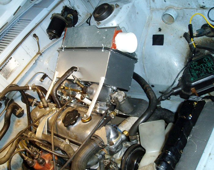

When I fired up the SUs they were very grumpy at idle and I thought the same would happen with my enormous custom airbox, so I put a couple of struts on it. I'd helped Rob rivet plates over his cracked pancakes a week before.
