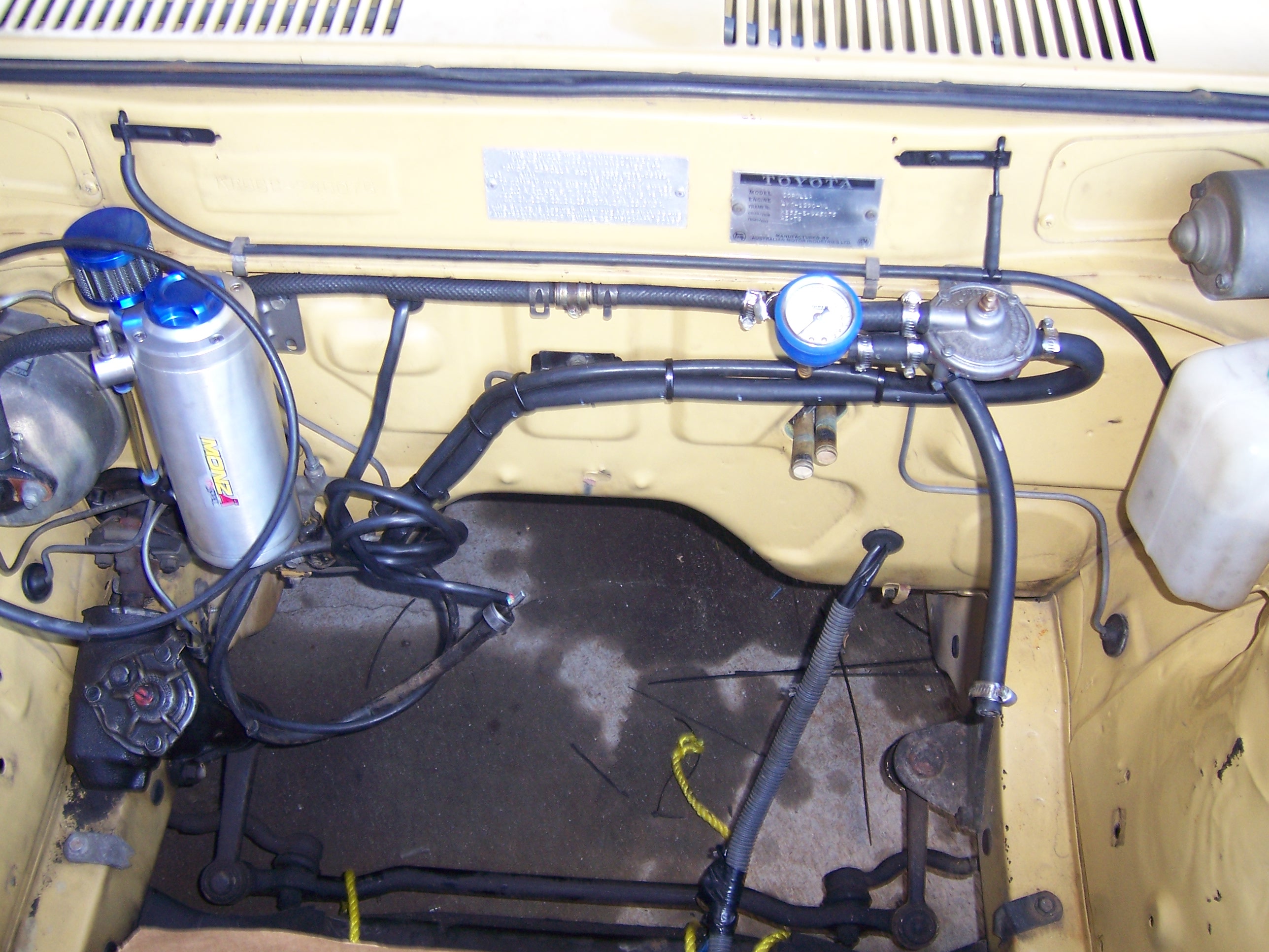

FYI - If you set up all of the fuel system for the turbo setup you can swap over to a stock carbed 4k with the same fuel setup no worries. You might just have to wind down the fuel pressure slightly if you're using a stock carb. :jamie:
Here's a pic of how I set mine up with a guage.....
The hose hanging down is actually the brake booster line (with I took the boost reference from). The fuel line to the carby is off the back of the guage, you can just see the brass fitting. :blush:
doesnt were you have put your catch can, annoy the crap outta you for changing clutch cables???????
Photo makes it look worse than it is. There was still plenty of room there for the clutch cable. Catch can was only there to cover up a hole in the firewall from the hydro clutch that used to be in that car. :jamie:
