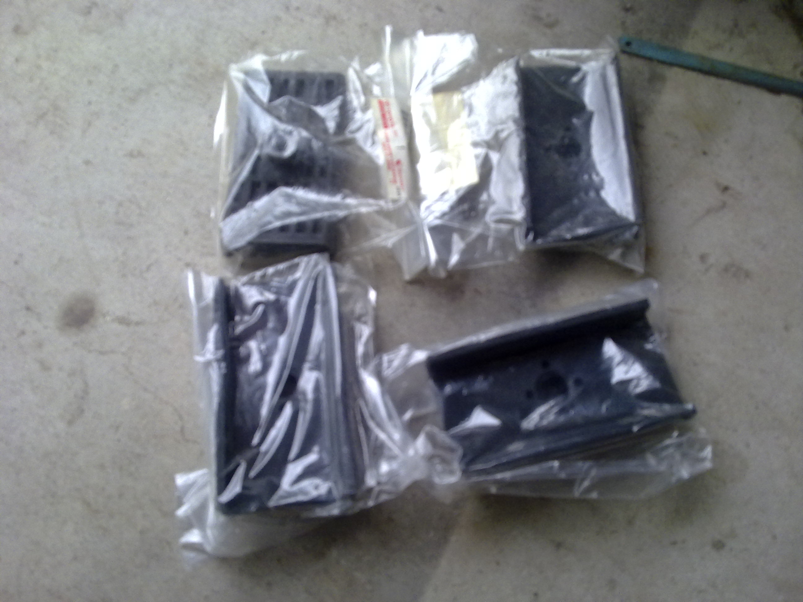

I just went through this. They said that there were two left in the country. I bought those and waited weeks to get the other two from Japan. You can still get them.

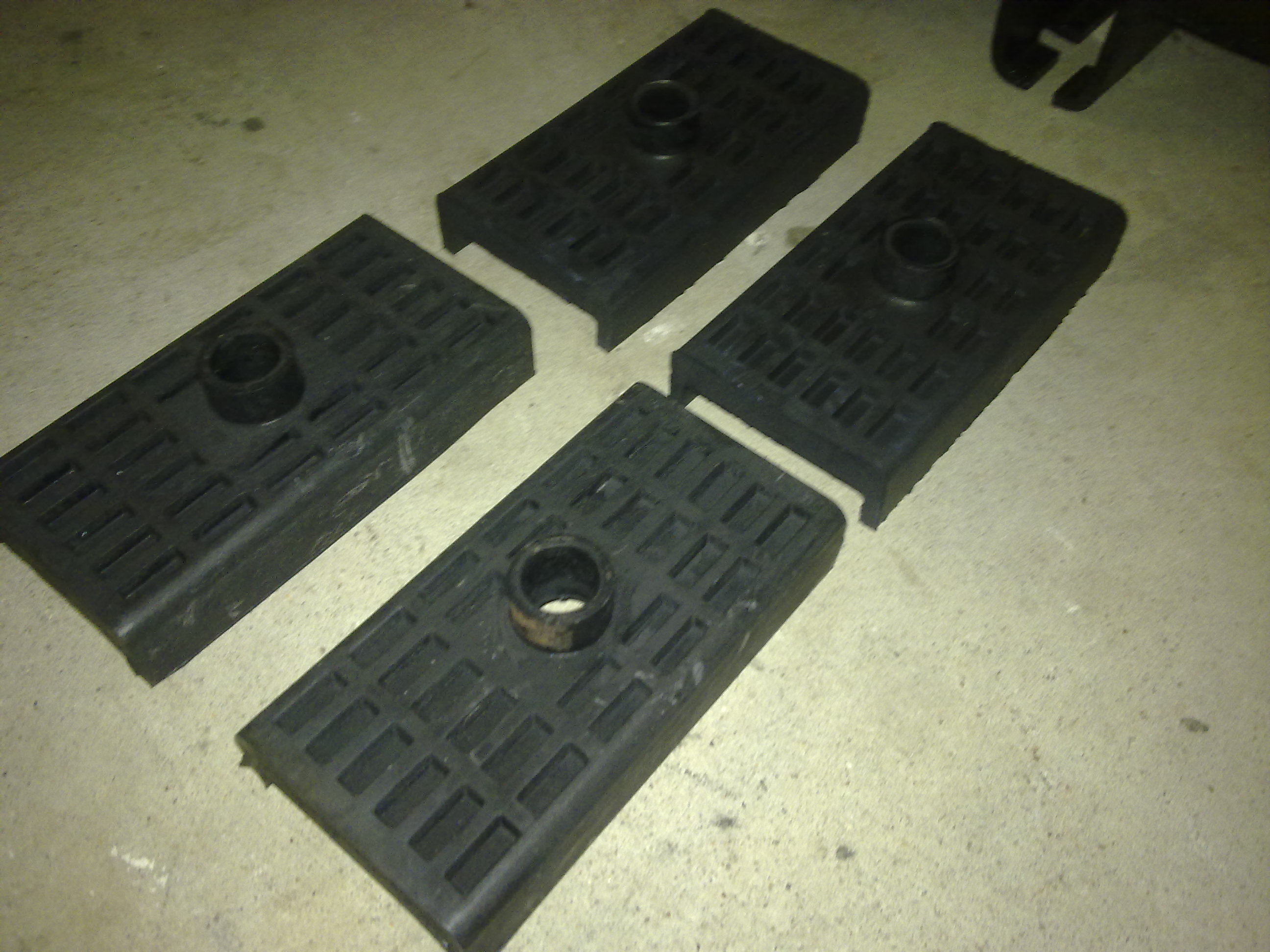

there is a place here in adelaide called technical urethanes that have made these up for me out of urethane with an aluminium spacer.
they would still have the jig. call em! cost me $60. may cost more for other people as it was a trade price specially for me.
but if your keen i may be able to hook you up.

i already have done it quite a while back. and there wasn't any interest then. anyone interested PM me and i'll see what i can do.
they fit well to standard springs. i found that the new ones that industrial springs made me was a bitch. as they used a slightly larger bolt. even stock ones didn't fit properly
so if you got standard packs then they would be fine. if you don't you need to file the spacer a bit.
