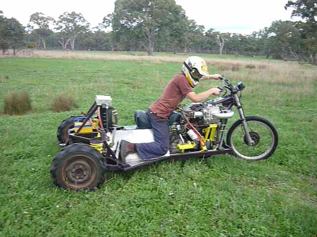

4k trike Posted May 9, 2010 Author Report Posted May 9, 2010 finally got it all back together charger msd eletric diz are all on gave it a run in the paddock goes great bit slow of the line hope its the timing or flat spot in carby but ive done a head gasket i think hope like hell its not a cracked head go to town tomorrow for extractors,head gasket and a few small fittings gee i hope i havent done a head on the up side the msd unit is good highly recomended f@$k i got a zap from it the motor sounds crisp can't wait for sunday 16 may not long to go now Quote
Evan G Posted May 9, 2010 Report Posted May 9, 2010 how the hell did you do a head gasket so quickly? did you wear the engine in without the charger hooked up? Quote
4k trike Posted May 9, 2010 Author Report Posted May 9, 2010 hope gasket was faulty mite have had air lock in it i did notice gasket dident have all holes for water to flow through opened up got any sugestions? ran enjin for 1 hour nateraly asperated Quote
ae824ate Posted May 9, 2010 Report Posted May 9, 2010 (edited) A new head gasket shouldnt fail that quick. Have you got a temp guage hooked up? Seen your videos but don't remember. Was it run in and on boost at the time? Love your work mate. Also, how was the engine worn in? How was it driven? Cheers. Edited May 9, 2010 by ae824ate Quote
Taz_Rx Posted May 10, 2010 Report Posted May 10, 2010 Blowing a gasket that quick isn't all that suprising..... it means you're not pulling enough timing out of it on boost. The HG is always the first thing to fail. Makke sure you have no more than about 25-30* of timing while on boost. Or start on 20 and slowly increase it. Oh and the head gasket doesn't have holes in the FRONT of it to try and promote water flow through the back of the head. Otherwise the water would take the path of less resistance and just loop around the front of the motor between the water pump and thermostat housing. :yes: Quote
