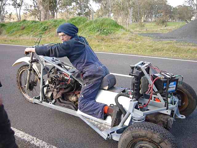

4k trike Posted February 24, 2010 Report Posted February 24, 2010 this is my little homebuilt trike it starts with a xt550 front end including steering homemade chassis conected to a complete datsun 180b independent rear end. Power is a 4k with 3spd auto i have mounted a sc12 blower on it (not piped yet-soon though) have an 1 3/4 su carby to fit drawthrough onto it i am going to make custon extractors to suit along with inlet manifold this trike is mainly for straight line sand dragging over 100 -130 meter distance more soon Quote
19914afc Posted February 24, 2010 Report Posted February 24, 2010 very out there machine, looks like it would tare the sand up pretty well. You need some wide wheels with sand tyres. Quote
7shades Posted February 24, 2010 Report Posted February 24, 2010 I whole-heartedly endorse this incredibly unsafe/awesome piece of redneck engineering. Quote
4k trike Posted February 24, 2010 Author Report Posted February 24, 2010 yeh got atv sandstar dune tyres shes hardly unsafe its longer wheelbase make it stable(ish) Quote
philbey Posted February 24, 2010 Report Posted February 24, 2010 So what your saying is the high-sides are less violent ahaha. Quote
beerhead Posted February 24, 2010 Report Posted February 24, 2010 Wow, I saw your username the other day, and was wondering if it was true! Now that's gotta make use of a 4K power to weight wise. Does it wheelstand? Quote
ae95- wagon kid Posted February 24, 2010 Report Posted February 24, 2010 that is cool imagine the noise with a straight thro exhaust Quote
bLinded_ Posted February 24, 2010 Report Posted February 24, 2010 Most badass thing I have seen. You sir are a madman for having the balls to even try ride that! Â Â Good work though :happy: Quote
Toy-Yoda[RL] Posted February 24, 2010 Report Posted February 24, 2010 Oh epic, APPROVED Â Running short gearing then? or are you not making use of all 3 gears? Quote
4k trike Posted February 24, 2010 Author Report Posted February 24, 2010 running 3.71 diff ive heard a 720 datsun frount diff will fit 180b housing (4.87) ratio doing 3-4000 inthird over125 meters no wheel stands yet but havent got blower going its weighing in at about 455kg with me on it Quote

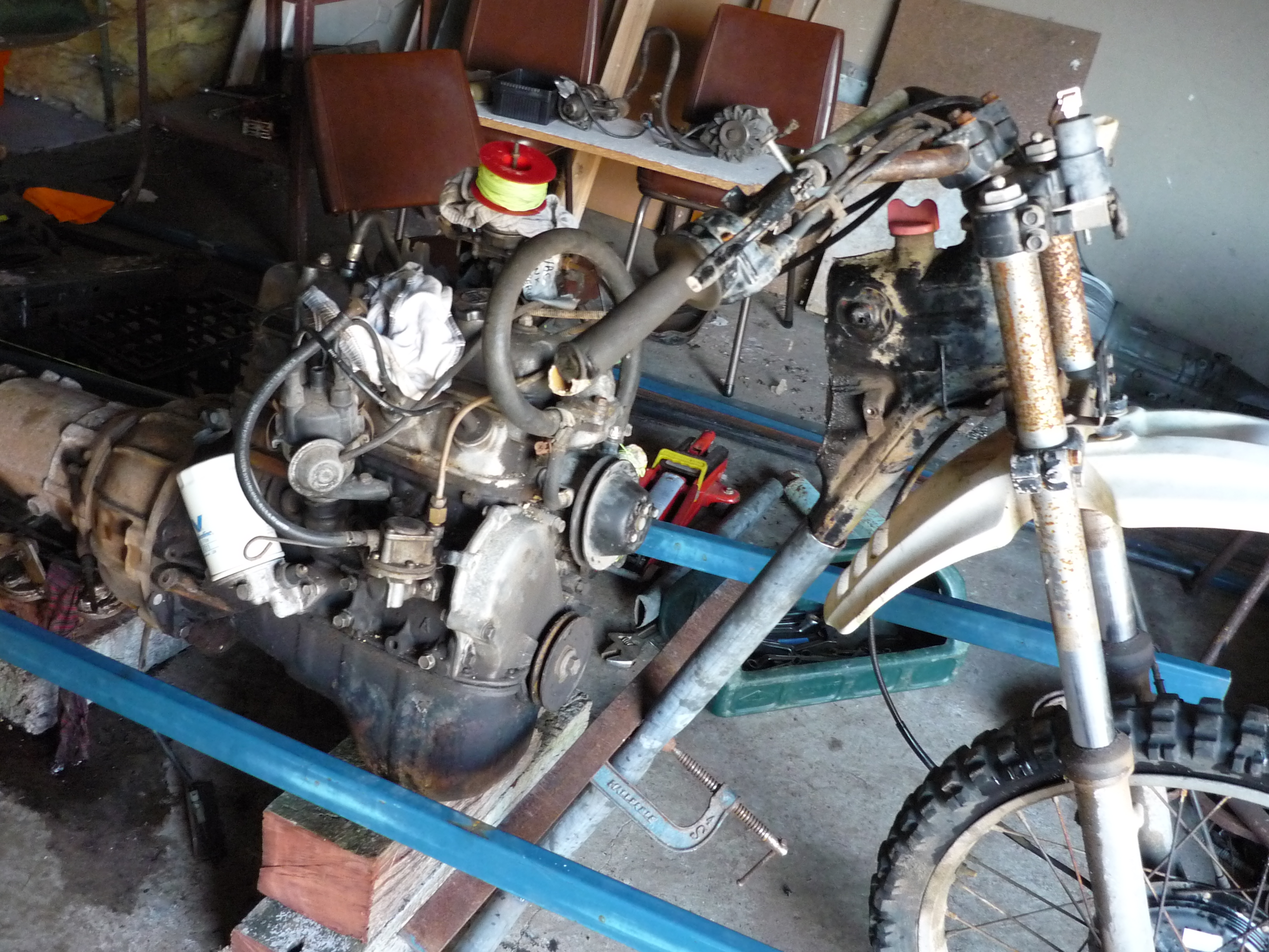

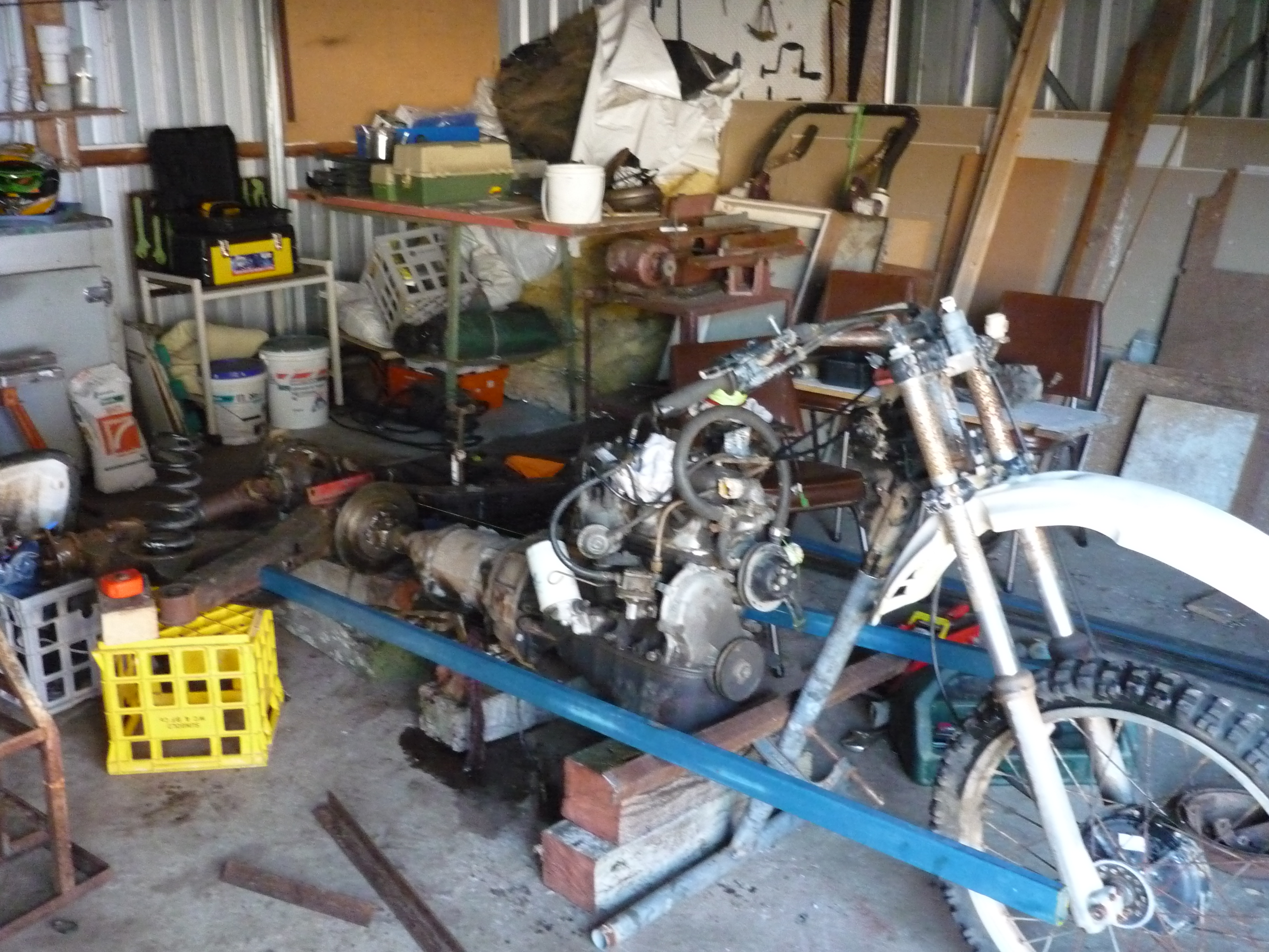

4k trike Posted February 24, 2010 Author Report Posted February 24, 2010 heres afew early build photos Quote

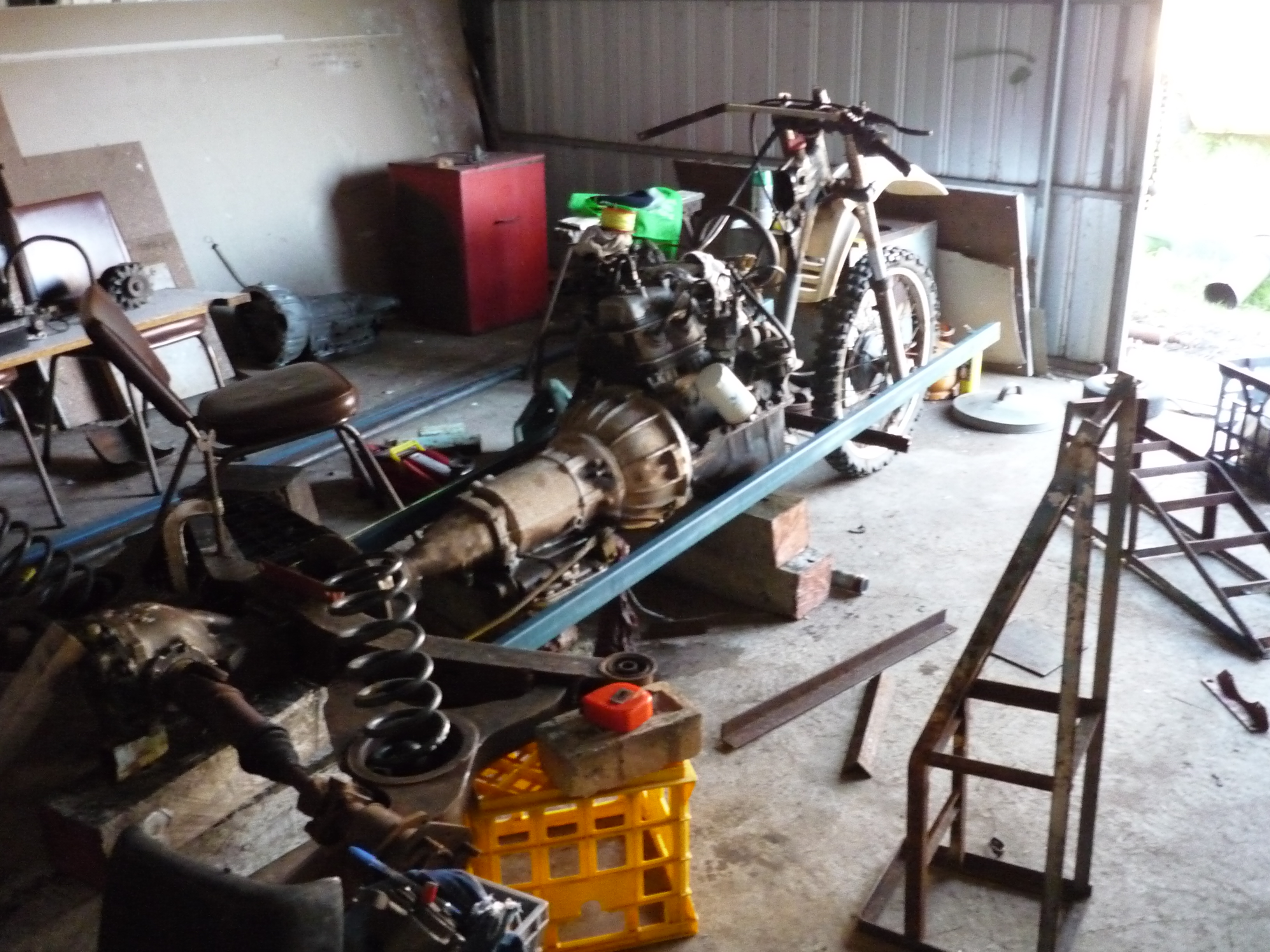

4k trike Posted February 24, 2010 Author Report Posted February 24, 2010 (edited) photos 1 2 diff motor trans and front end all getting lined up photo 3 the cheif engineer/welder/tech adviser couldent have done it without him Edited February 24, 2010 by 4k trike Quote
