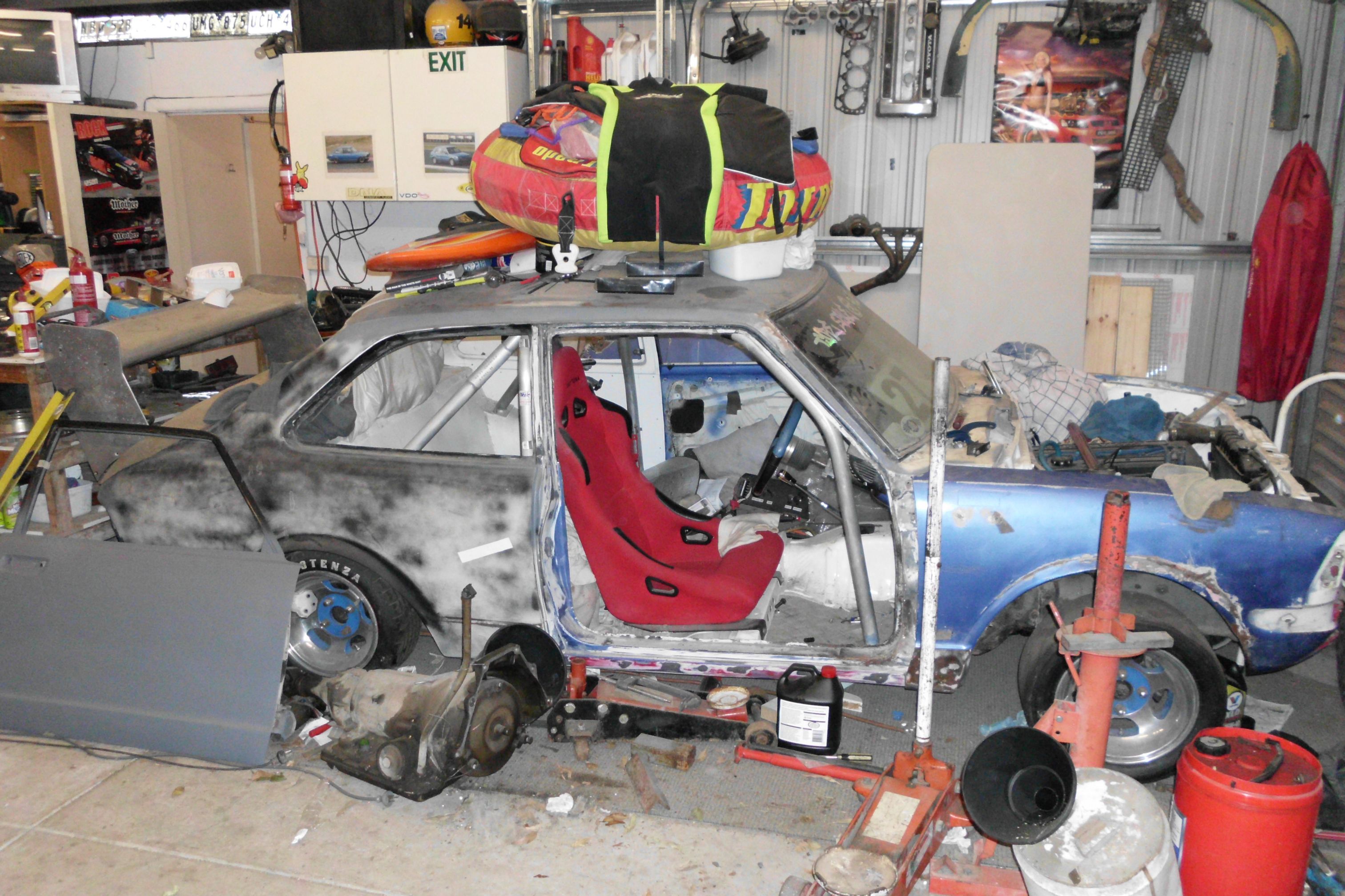

Hi guys, been a while. I have new motovation. Last weekend I did a V8 Racecar drive day at Sandown (a Christmas preasent from my kids) and I relised that I haven't lost the bug. My poor old racer has been sitting there for the last six months and the only time some one goes near it is to stack some more shit on the roof. Time to get back onto it. I'm not getting any younger.
I went out to the shed and got a major supprise. My ars still fits into the race seat. It felt good to sit in it again. I turned on the battery isolater and then the ignition switch and to my supprise everything lit up. Next I hit the primary fuel pump switch and away it went. After 20 seconds to fill the swirl pot I hit the main fuelpump switch and the big Holley Blue wirred into life. Fuel pressure up to 5psi, a few pumps on the throttal, and hit the starter button. ...............Away she went. Now I'm realy pumped.
Where too from here. There is so much I have to do and I want it back on the track by August this year for her 41st birthday. The weak link in the car is the diff. It still runs the Corolla Borgy diff and although I have never broken an axel, I have done one centre. I am going to use a Skyline (R31) diff but that would mean that the rear brakes would be bigger than the fronts. My wife suggested I start from the front and work back, so thats what I am going to do.

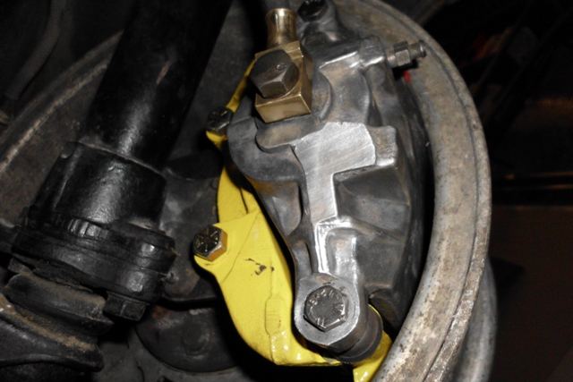

Hi Guys, back again. Well I got some VH Commodore calipers from the wreckers. They are the same size and offset as all commodore's from VB to VN so you could use any of these. There are a few different brands, Girlock, PBR etc. I have gone for the Girlock because they are a bit lighter.
These are the new mounting brackets for the calipers. I hope you can follow the diagram. Ifyou need any more info just ask me.
Start by removing the old calipers. The old Sumitomo's were fine for Hillclimb's (a one lap dash) but when you start doing a few laps at Phillip Island or Sandown, you soon want more. I think the mounting for the drum brakes is the same so you could use this upgrade for drum brake cars aswell. {If some one could confirm that it would be good.} Remove the old brackets and bolt on the new ones.

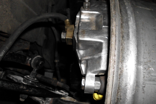

Now to bolt on the new caliper and see if I can get the 13' wheel on.
Better try both sets incase they are slightly different
All Good. There is about 5mm to 6mm clearance at the closest point, between caliper and wheel and a good preportion of the caliper is out of the wheel and in the air streem so will be good for cooling.
I got an old magna disc from the wreckers for $5.00 that I am going to use as a dummy, and if it all fits up ok, I will buy a set of new one's to use. The old disc diameter was 216mm and the new one's are 266mm so it should do the job.
