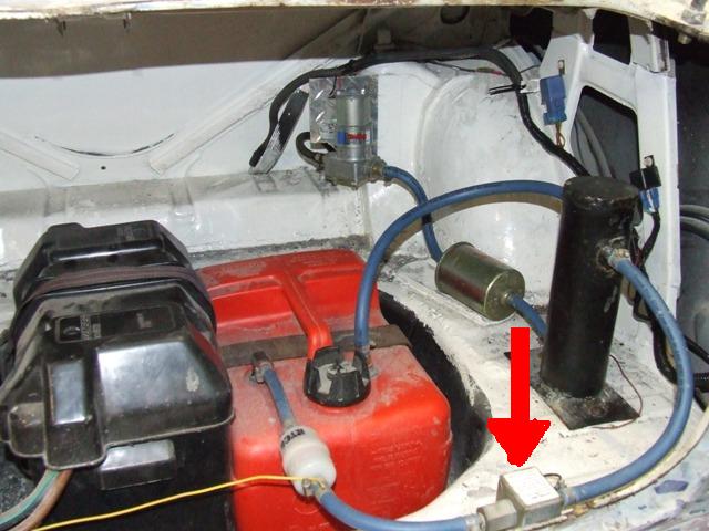

coln72 Posted March 16, 2010 Report Posted March 16, 2010 ausca62 said: A quick question for any one reading this. Because I am using a 2tgeu block there is no provision for a mechanical fuel pump. There for I have fitted a Holley Blue electric pump and a Holley regulator. My question is, what pressure to run the fuel for Webers. I am thinking about 4 to 5 psi. Thanks. Paul Are you running a lifter pump to feed the Holley???? I had issues with a Holley Red not self priming when I tried one out. Once it got a bit of air in the line between the tank and the pump the car would stop :lolcry: Was embarissing sitting on the side of the road, pulling a fuel line and sucking the fuel through >| Tossed the Holley and fitted a little "Facet" pump and all issues went away except for the noise the "Facet" made. Took some time to sorta fix that one. Quote

ausca62 Posted March 17, 2010 Author Report Posted March 17, 2010 coln72 said: Are you running a lifter pump to feed the Holley???? I had issues with a Holley Red not self priming when I tried one out. Once it got a bit of air in the line between the tank and the pump the car would stop :D Was embarissing sitting on the side of the road, pulling a fuel line and sucking the fuel through :wub: Tossed the Holley and fitted a little "Facet" pump and all issues went away except for the noise the "Facet" made. Took some time to sorta fix that one. yeah mate, had a simmilar problem years ago with a 55 Cheve. (Bloody embarassing) I have a small pump to lift from the tank and fill a small swirl pot. The holley then picks up fuel from there. As the fuel level is always higher than the pump, I think I should be OK. Cheers, Paul. Quote
philbey Posted March 17, 2010 Report Posted March 17, 2010 12psi on a holley regulator? I've got exactly the same unit and it's got no problems keeping it down to 4psi for my dellortos. Other than that, I dig this thing. Good work, keep the pics coming. Quote

ausca62 Posted March 17, 2010 Author Report Posted March 17, 2010 philbey said: 12psi on a holley regulator? I've got exactly the same unit and it's got no problems keeping it down to 4psi for my dellortos. Other than that, I dig this thing. Good work, keep the pics coming. Hi Philbey, I have since found out that there are 2 Holley regs. 1 goes from 1-4 psi and the other from 4.5-10 psi The latter being used on 4brl carbies like Holleys etc. They run on 8 psi, where as Webers, SU's and the like run on about 4 psi. This one was off a 55 Cheve running a small block and holley, so there is my problem. Thanks for the input. Cheers Paul. Quote

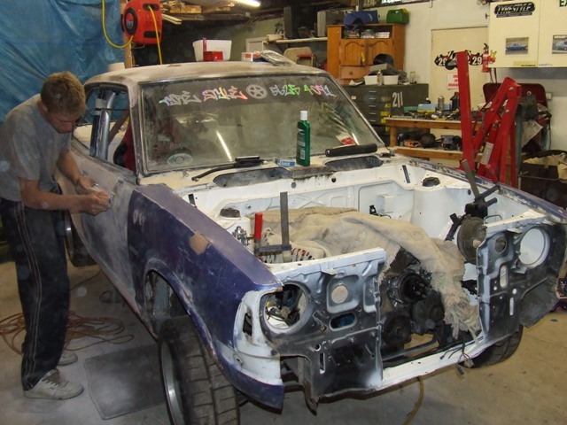

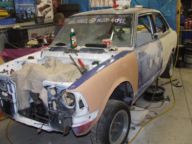

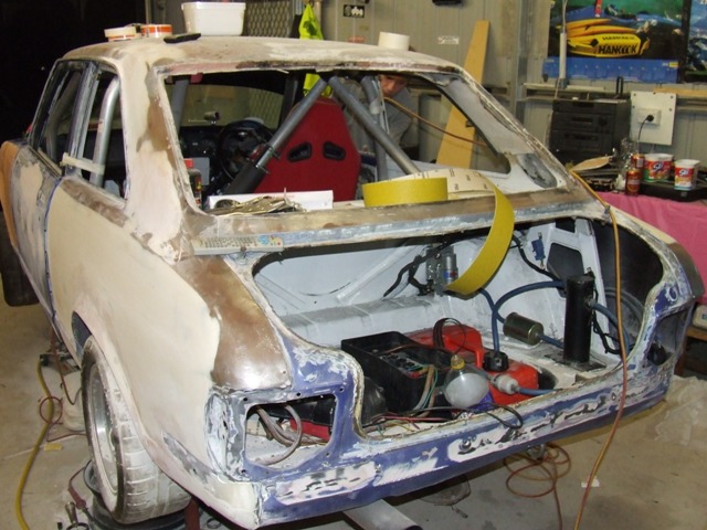

ausca62 Posted March 23, 2010 Author Report Posted March 23, 2010 Just a few picks to show that it hasent come to a complete standstill. The body work is coming on slowly. And the motor is nearly ready for a fire up. Quote

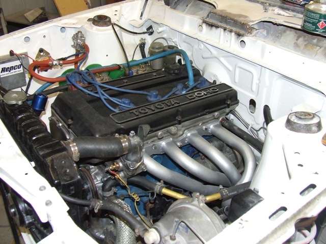

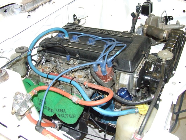

ausca62 Posted April 5, 2010 Author Report Posted April 5, 2010 WOOOHOOO The motor is finnaly running. I couldn't believe it. I wound it over with the spark plugs out untill the oil pressure came up, put the plugs in, hit the starter button and away it went. Instant! Carbies not set, dizzy only a guess, and after about 1 min it would even sort of idle. Big camms so idle is very rough but it still idles. :blush: Just to pick the brains of the 2tg boys, I went to Repco and was told they do not make spark plugs for 2tg's. Acording to my manual, 2t run NGK BP5ES and 2tg run NGK BP5EZ. they only had the (ES). What is the difference and will it matter. If anybody runs a different plug, let me know. Thanks Paul Quote
silverra23 Posted April 5, 2010 Report Posted April 5, 2010 I ran BP6ES in mine, with a 1.0mm gap, after it was dyno tuned. That was their recommendation based on the dyno info. Quote

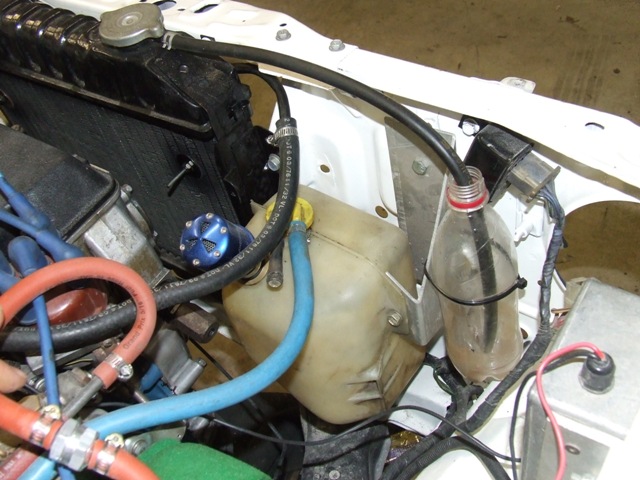

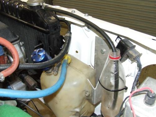

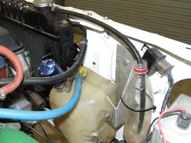

Taz_Rx Posted April 6, 2010 Report Posted April 6, 2010 Um..... why do you have an oil breather plugged into your radiator overflow bottle. I understand having "waste fluid" going into one bottle (a mate had a race car like this) but it didn't let the radiator suck water back up if it needed to. If yours does its just going to get oily water! :blush: Quote
ausca62 Posted April 8, 2010 Author Report Posted April 8, 2010 silverra23 said: I ran BP6ES in mine, with a 1.0mm gap, after it was dyno tuned. That was their recommendation based on the dyno info. Thanks Adam, you are a wealth of knowledge as usual. Cheers Paul. Quote
silverra23 Posted April 8, 2010 Report Posted April 8, 2010 No dramas on the plug info. Taz_Rx said: Um..... why do you have an oil breather plugged into your radiator overflow bottle. I understand having "waste fluid" going into one bottle (a mate had a race car like this) but it didn't let the radiator suck water back up if it needed to. If yours does its just going to get oily water! :( I reckon if you have another look Taz you will see the coolant is going into ye olde Coke bottle overflow, not the oil overflow :) Quote
ausca62 Posted April 8, 2010 Author Report Posted April 8, 2010 Taz_Rx said: Um..... why do you have an oil breather plugged into your radiator overflow bottle. I understand having "waste fluid" going into one bottle (a mate had a race car like this) but it didn't let the radiator suck water back up if it needed to. If yours does its just going to get oily water! :( Arrr mate, you crack me up. The radiator overflow bottle is actually my catch can. For cars under 2.0lt you need a 2 lt catch can and over 2.0lt need 3lts. Reasons why I used this. 1 very light weight, 2. a lot cheaper than one of those Fancy alloy ones, and it does the same job. For a radiator overflow I just use a 600ml Coke bottle. Cheap and light. Thanks for your comment. Cheers Paul. Quote
