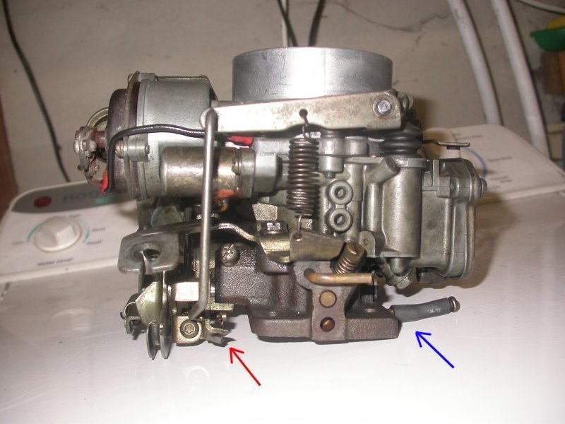

demuire Posted July 16, 2005 Report Posted July 16, 2005 I bolted on Haikals Nikki carb onto the wagon today, the carb is either off a Mazda 808 or a 1600, not sure. Anyway, everything bolted up alright, I even found a random bracket lying around in my pile of junk that I could use as a throttle cable bracket, the only cable that isn't really ideal is the choke, but it wasn't before anyway. The end of the sheath isn't clamped down, and I can't think of anyway to clamp it down. Anyway, after having some dramas trying to set the floats etc, everything seems to be good. Don't have an air filter yet (Autobarn sold me the wrong filter and then closed before I could return it, GAH), so put a piece of chux over the top and went for a drive. Part throttle, the car is okay, much the same as usual. Once it gets up the revs, or you try to go to full throttle, it seems to run too rich and it sputters... Is this the mixtures that is wrong? Or is it the jet sizes? I know nothing about carbs... There's a brass screw thing on one side that sticks out, with a spring on it. I would assume this is idle control? Turning it in or out doesn't seem to do much... Or is it a mixture control? I can't see any other obvious screws that I can muck around with... Quote
kangaroosa Posted July 16, 2005 Report Posted July 16, 2005 The idle adjustment screws normally contact the linkage itself. The idle mixture screw is normally around the base of the carby (not sure if i'm already telling you something you already know). Maybe you could refer to the pic in FAQ to determine which screw you are talking about.Nikki Carb Quote
demuire Posted July 16, 2005 Author Report Posted July 16, 2005 Haikals carb is a bit different to that one, but it is more or less the same as the brass one with the spring, in this photo: Quote
kangaroosa Posted July 16, 2005 Report Posted July 16, 2005 I would take punt and say, that is the idle mixture screw. This however wont solve your driveability problem. Quote
kangaroosa Posted July 16, 2005 Report Posted July 16, 2005 These extracts were taken from this page Tuning It actually for a weber/dellorto, but i assume the theories are the same. If the engine stumbles when you open the throttle, it could be a pump adjustment, but it could also mean a main jet change. Pay attention to STEADY throttle position when testing in these areas! It's easy to confuse the two. If the main jet doesn't solve it, try the pump. If it runs good at 3000-4000 rpms and stumbles elsewhere, your main is right and the problem is somewhere else. Try to do main jet testing from 1000 RPMs up to 4000 or so. This eliminates the accelerator pump issue from your testing! Spitting/sputtering/cracking is an indication of being too LEAN. Now, what RPMs that it's doing this tells you which jet you need to change! 2000 RPMs and lower, and you need to richen up your idle jet (go bigger). 2500-4000 RPMs and you need to richen up your main jet! We want as little accellerator pump squirt as possible to remove the stumble from the engine. Quote
demuire Posted July 16, 2005 Author Report Posted July 16, 2005 Hmm, interesting. I have no comprehension at all. But I'll try fiddling with it tomorrow and hopefully something will become better... Quote
