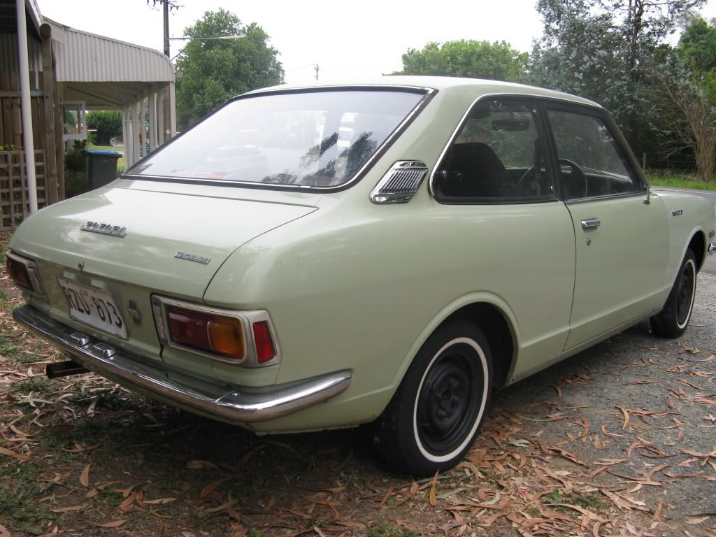

LukeAE71 Posted December 17, 2010 Author Report Posted December 17, 2010 Ok so not much been happening here of late. I decided I really need to get these 13 x 7 AP wheels on this car. Originally I wanted to do it with TE27 flares etc but to fill them properly I would probably need some rims that are more like 8" wide or run some stupid ass spacers :wink: . I reckon I can get these on with a slight roll and pull of the guards. Picked up a pair of T18 struts today and then I just need some AE86 P/S arms and a T3 spacer so I can fit them up to the front. This sorts the stud pattern for the front. Then I am either going to continue my hunt for a set of jap 30 axles or redrill the spare pair of axles I have here to 4 x 114.3 stud pattern. All I need then is to get some tyres for my AP's and lower it and then its WIN time :dance: Because I am super fussy it's still going to take a while as I will need new rotors, rebuild calipers, new springs, new leaf set and new wheel bearings. I don't ever do stuff by halves :cool: Quote

LukeAE71 Posted December 19, 2010 Author Report Posted December 19, 2010 On 12/19/2010 at 12:37 AM, greenmac80 said: planning to paint this beast?? Yeah I have to paint this car and soon.... the paint is getting really thin especially on the roof!! Just a matter of finding the time and money. Quote
