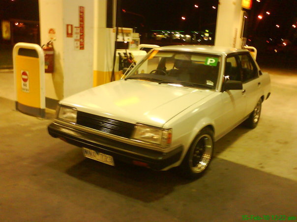

cableties Posted February 21, 2010 Report Posted February 21, 2010 SUP peoples.... I'm dave bought this bad boii like a month ago for 800 bucks.... so far... -decent tune -CIG locka -extra lock rod ends -removed egr system...soo gay lol -choppy rears -VS commodore super low non irs..(rear springs) in the front Plans for the future... -lol bin the 4ac....then 4agze -w50box -maybe a cut down r31 diff ....not sure as such lol total drift slut cheers folks. Quote
Tume Posted February 21, 2010 Report Posted February 21, 2010 Looks fair clean to me, don't destroy it with a drift slut. Just my opinion though. Meshies look awesome :) Quote
Dropz Posted February 21, 2010 Report Posted February 21, 2010 (edited) get a diff from an r31 wagon. it doesnt need to be cut down, and from memory its close to a bolt in. i like the meshies. kudos. cheap things for a drift slut. commy wagon rear shocks from 1978-92 wags fit. VE commy springs, rears from memory, also TJ magna springs, again i believe from rear. thatll stiffen it up massively. can try some corona LCAs for bit of track. or there are some sigma LCAs that fit, not sure what sigma though, putting out about 2degrees neg camber, with longer tie rod ends. you may need to hunt around a wreckers a bit, spend some time to see what fits. Edited February 21, 2010 by Dropz Quote
lilke70 Posted February 21, 2010 Report Posted February 21, 2010 (edited) just another "FULLY SICK DRIFTER BRO" its such a nice car the way it is don't destroy it Edited February 21, 2010 by lilke70 Quote
skd30 Posted February 21, 2010 Report Posted February 21, 2010 Dropz said: get a diff from an r31 wagon. it doesnt need to be cut down, and from memory its close to a bolt in. i like the meshies. kudos. cheap things for a drift slut. commy wagon rear shocks from 1978-92 wags fit. VE commy springs, rears from memory, also TJ magna springs, again i believe from rear. thatll stiffen it up massively. can try some corona LCAs for bit of track. or there are some sigma LCAs that fit, not sure what sigma though, putting out about 2degrees neg camber, with longer tie rod ends. you may need to hunt around a wreckers a bit, spend some time to see what fits. Drops do you know if there the commy shocks that also fit under the back end of ke30's? sorry if this is a the wrong place to ask. Anyway nice clean car you got there cableties and nice wheels to. I vote make it a drifter, but keep it clean like it is. if that works Quote
cableties Posted February 21, 2010 Author Report Posted February 21, 2010 haha...i totally love the "fully sik drifter bro" comment.... mate i own a clean wrx.. i only bought this car to drift in and atm get to work n back lol! but umm really you guys should of seen the state it was in when i originally bought it.... farrrk what a mess what you see there is post-paint love rolla.. btw... i had the meshies black center with silver lip befor and i got bored on saturday and i machined the face of them which one do you think looks bettera. ohhh and will post photos of the ae86 too...that's tufff... Quote
