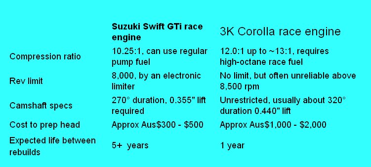

Felix Posted February 12, 2010 Report Posted February 12, 2010 (edited) I don't understand why anyone would waste so much money on a k series motor, unless it was of course a requirement for some racing class. Look at Billzillas pages and the comparison he made between motors for the Sports1300 class to make 135hp... LOL, the G13b is just a mild street motor. It is interesting to note that the same money/work put into the Suzuki motor would net approx 170-180hp at 10,000rpm. Edited February 12, 2010 by Felix
snot35 Posted February 12, 2010 Report Posted February 12, 2010 Couldn't agree more. These guys would be spending serious coin to get power that could be more easily had more cheaply with an engine swap. I think the only reasons to tune a K motor would be cost, to keep it period, or class restrictions.

Bamboo Posted February 12, 2010 Report Posted February 12, 2010 (edited) I don't understand why anyone would waste so much money on a k series motor, unless it was of course a requirement for some racing class. Look at Billzillas pages and the comparison he made between motors for the Sports1300 class to make 135hp... LOL, the G13b is just a mild street motor. It is interesting to note that the same money/work put into the Suzuki motor would net approx 170-180hp at 10,000rpm. The thing I like about the suzi engines is it's all alloy. Have all the horses in the world but weight is always a factor. I had a standard "well tuned" early civic which I drove off the clock. 160+ according to the speedo. I'd love to see a rolla with an alloy engine!!! I realise this goes against rolla love, but car companies that make bikes KNOW engines! Edited February 12, 2010 by Bamboo
