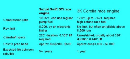

snot35 Posted February 10, 2010 Report Posted February 10, 2010 Not to mention it not being a twin cam. I believe the 150E got up around that on a 3K block, but we're talking a twin cam motor. I don't think 4K's breathe well enough for that, and even if they did, I'd be doubting the half counter balanced crank and valve train would be able to keep up. Have a read of billzilla.org. He used to race a bored 3K in his clubman and that had all the tricks. They were pushing about 130. 160 would have to be an optimistic dyno I reckon.
philbey Posted February 10, 2010 Report Posted February 10, 2010 Yeh all the race 3K's I've seen were about 130-140 at the flywheel. Like this mean little elfin
