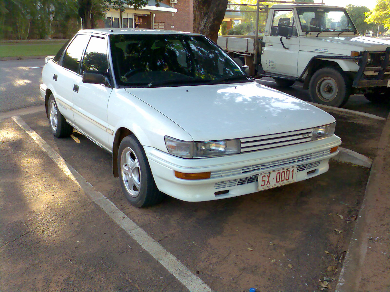

Well the tank is back in and the pump works great, the fuel guage doesnt work but ill enquire on a secondhand sender, a test light confirms power to it. Yeeh another 4AGE Seca SX going back onto the road!
