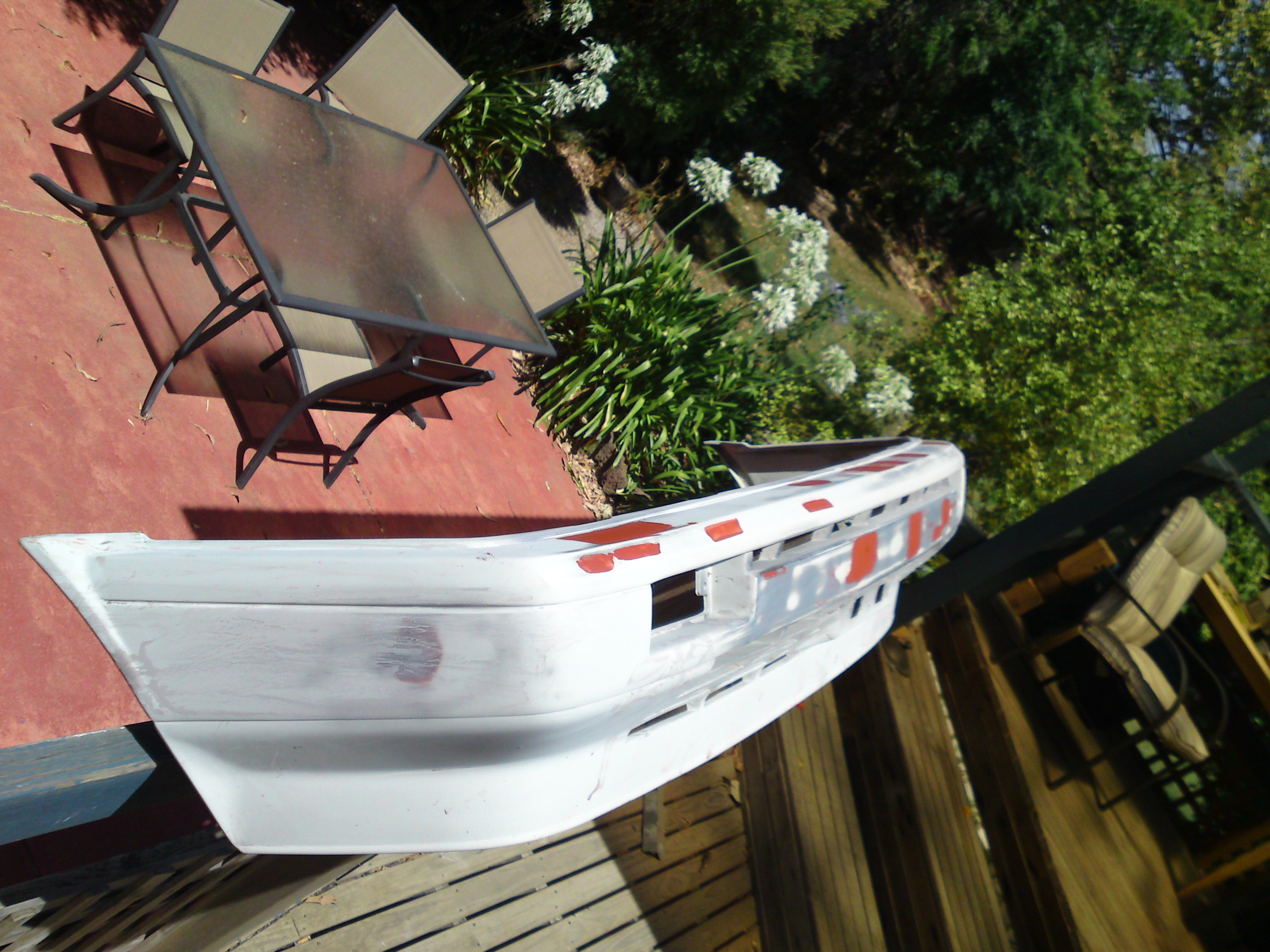

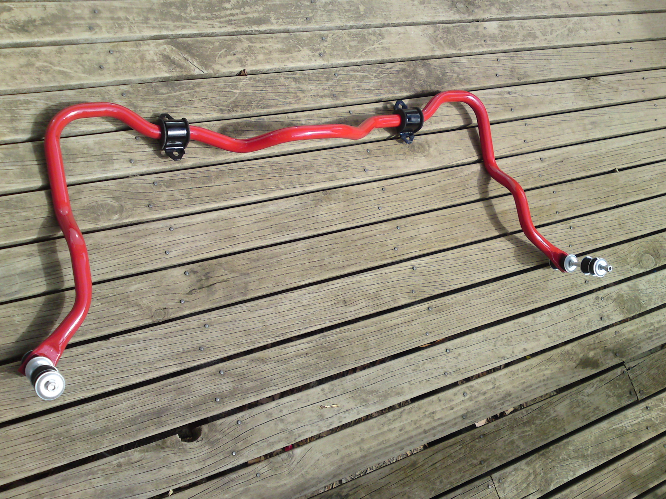

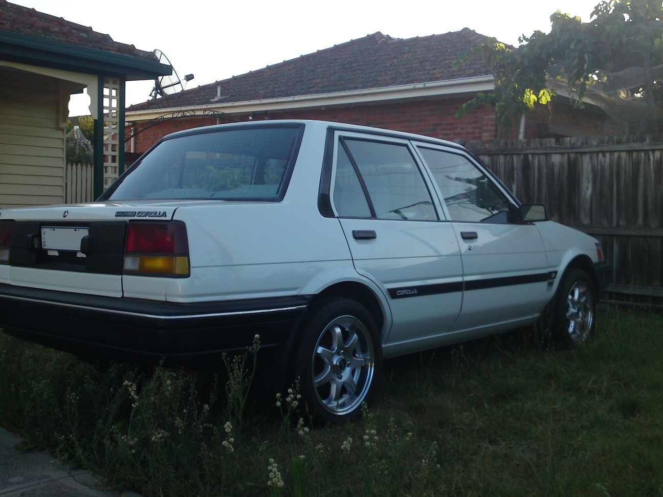

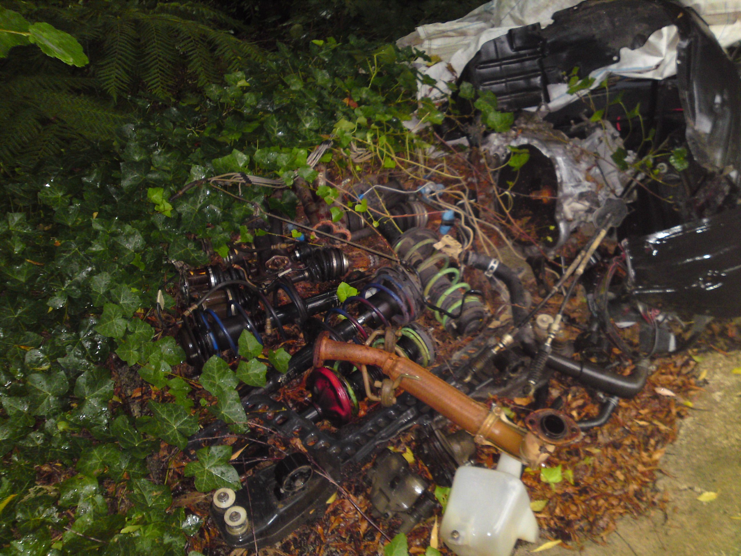

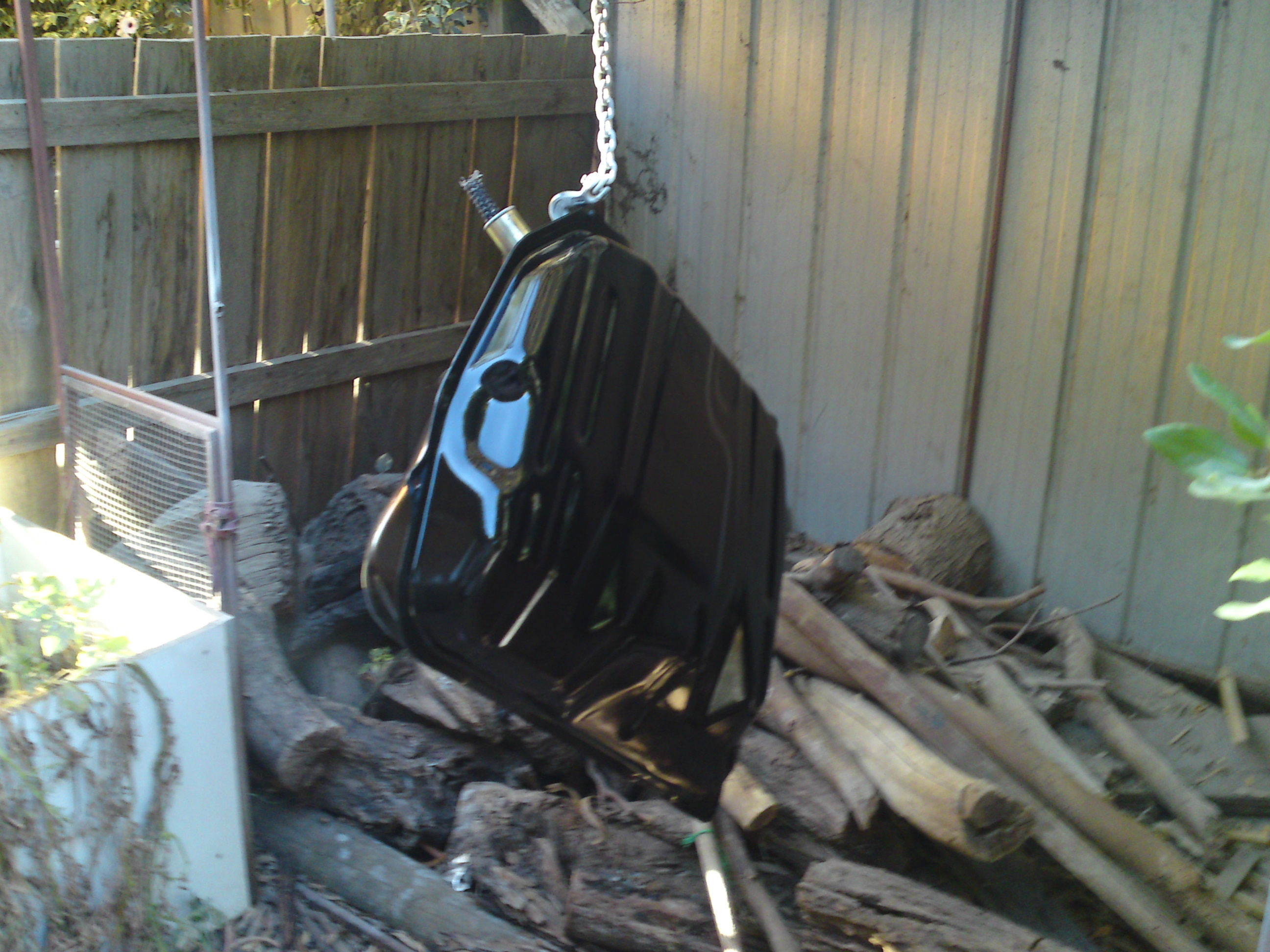

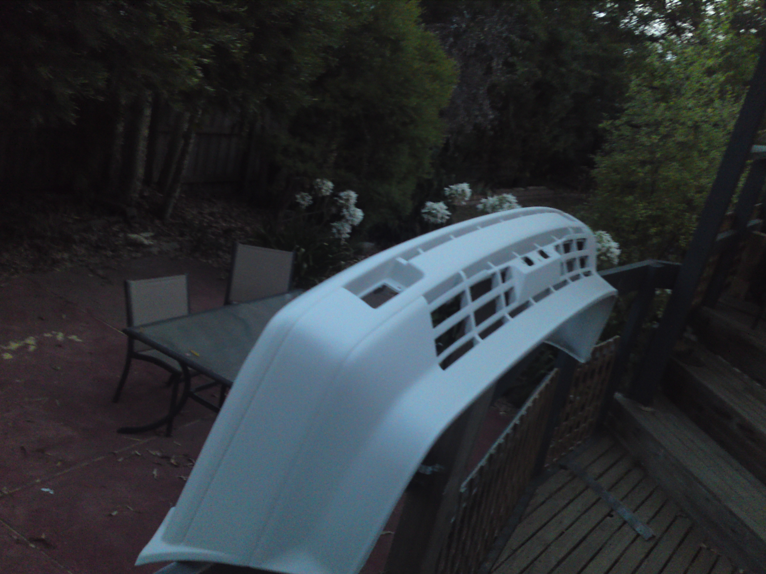

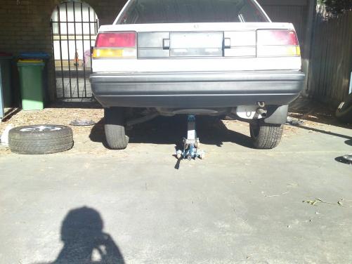

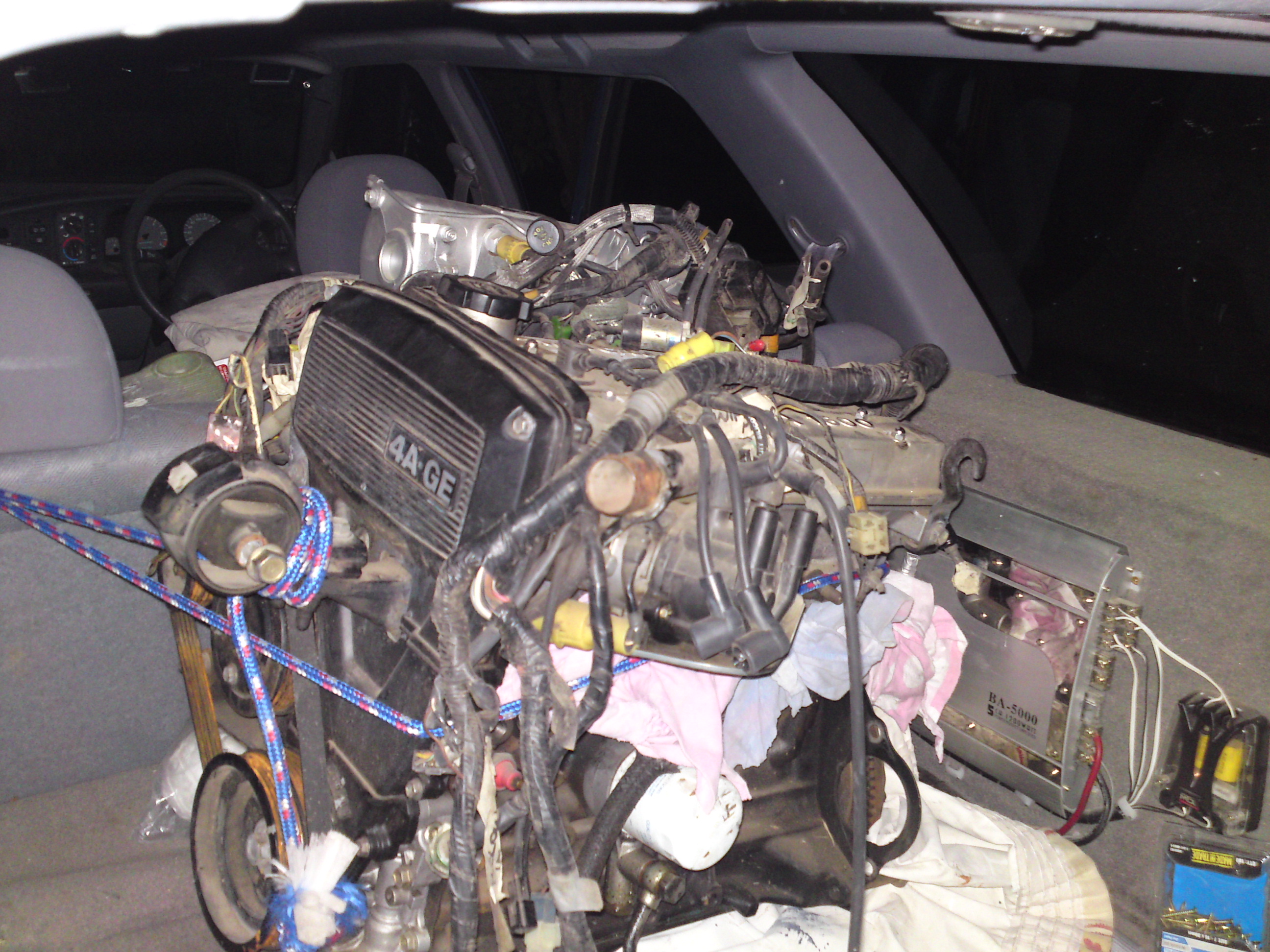

Johno Posted February 16, 2010 Author Report Posted February 16, 2010 Update, Getting things ready to install on the sedan. Engine is still at the mechanics. He had a problem trying to find a brand new water pump. I should have it back end of this week. I have painted, the new sway bar, EFI fuel tank, and extractors. Flushed out the old radiator from the seca and cleaned the outside ready for some new paint. Thinking of painting it silver. Put my mags on, got the Series 1 front bumper bar up to topcoat stage, pulled the 2" exhaust out of the seca (got it out in one piece with the cat :P ) Went to the wreckers to get a 4age exhaust bit but someone decided to cut the end off where it meets up with the cat with an angle grinder so it was useless to me :bash: Here is a pile of car bits that i abandoned at my mums place, weeds kinda took over Engine loaded in the boot of the ford ready to take to the mechanics Some things i been doing over the last few weeks Next thing to do is take the car to a mates house to.. Take 4ac motor out Put 4age motor in (Sounds easy but I'm sure it wont be) Change Front brakes to Ae94 rotors and calipers Put twinky disk brake setup on rear Install 2" sports exhaust Install Front Sway Bar Twinky fuel tank and lines All things above i have apart from twinky fuel lines and 4age exhaust elbow (the bit that's between the manifold and cat) I also have to get the O2 sensor mount welded into the elbow. I still have heaps to go but its looking good so far. :) Cheers, Johno :bash: Quote

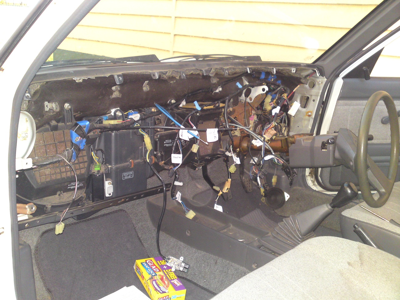

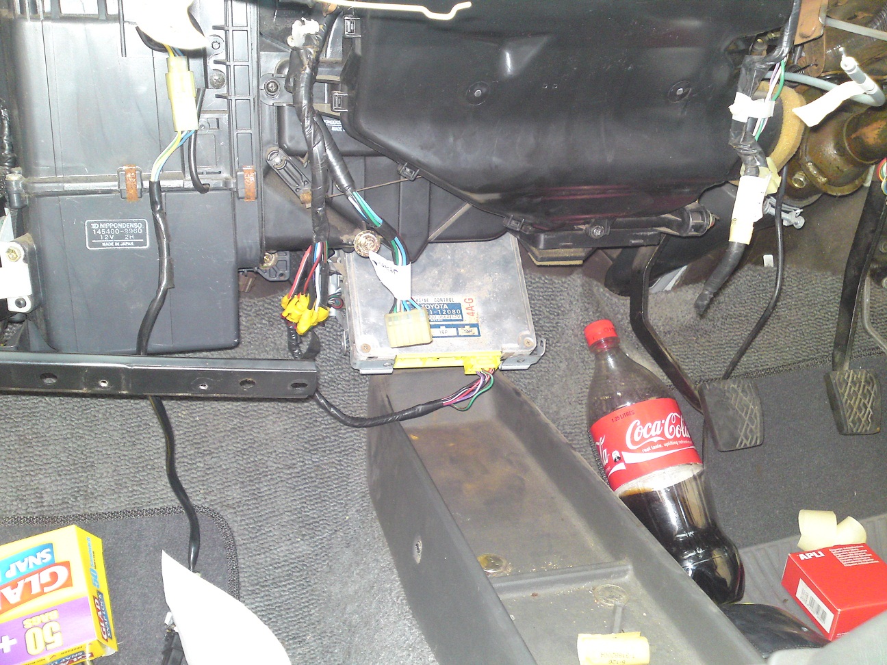

Johno Posted February 19, 2010 Author Report Posted February 19, 2010 (edited) A few more pics :y: Comparing tire width My Fav Pic :hmm: This is what i have been doing yesterday, I'm changing the old dash loom with a twinky ECU loom. Notice the glad zip bags on the floor? This time i have numbered everything and put in bags with what screws go where. Then i can work back through the numbers and hopefully get it all back together Edited February 19, 2010 by Johno Quote

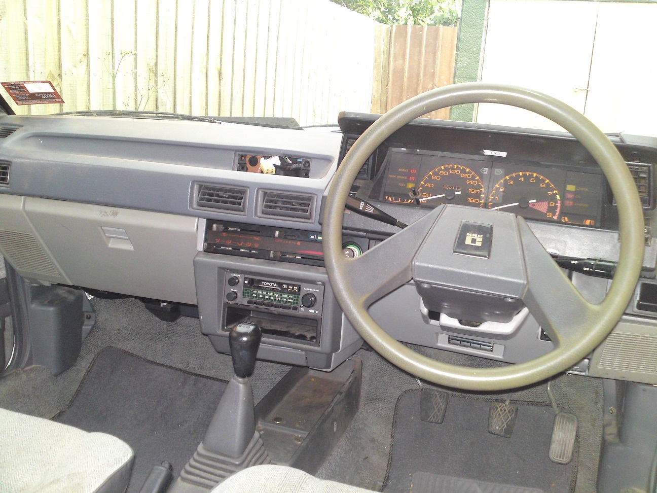

Johno Posted February 20, 2010 Author Report Posted February 20, 2010 Thanks Yuvi :y: Ok so I got the dash all back together, not one single screw left over (thats a first :hmm: ) ECU is bolted in, Twinky Dash cluster is in, loom fits. everything is ok i think apart from 3 little things 1. When I put the indicators on they blink real slow then stopped working altogether 2. I'm not sure if this is standard with twinky dash clusters or not but when i turn the ignition on the Tacho needle will very slightly rise up (showing about 50 RPM) is that normal? 3. 4ac engine wont start now, I'm not too concerned because its either from a flat battery but i would have thought the starter motor would have made some noise or the other reason is just because its a different loom but the 4ac plugs connect into it. Anyone got an answer to problem 2? Quote

Johno Posted February 20, 2010 Author Report Posted February 20, 2010 (edited) Here's the latest pics Had to solder the ECU Loom together because someone decided cutting is better than unclipping, same goes with alot of other parts i wanted from a twinky at the wreckers just like the fuel lines i had almost got out a few days before :hmm: Dash all back together with twinky goodness! :y: Edited February 20, 2010 by Johno Quote

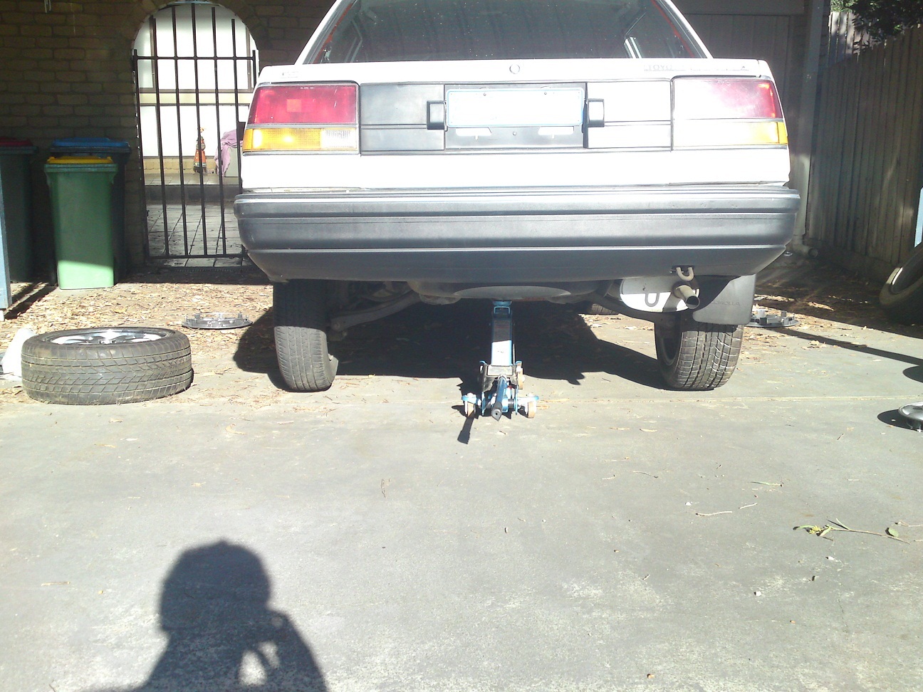

Johno Posted February 21, 2010 Author Report Posted February 21, 2010 Todays progress consisted of going to the local wreckers and grabbing some more twinky bits. Took me about 3 hours but i finally got the twinky fuel lines and exhaust flange ;) Exhaust was easy but the fuel lines... well it was a right c**t of a job to say the least. :) Had to remove the front sway bar, chassis bar, heater hoses, soot canister, air box, brake lines, fuel tank, back seat and after all that was out had to pull it through the wheel that was holding the car up. All without kinking the lines. I had brake fluid and petrol all down my arms and nuts and bolts jabbing me in the back the whole time. Quote
