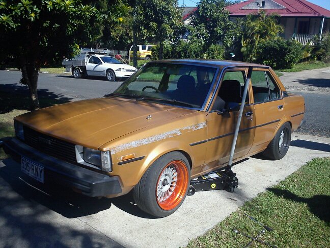

mungi mods Posted May 9, 2011 Author Report Posted May 9, 2011 (edited) so my 16 x 7 +20 SSR EX-C fins arrived today now all stripped centres are going off for powdercoating centre nuts have bad corrosion under the gold plate so they have been stripped and will be powdercoated as well i need to take my 15 x 9.5/10 barrels to my machinist to have 2 mm machined out of them so these centres fit perfectly should be on the car within 10 days hopefully 205/50/15or 205/55/15 tyres will be mounted unless i can find some 215/45/15 toyos somewhere, just need to test fit to judge the stretch then the rear guards will be cut off and new donor lips welded on , may weld them on an inch lower to give more "tuck" Edited May 9, 2011 by mungi mods Quote

mungi mods Posted May 10, 2011 Author Report Posted May 10, 2011 15 x 10 @ 0 SSR EX-C fins complete with centre garnish and nuts in the build Quote
