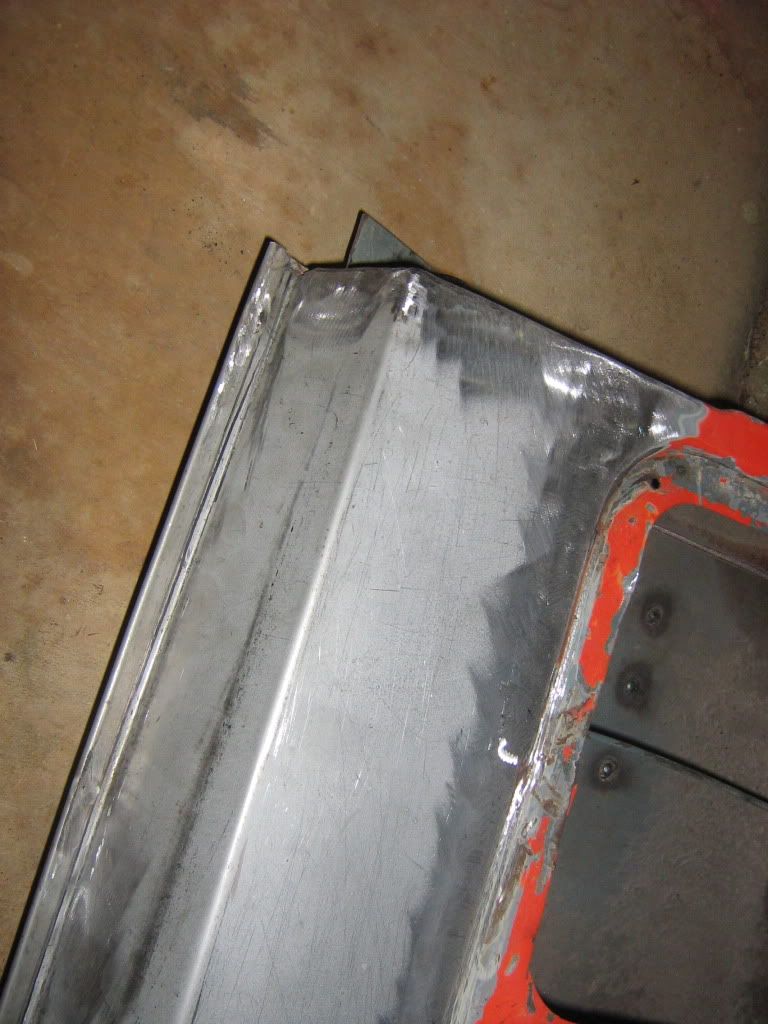

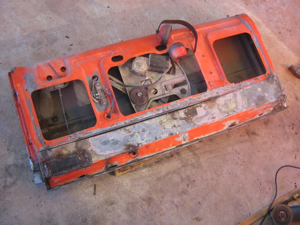

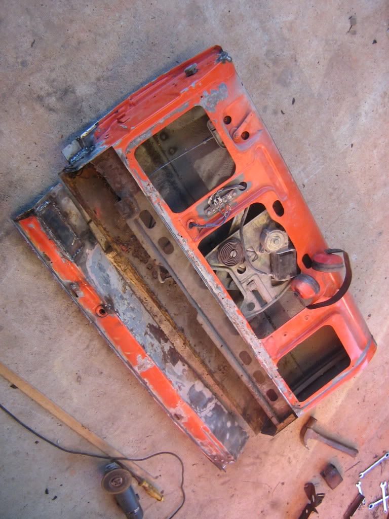

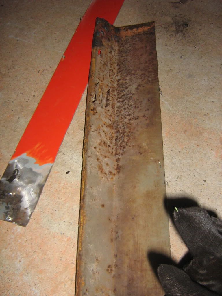

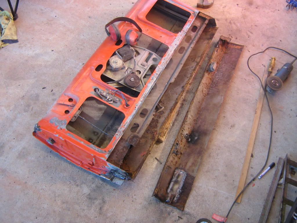

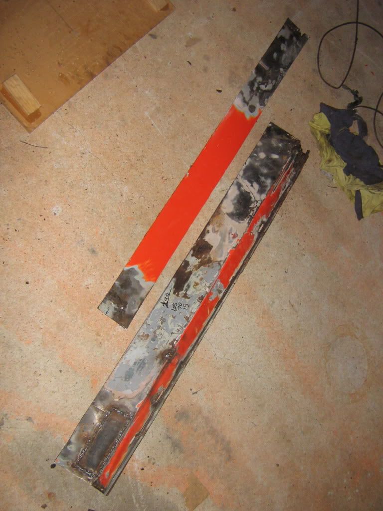

greenmac80 Posted August 5, 2010 Report Posted August 5, 2010 oh what a nissan feeling! said: i cut the bottom inner off first, then the outer. yep, it ugly looking went to the old mans shed, bent up some new bits, and welded them in... new, straight lower panel on the old tailgate, beats trying to straighten the old junk :dance: WTF??? dude i wish i had your skills here in adelaide i'll have to do this kinda shit to the boot lid of my ke10. my doors need it too but i don't have the access to the tooling nor the skills to rebuild the entire bottom section... Quote
Taz_Rx Posted August 6, 2010 Report Posted August 6, 2010 What I list!!! :dance: ....but if anybody can do it, you can mate. I admire the work you put into your cars! :fuzz: This might help RE bleeding the brakes..... Taz_Rx said: You need to keep bleeding them until this air noise stops. Might be work making yourself a "brake bong". Get an old 600ml drink bottle and 30cm or so of vacuum line (that will fit over the bleed nipple. Pore 50ml or so of brake fluid into the bottle (old fluid is fine) so that the vacuum line is under the level of fluid. Now bleed the brakes again with the bong attached to the bleed nipple. If air is coming out you'll see bubbles coming up through the fluid. Keep bleeding until the bubbles stop. Using a brake bong like this you can actually bleed brakes by yourself!! Fill the bottle with some new fluid and attach to the the LOSSENED bleed nipple. Then start pumping the pedal - when you pump it it wall push air/fluid out as per normal, then when you release the pedal fluid will be sucked back into the caliper from the bottle..... as long as the end of the vacuum line is under the fluid. :) :D Quote
oh what a nissan feeling! Posted August 7, 2010 Author Report Posted August 7, 2010 cheers! I am real lucky to have access to the equipment needed, the old man has a small business, I needed a fair bit of help from him to create the curved edge on one of the folders. I would have taken some pics of the process, but the camera went flat. did this one today 24. clutch pipe rubbing on firewall --- bought clips. also the tail gate has been etched, filled, and is now in undercoat. Quote
