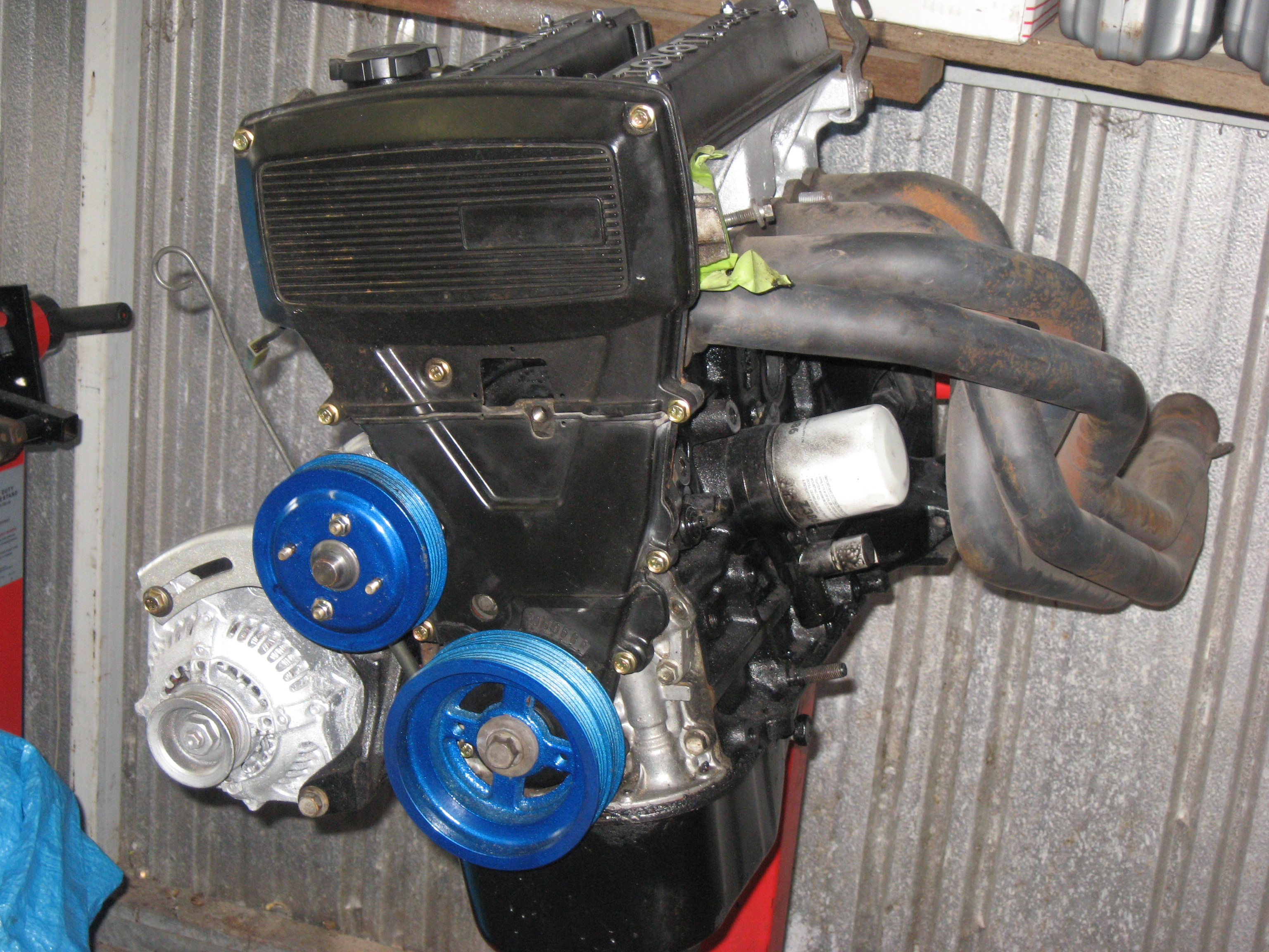

twisted2 Posted June 16, 2010 Author Report Posted June 16, 2010 well had some spare time today so strip the front of the 4age removed the front wheel drive mount replaced all front seals, new water, new tensioner,new timing belt and re assembled. put the redline mainfold on but have to take it off again need to modify it alittle so the tweak it injector plugs will fit Quote

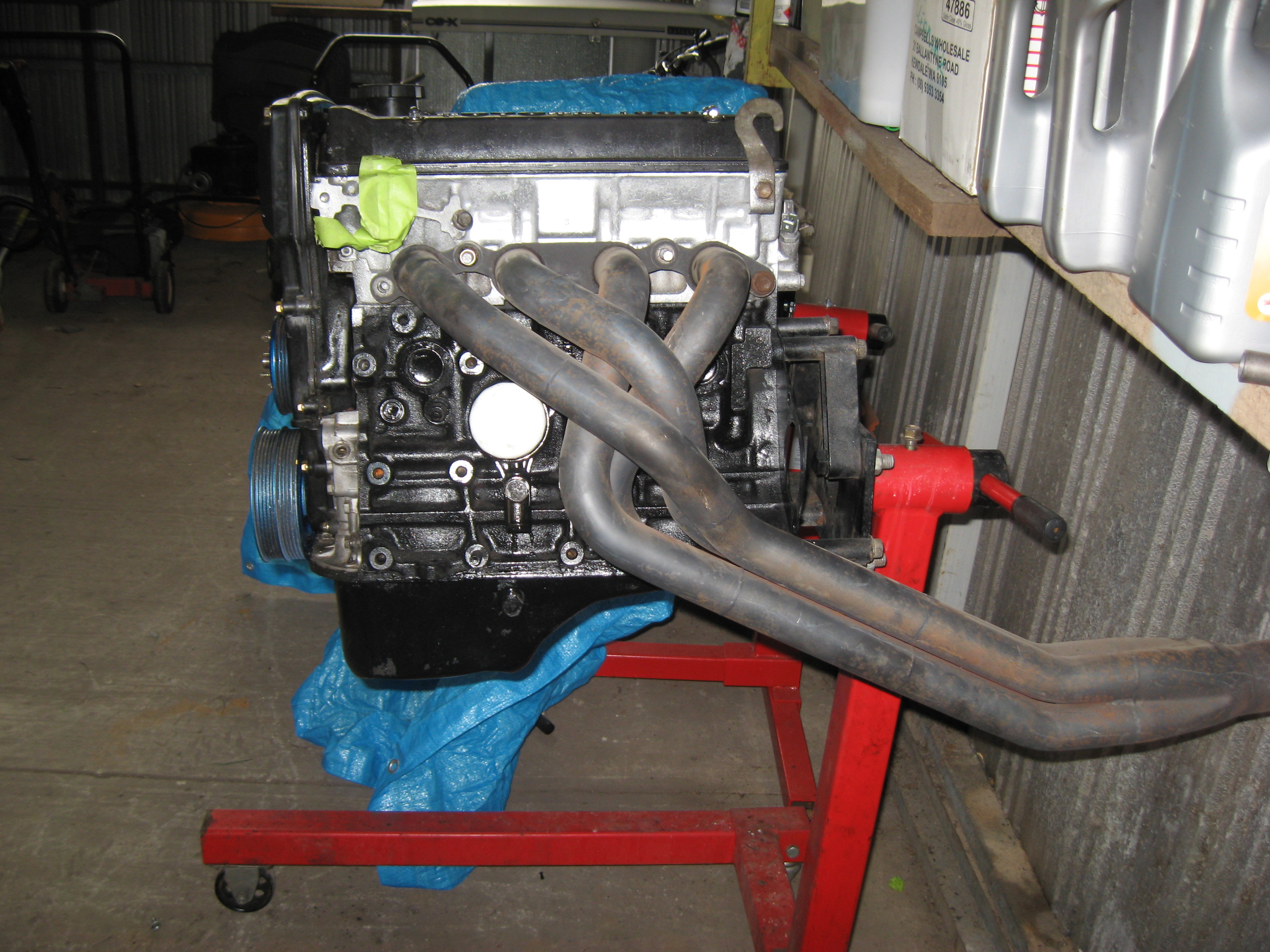

twisted2 Posted June 19, 2010 Author Report Posted June 19, 2010 well picked up my extractors today ;) next item to find is rwd waterpump pulley Quote
e70van Posted June 19, 2010 Report Posted June 19, 2010 wow they are long header pipes! looks cool ;) nice project, 4ag + carbs is nicee! Quote
imprezd Posted June 19, 2010 Report Posted June 19, 2010 Just gonna put a cat converter and cannon on the end of extractors and it will be sitting at the bumper lol Quote

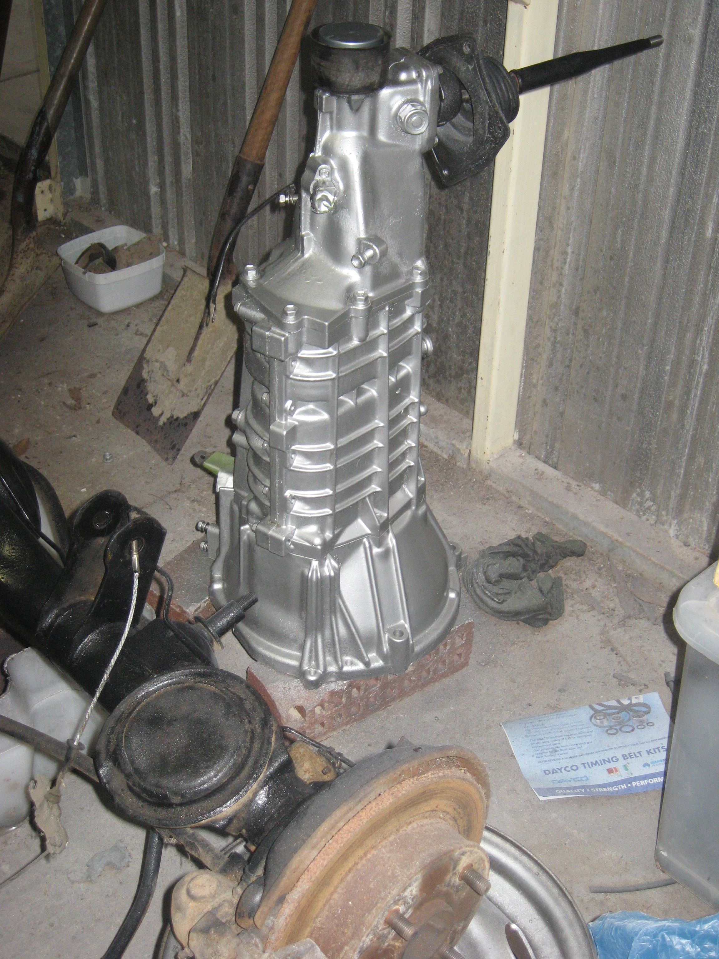

twisted2 Posted June 25, 2010 Author Report Posted June 25, 2010 had another parts find today scored jdm t50 bell housing so don't have to worry bout extractors cooking the clutch slave chylinder Quote

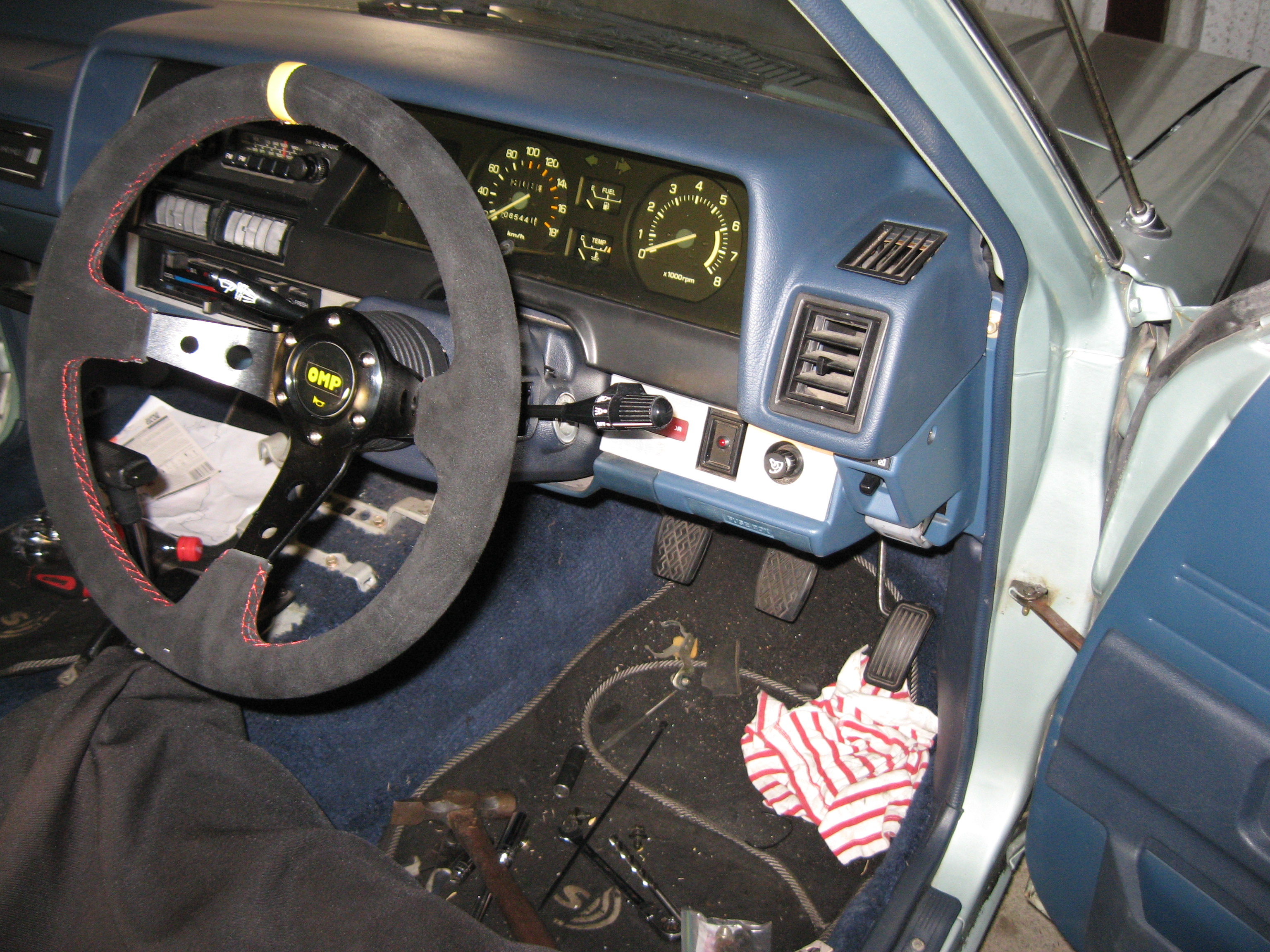

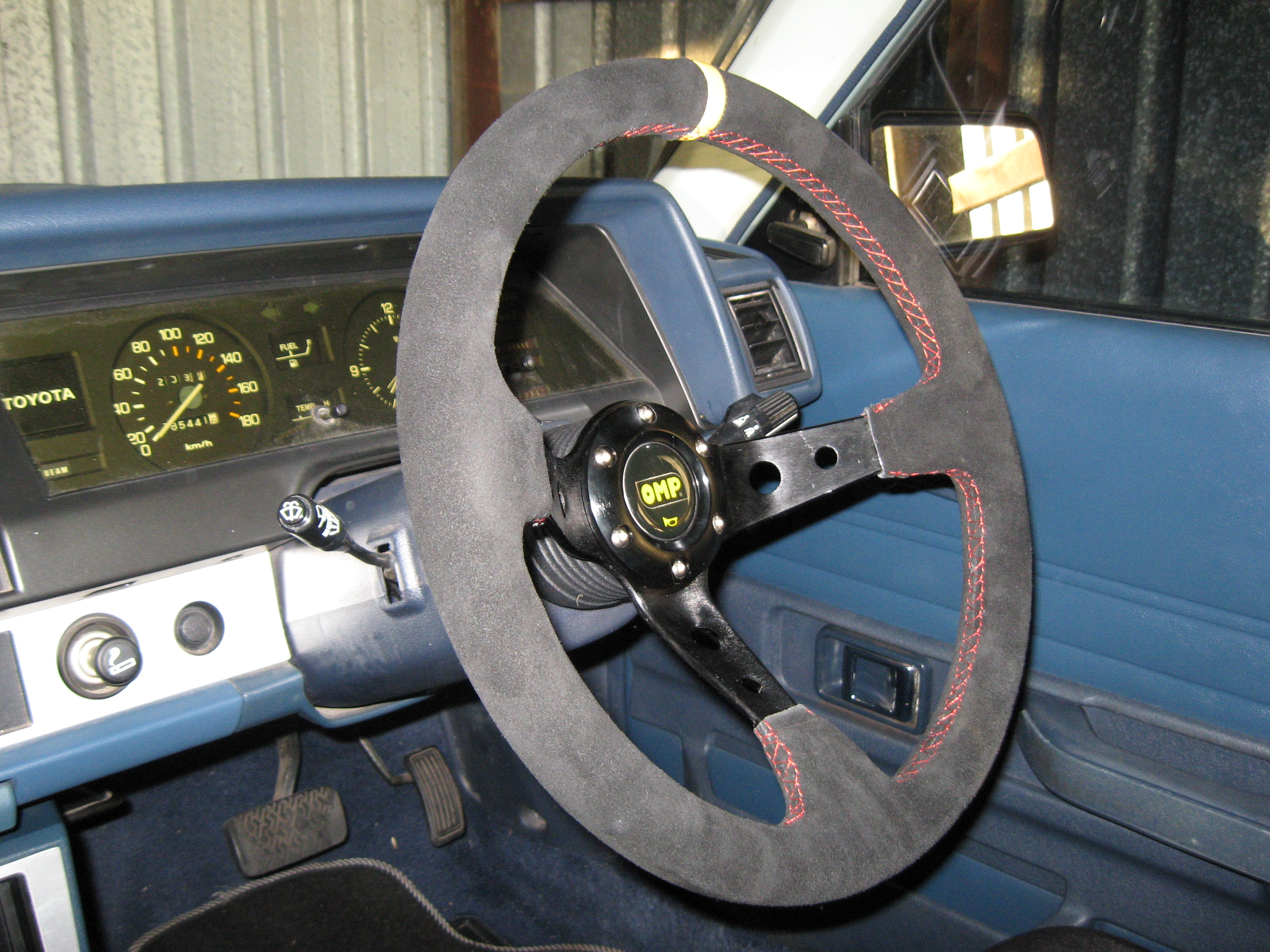

twisted2 Posted July 6, 2010 Author Report Posted July 6, 2010 well got my new steering wheel today :) also now have 4age rwd water pump pulley thanks to kronix Quote

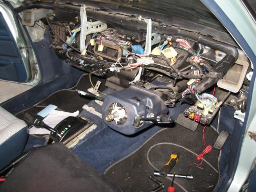

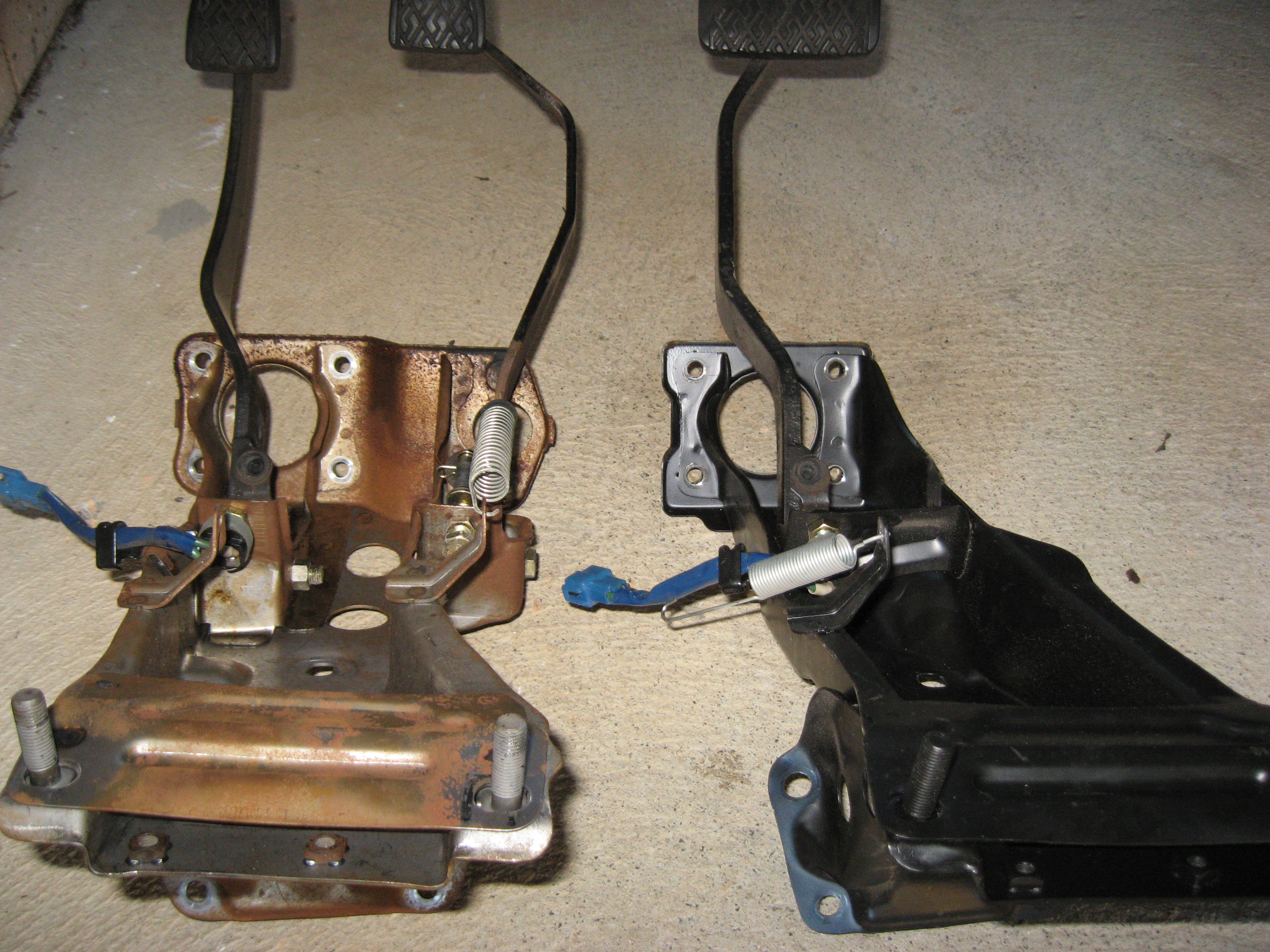

twisted2 Posted July 20, 2010 Author Report Posted July 20, 2010 had some more spare time today so decide to start manual conversion going to put manual in behind the 4ac due to 4age is still alittle while off and getting bored with the auto, so got the pedal box out today and cleaned up the gearbox Quote

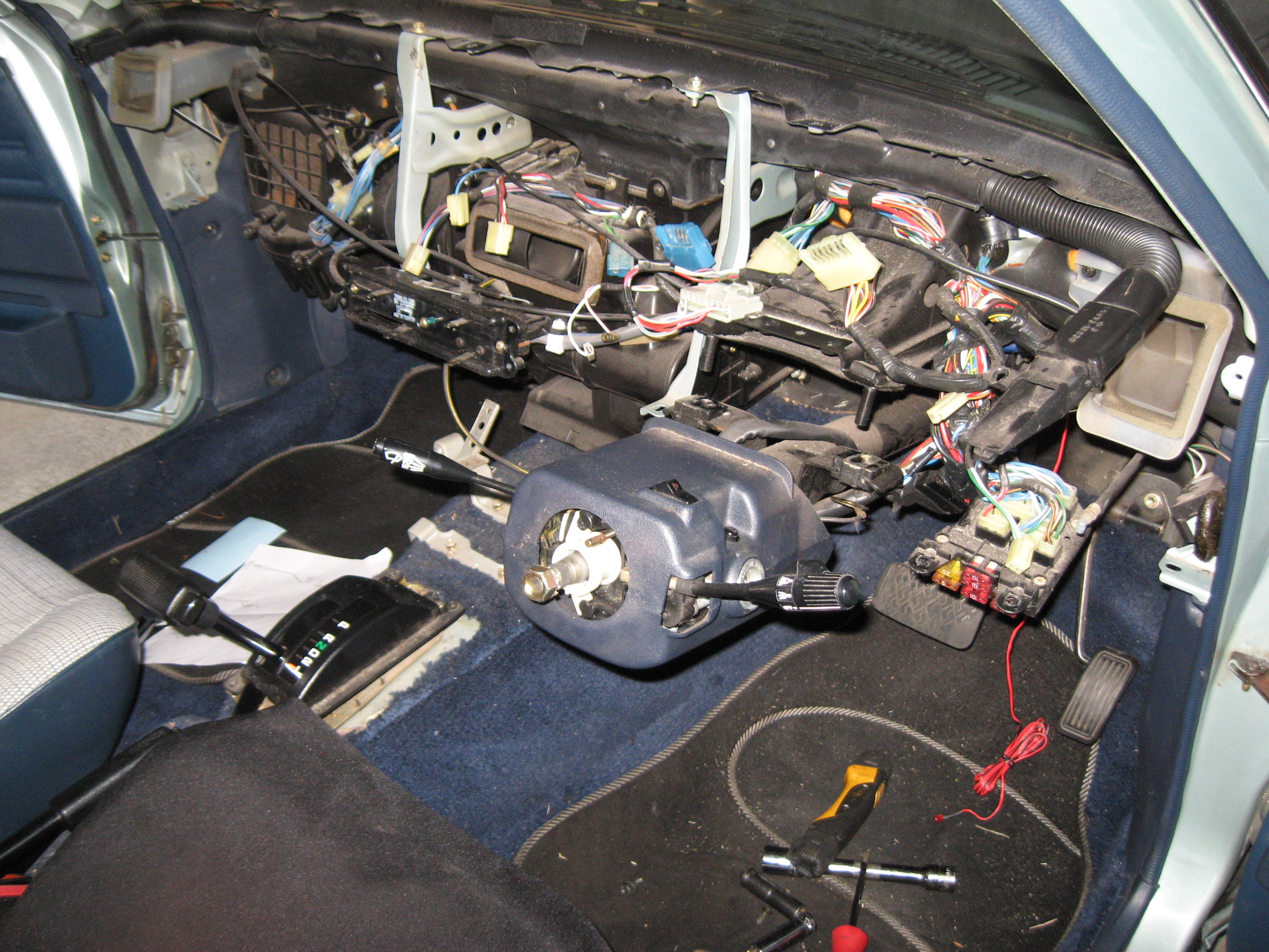

twisted2 Posted July 26, 2010 Author Report Posted July 26, 2010 (edited) got some more work done today pedal box, dash back in the car also put a tacho instrument cluster and clutch master chylinder mounted just need to get the auto out now and manual in. Edited July 26, 2010 by twisted2 Quote
