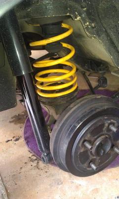

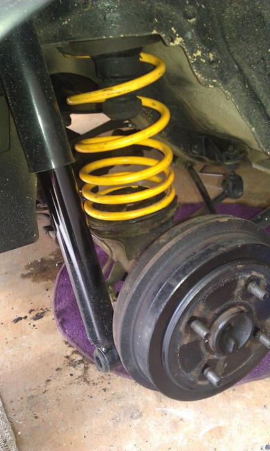

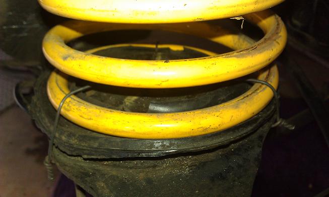

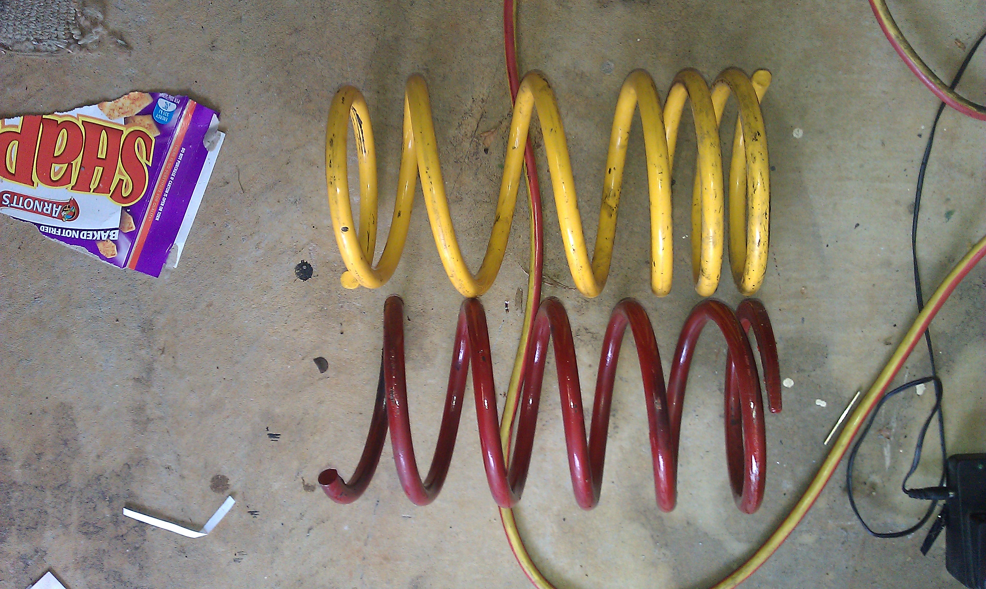

B.L.Z.BUB Posted March 6, 2011 Author Report Posted March 6, 2011 Celica ST front ultra lows. Fit in perfect(ish) and kept my ride height exactly the same. Just need to sort some shocks, hence the wire holding them in. Quote
19914afc Posted March 6, 2011 Report Posted March 6, 2011 82 camero shocks are shorter and available in 8 way adjustable if you need it. Otherwise the rear springs don't need to be captive only fronts or coilover type setup. Quote
B.L.Z.BUB Posted March 6, 2011 Author Report Posted March 6, 2011 I feel a lot safer with them at least wired in. Its rare them unseating but why risk it? Quote
Ella Posted March 6, 2011 Report Posted March 6, 2011 lol springs don't need to be captive??? youve obviously never had one fall out over a bump... Quote
