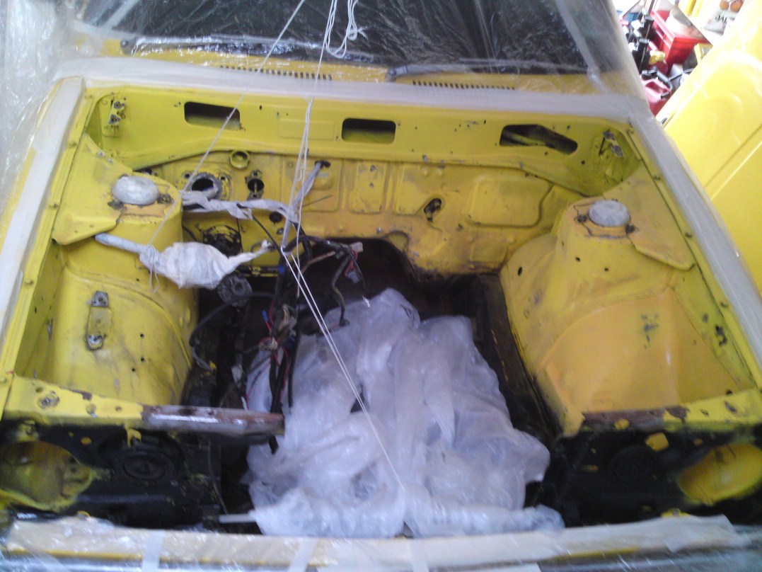

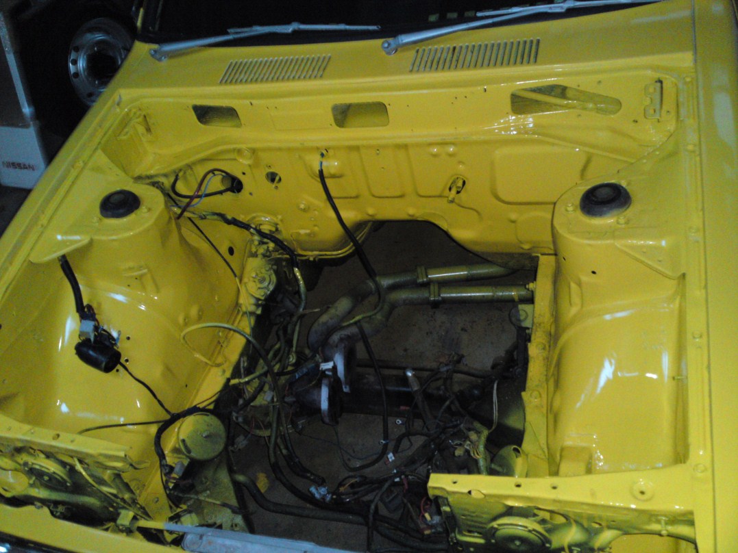

kangaroosa Posted June 30, 2010 Author Report Posted June 30, 2010 This was last weekends little effort. It was my first time spraying 2-pack, and was way to cold to be spraying, full stop. It was either that weekend or not at all, so I bit the bullet and did it. As expected the paint wasn't tacking off fast enough and I grew impatient, so I kept layering it on. Some areas eventually fried and theres a few runs, which arent even visible unless your really looking. Once the engine is back in and all the other related stuff, the runs will be hidden. All in all, i'm pretty happy with how it turned out considering. Its got some nice shine and its one colour, and it kinda matches the rest of the car. Before After Quote
Evan G Posted June 30, 2010 Report Posted June 30, 2010 looks better than you starter off with! looking good mate Quote
Raven Posted June 30, 2010 Report Posted June 30, 2010 If you heat the areas with a heat gun and then spray it, it works a treat :wink: Quote
kangaroosa Posted June 30, 2010 Author Report Posted June 30, 2010 Raven said: If you heat the areas with a heat gun and then spray it, it works a treat :laff: You obviously don't know how impatient I am. :wink: I thought about that, but it was about 10deg in my shed and I would have been there forever heating and painting. I thought about grabbing a jet heater from work, but i really coulnt be bothered. I just wanted it one colour... Its all hardened now and looks pretty schmik. Quote
greenmac80 Posted June 30, 2010 Report Posted June 30, 2010 jst for further thought if your spraying and its cold you can by an accelerator which makes the paint dry faster Quote
