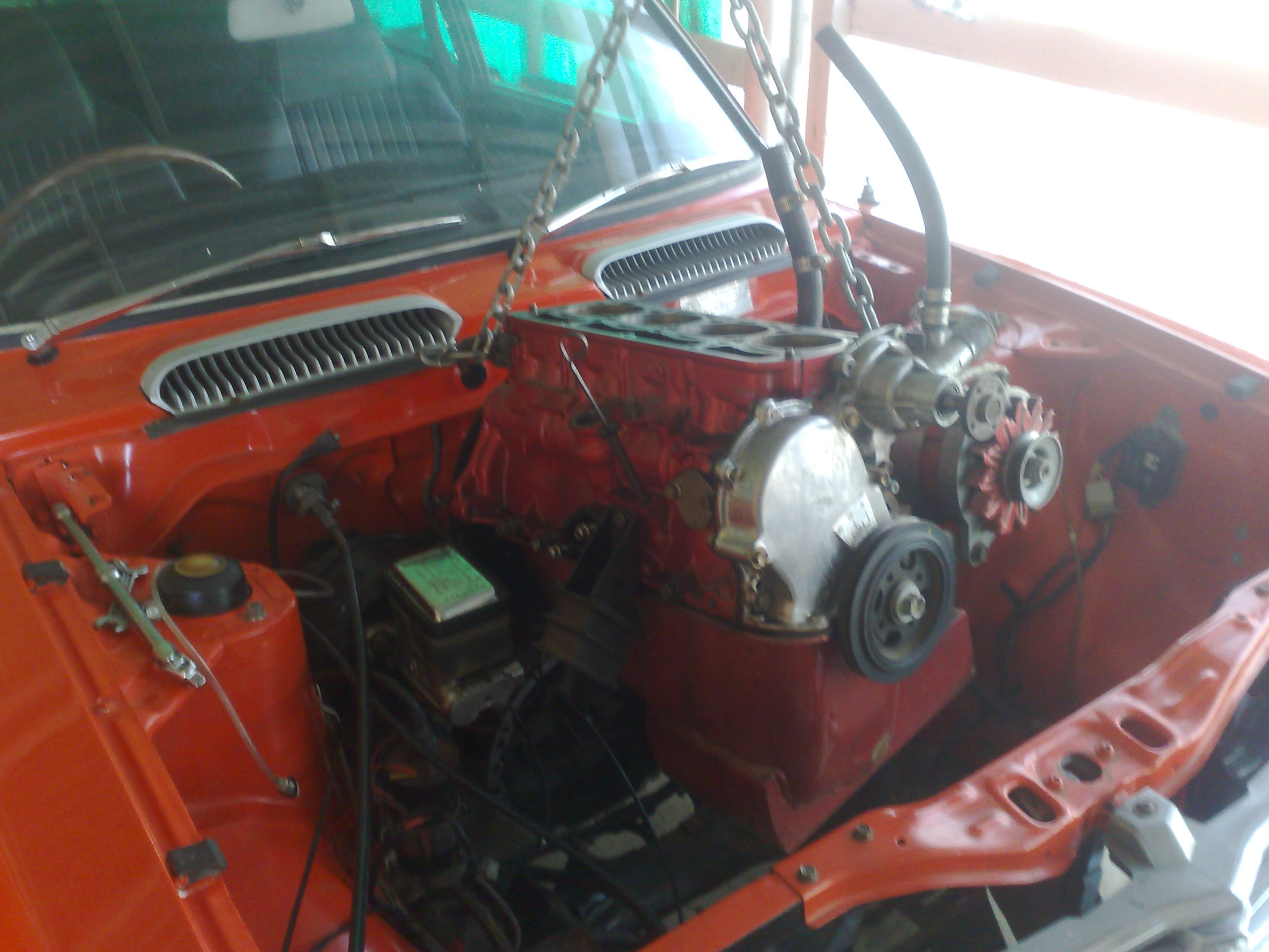

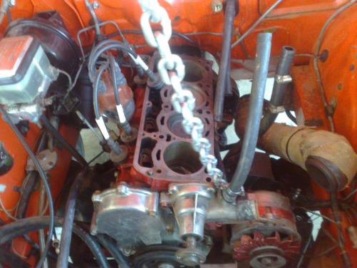

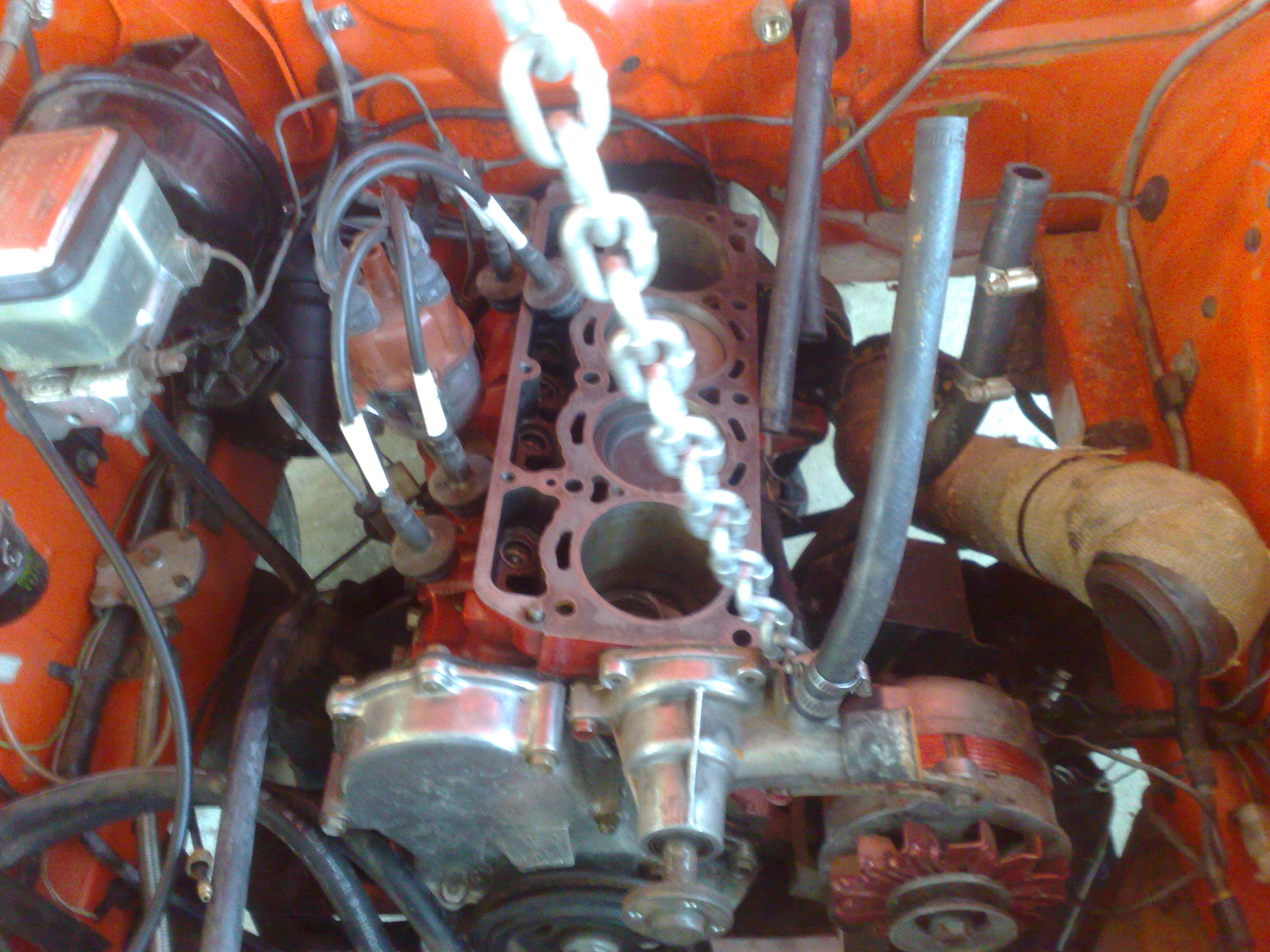

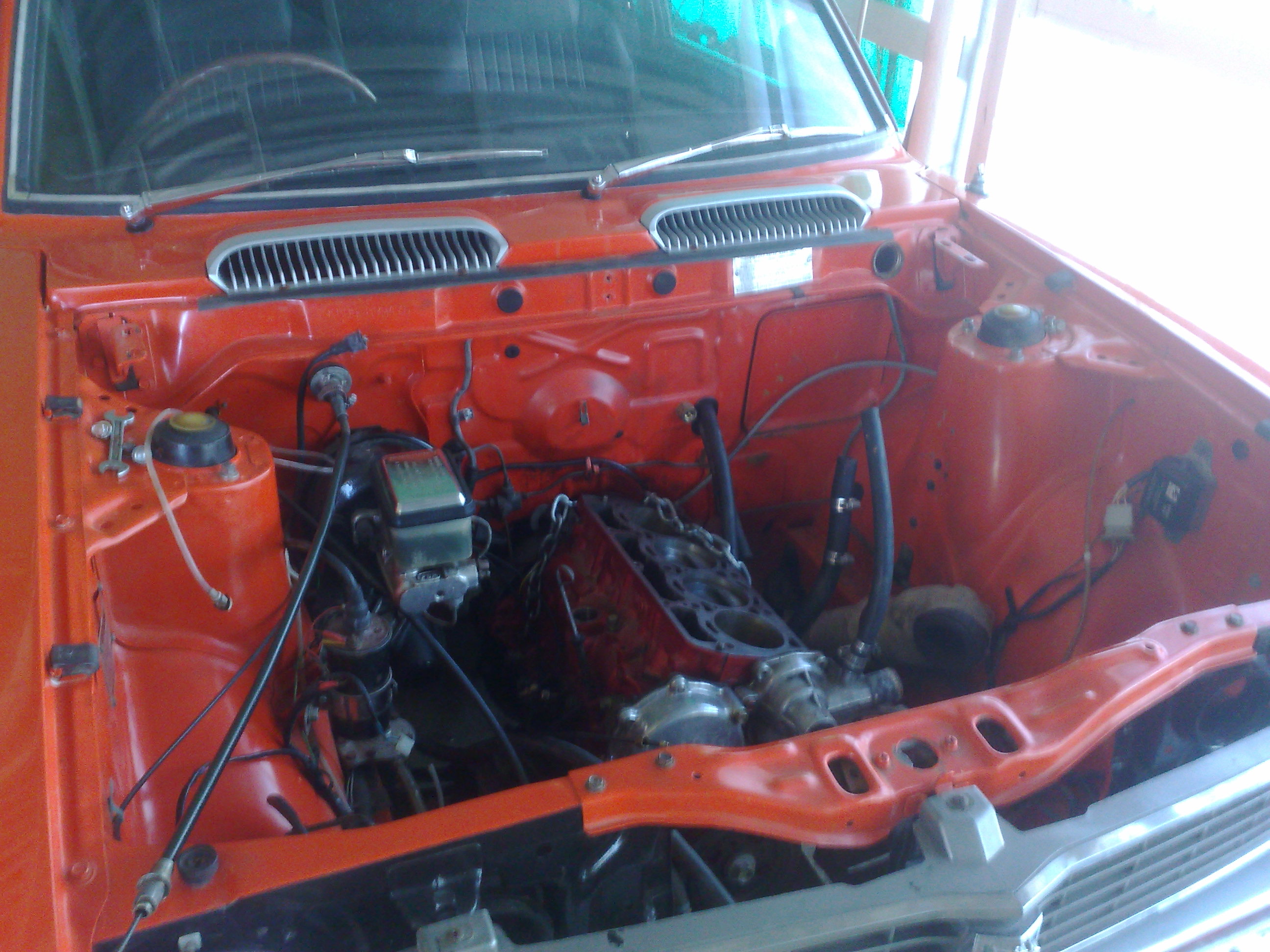

KETURBO25 Posted November 14, 2009 Author Report Posted November 14, 2009 Today i finally got around to taking the motor out of my car which was pretty easy (okay not thay easy but ive done worse!) Trouble is i did it by myself which kinda sucked but i got there. :no2: So i thought id put some pics up for you guys to look at, the 7k engine is going to a friend but he will only be getting the bare block, everything else is going on the new 5k which I'm waiting to get back from the rebuilders to put into the car for the first time. Its all happening! So excited :P Hopefully now the :) Will leave me alone. lol Quote
