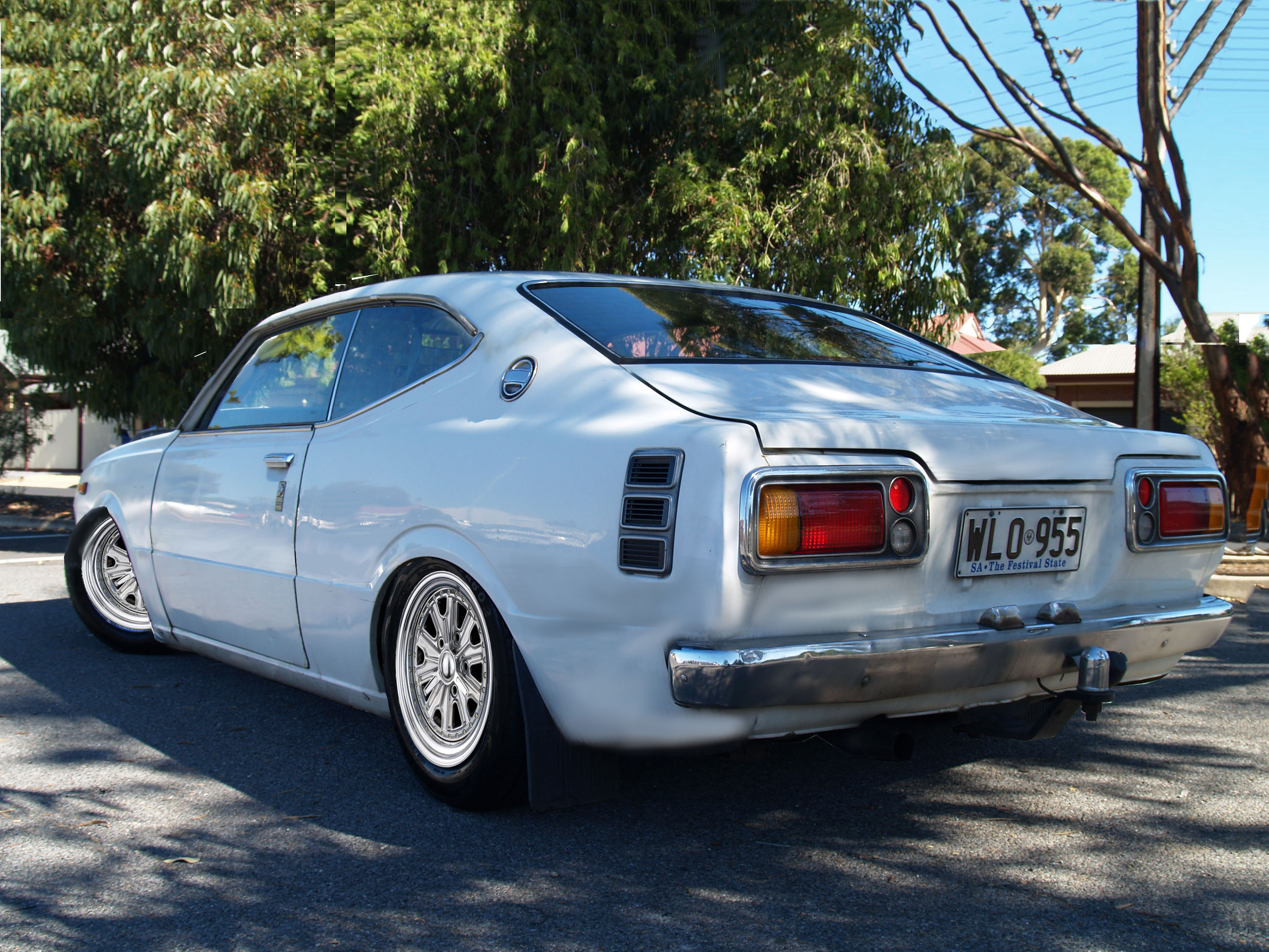

jono1986 Posted December 12, 2010 Author Report Posted December 12, 2010 Time for an update....yay have a job so I can finally get the 35 to a respectable point, should be getting a Electronic Dizzy in the mail tomorrow, some new doors seals later in the week aswell, some new leaf springs (if they're the right ones, fingers crossed) and maybe a 5k motor next week probably should do the shocks aswell now that I think about it. After I've installed the new dizzy I'll hopefully be getting a much cleaner signal for the dash conversion, will post a new video sometime this/next weekend. Â Have posted this picture in the gallery but this is what I'm aiming for.....(minus the chopped roof) Â Quote

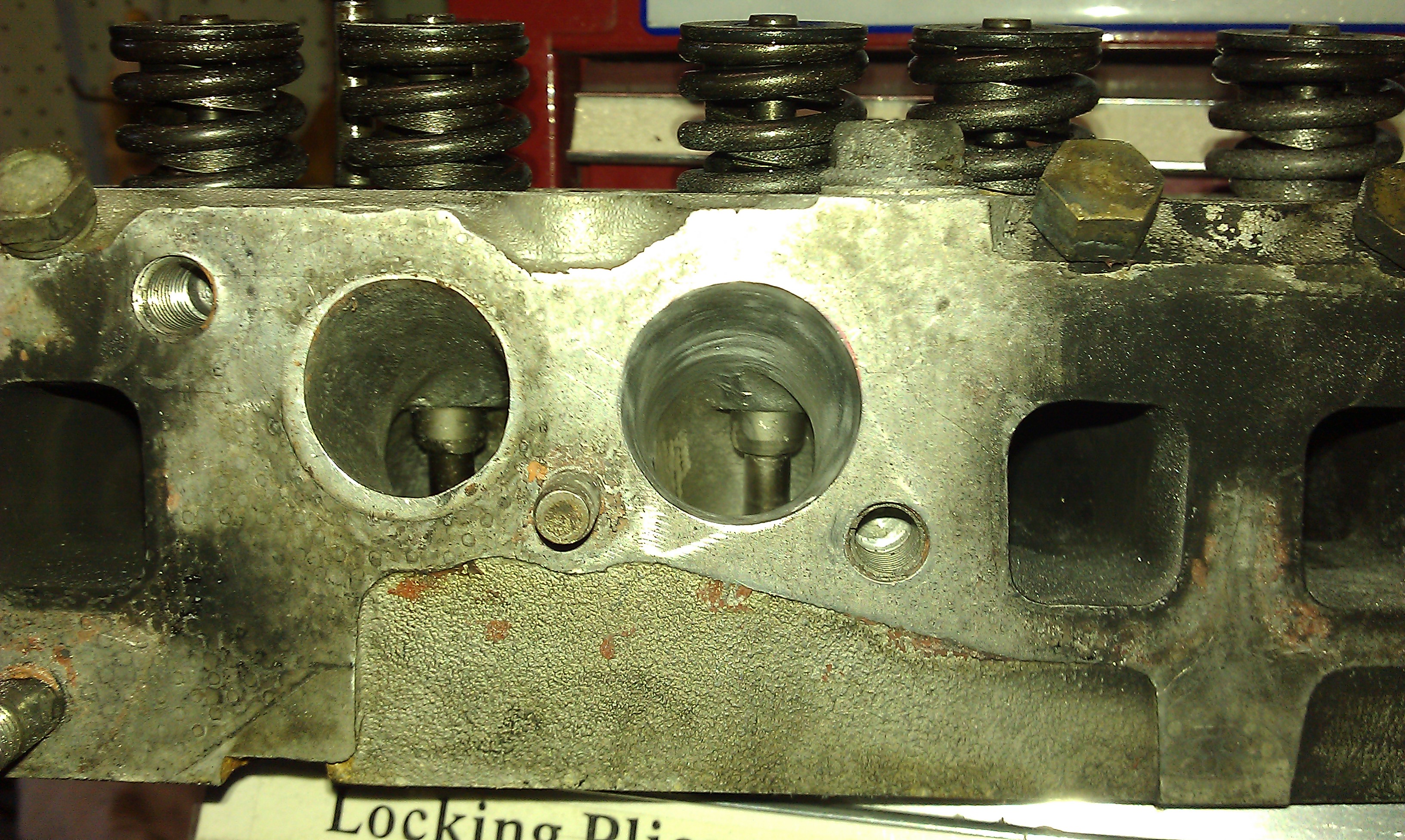

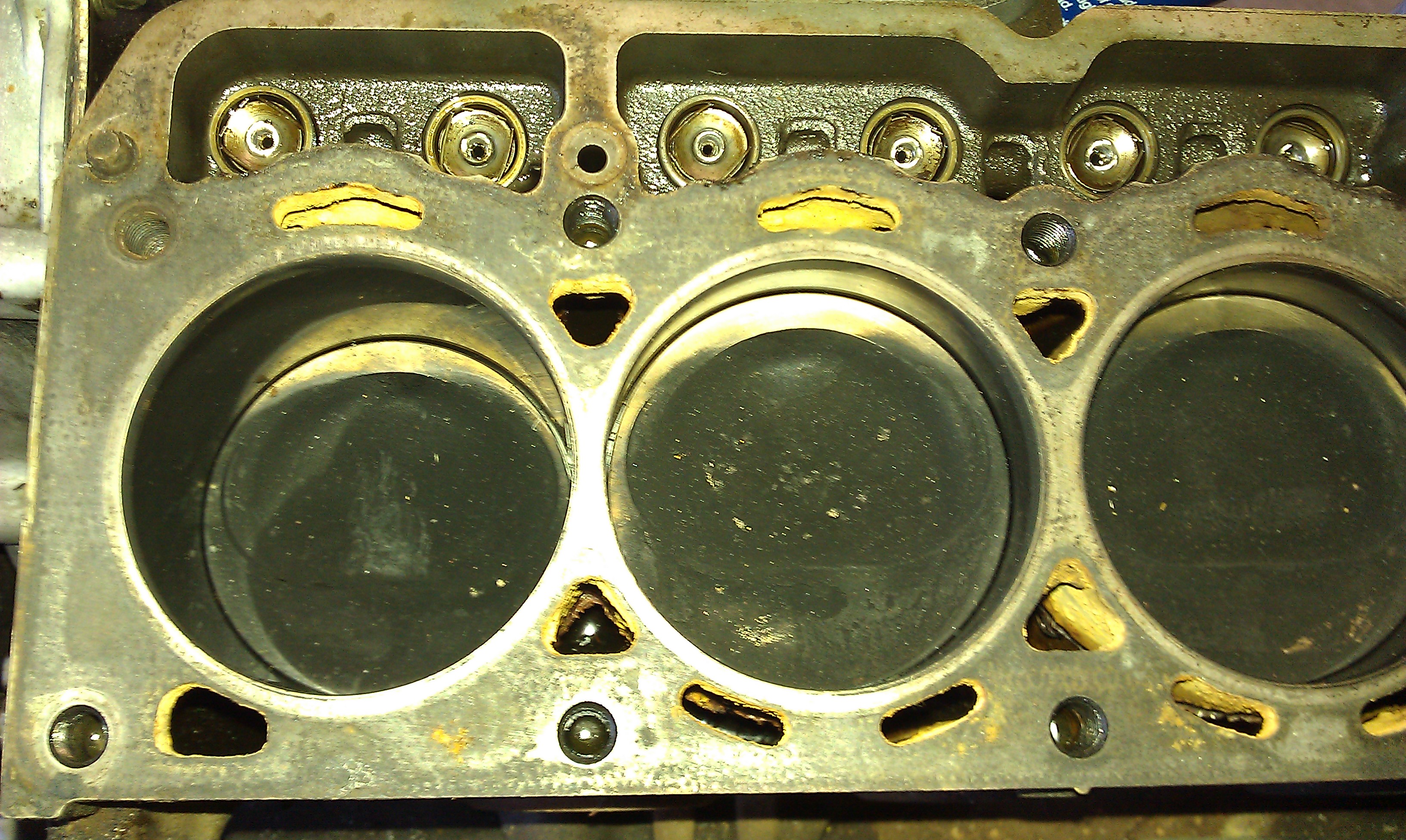

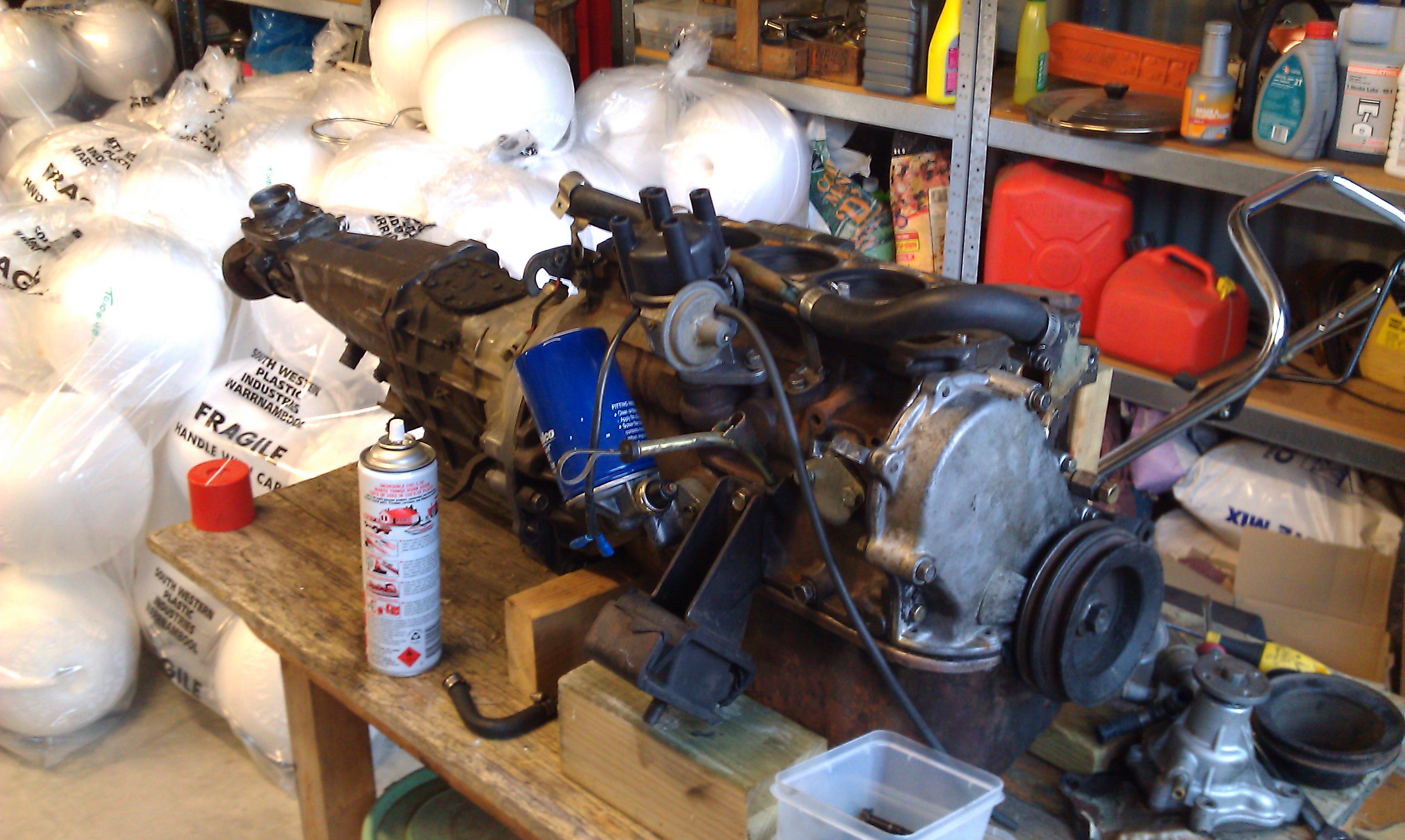

jono1986 Posted January 24, 2011 Author Report Posted January 24, 2011 Hey guys, have got the 5k motor sitting in my (dads) shed right now and have pulled the 3k out ready for the 5k to be dropped in. Â I being an idiot had taken out the 3k before looking at the 5k and some gaskets need replaced, going to swap the waterpumps over aswell and pictured below is the start of some home head porting work. Rang a place on Brighton road about getting it matched to the inlet manifold and also putting in bigger valves but they said $600 and decided it's not really worth it, so gonna do it myself. Â Piccies :yes: :yes: Â Block and G.box not much to look at but: Â Â My new pistons :lolcry: :lolcry: :lolcry: Â Â This is what I've done so far with the head porting (the second inlet is the one that I've started). Did this with a dremel tool but going to try a die grinder tomorrow see if it's a bit quicker. Â Â Hopefully have the headporting done by tomorrow night and will try and get the Block and gearbox in tomorrow aswell.....Am so happy aswell that the gearbox mounts line up so perfectly. Â Â Jono. Â Â Â Â Oh just remembered gotta do some new wiring aswell...list keeps getting longer :bash: but :dance: aswell Quote
