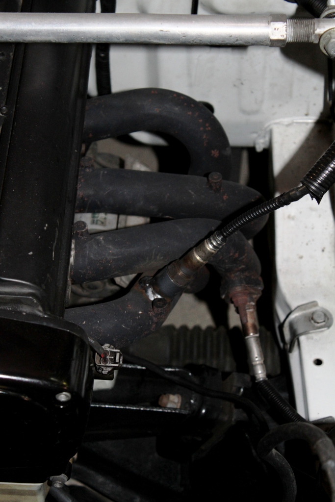

LittleRedSpirit Posted June 24, 2011 Author Report Posted June 24, 2011 Its just a good quality denso one. I have a pretty unique cooling system, so its probably more to do with that, particularly where my temp probe is, as its not at the thermostat. Just got the innovate LC 1 in the mail. Its pretty easy to configure, connect three wires, hit ignition for 20 seconds to calibrate it automatically, then plug it in more or less. Will have to get the bung welded in asap. My fuel map is almost all guesswork right now, so I want to see how I went tuning it by feel first and just keep logging and refining as time goes by. Car goes great, but I just want to learn the exercise.

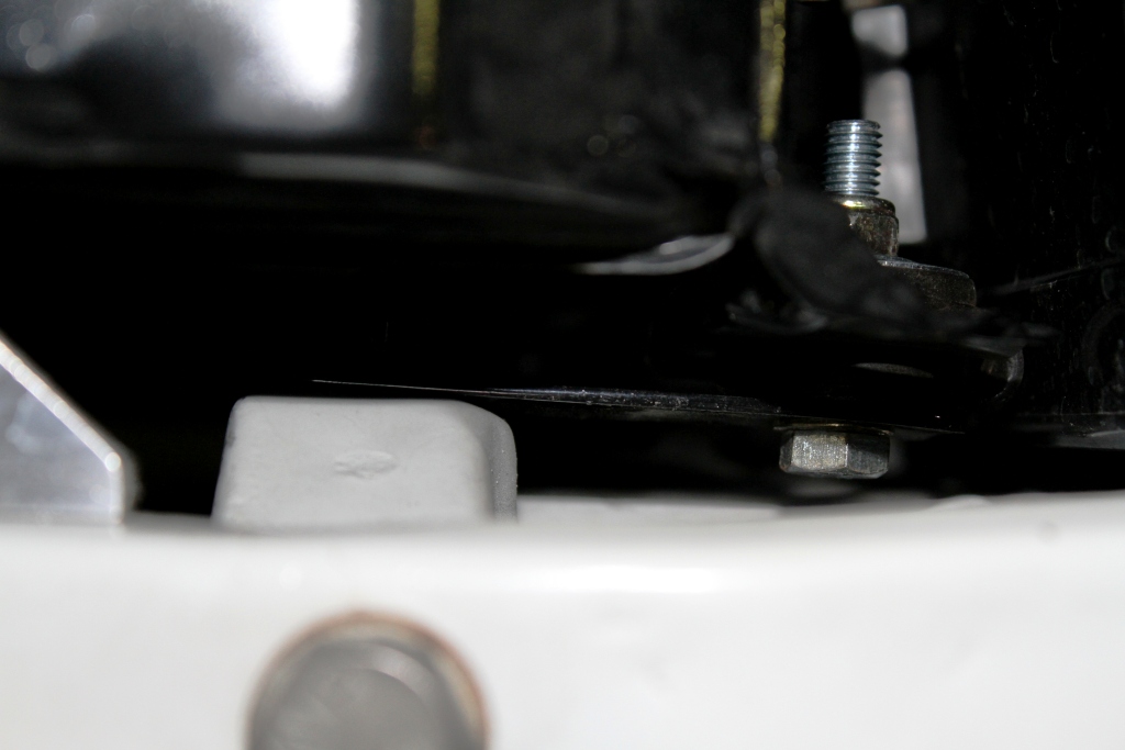

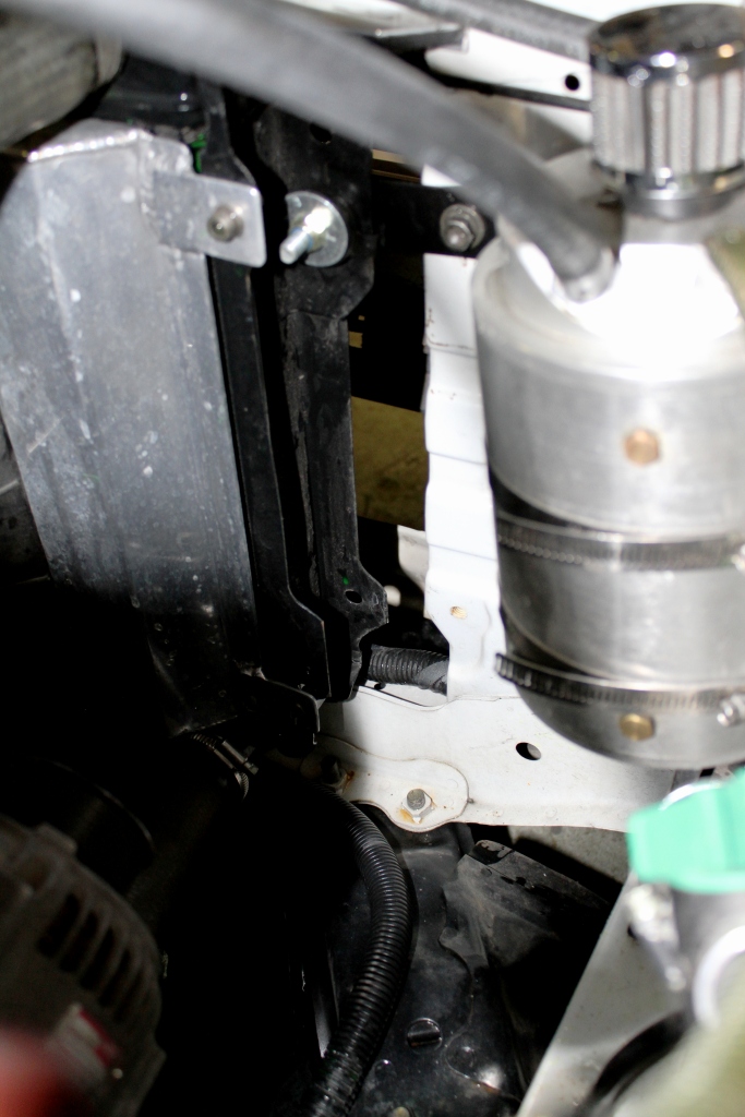

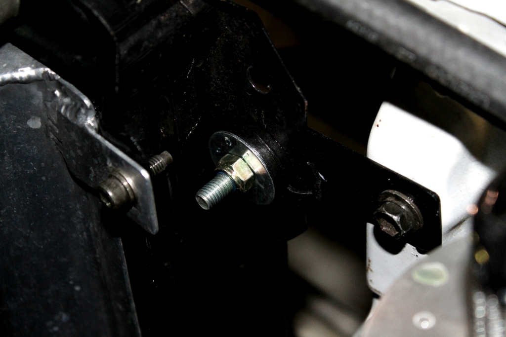

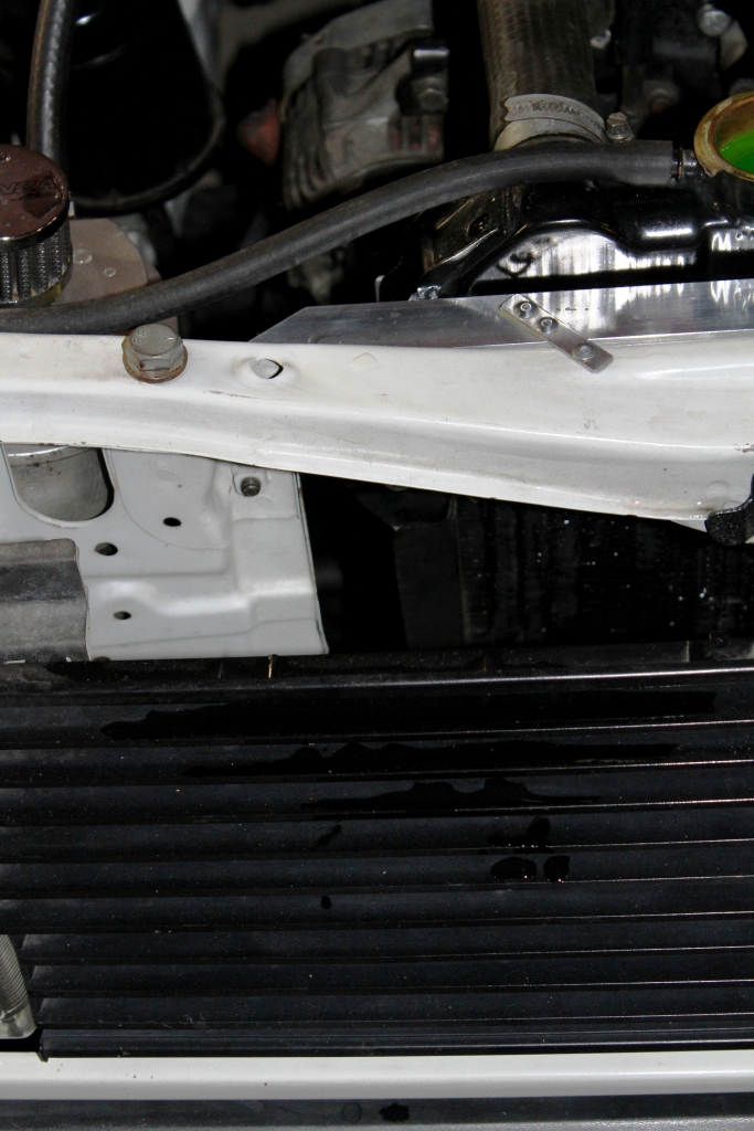

LittleRedSpirit Posted July 14, 2011 Author Report Posted July 14, 2011 I'm doing another mod today. Ive been thinking for a while how to get air to the quads without modifying the radiator support by cutting holes and ducting. Ive also been wanting to make my radiator less efficient to keep a bit more heat in the motor, especially on the highway. I think Ive come up with a good idea. Ive made some radiator relocation brackets, I'm not moving it far, just about 3 inches to the exhaust side. This will help in a number of ways. 1. Some of the core will be partly obscured and therefore drop radiator efficiency a bit. 2. Will reveal a large slot that I can duct towards the inlets. 3. Will keep more of the heat from the radiators air to the exhaust side where its already hot. Will report back with how I go.
ninja-philbo Posted July 15, 2011 Report Posted July 15, 2011 interesting but why? is it too cold on the highway and will this affect ur tune??
LittleRedSpirit Posted July 15, 2011 Author Report Posted July 15, 2011 As it stands, I can hit the cold rev limit on a long night time drive on the highway, so to make my tune work I need it to be a bit warmer in there. Once you go faster the problem gets worse. Anyhow, the mod is completed, it worked awesome, just need to finish the ducting to get the most out of it. I now have approx 4 degrees cooler inlets temps unless I'm stationary.
LittleRedSpirit Posted July 20, 2011 Author Report Posted July 20, 2011 Just got a laptop so I can datalog with the car. I got a Lenovo thing brand new for $225. Its great, just a 10 inch screen and a 250g hdd, 1gig ram and an intel atom 1.6ghz chip. Should be ideal for travelling around under the car seat logging data. I'm taking it to the drags tonight to see how the afrs are up top. I opened my rev limit up to 8500 to try and get more speed in each gear, so i need to watch the tuning and make sure its all sweet. The map reads like it should drive fine but I need to test afrs to really know. Ive also finished ducting the slot next to the radiator. Looks Good. Hopefully it shares some cold air around.
