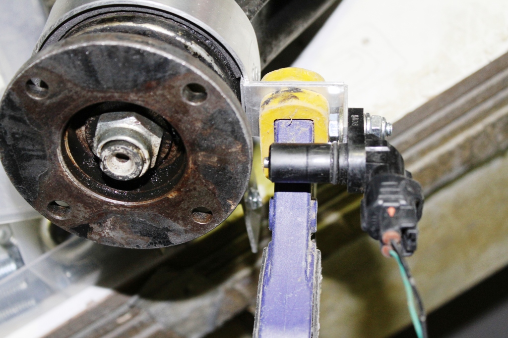

LittleRedSpirit Posted May 6, 2011 Author Report Posted May 6, 2011 I just got a different speed sensor from the wreckers, it fits just like the Toyota one but it is quite different, I assume it has more pulse per rev than the 4 pulse Toyota one, so I will pop the top off it and try to mod it to a 1 pulse type and if that works, I should have flawless speedo data.

LittleRedSpirit Posted May 8, 2011 Author Report Posted May 8, 2011 Looks pretty good, but I shouldnt need something that standalone with the instrumentation I already have. I am now just fitting a hall effect sensor to give a clean speed reading. I tried a few reed switch ones and they were all crap. Will do something on the diff nose like this experiment I'm working on.

LittleRedSpirit Posted May 17, 2011 Author Report Posted May 17, 2011 Did some work on the loom today. Injector plug number 2 was only holding on by 3 strands of copper, and the power wire was not adequate cable as it had been soldered at to add other experimental stuff. So I replaced the power wire with a new machine crimped spare from the complete loom I bought to steal wires from. I tapped into it really neatly like Toyota does with the little crimps and a drop of solder to secure it. I added a 2 pin plug to it to give a neat finish and a secure method of sharing the ecu power to some additional sensors like the mvss and any future experiments I might need it for. It runs a bit nicer, especially when you are into it, I guess a stronger power feed to the ecu helps and who knows how the injector might have been affected. Was 2 hours well spent. I think I need to make an ecu controlled flip grill for winter. The radiator is just too efficient. i can hit the cold rev limit after sitting on the highway for a while, especially in sub 15 degree evening conditions. Might make some sort of flip setup in front of the radiator core behind the grill, to maybe block 1/3 of the cooler fins, when rquired. It would self open when the temp hits a certain point, and close if it gets a bit cool. Next thing to do is some cold startup tuning on a really cold morning, it needs better temp trim at the extreme lower levels, and it is becoming more evident as it gets colder.
