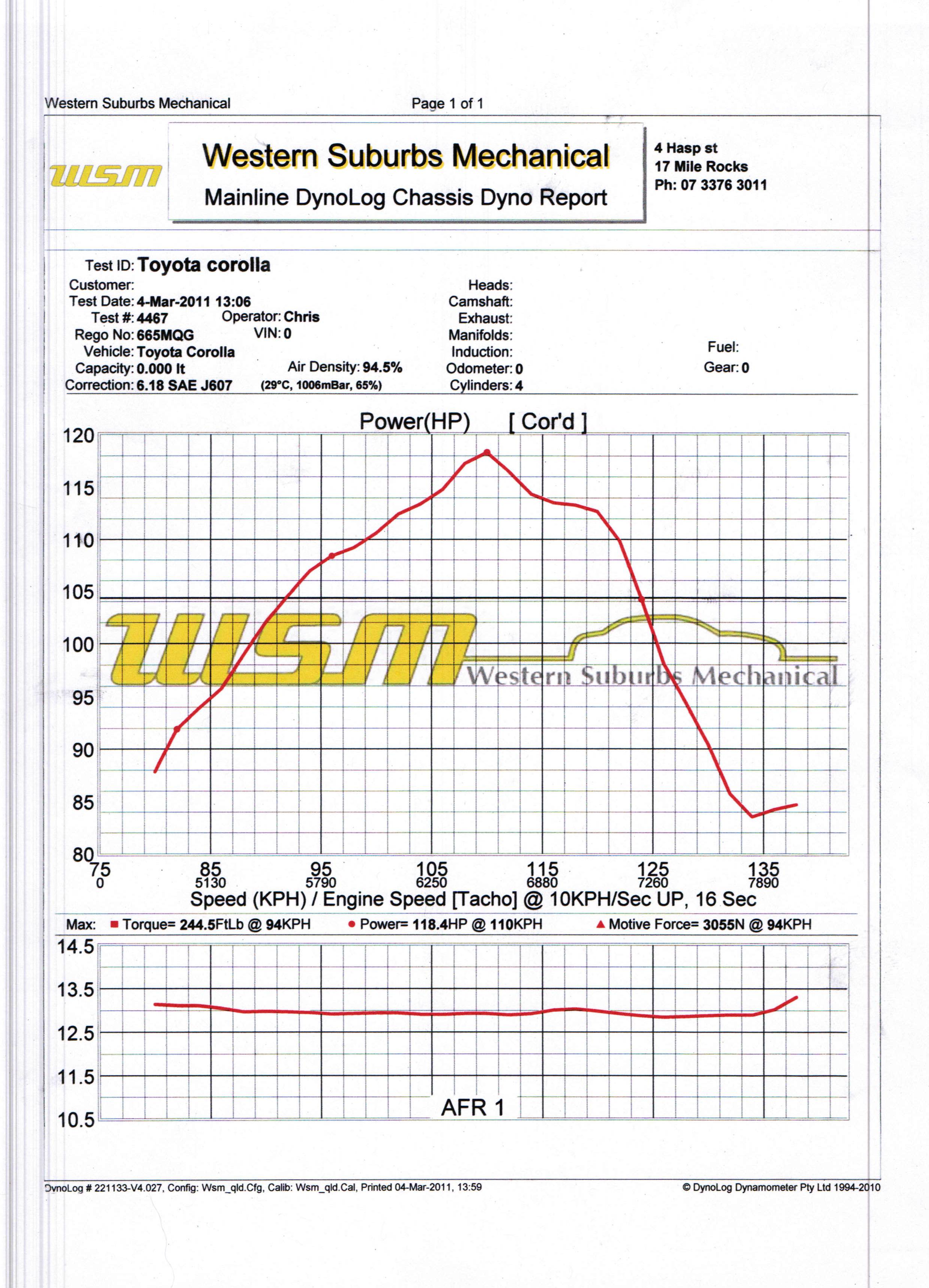

LittleRedSpirit Posted March 4, 2011 Author Report Posted March 4, 2011 So it seems my battery isnt dead. Its a trusty workhorse. I found an absolutely f@$ked wire right at the battery terminal. It must have had acid on it in a previous life as it was rotting the pins in the plug, and it was the wire that feeds the whole ignition key and dash area. This explains why the lights were sometimes not switching on, the key obviously wasnt supplying enough voltage to trigger the starter either. It seems lively now, so I've booked in to put it on a dyno and do a power run and O2 reading. This should give me some more ideas for tuning and finding some more fuel economy. Ill post a video of her wide open on the dyno later today. Also will put the chart up and see how its doing. :cool:
LittleRedSpirit Posted March 4, 2011 Author Report Posted March 4, 2011 Ok, just got back from some dyno time. We did a power run, found it was a bit lean right through, just about half a point average. It appears my interpretation of a happy sounding motor is one pushed close to the edge. Added a lot of fuel aspecially from 4000-6500rpm, as it wanted a lot more and just kept making more torque in that range. Its an interesting chart, and it confirms that my modifications to gain torque have worked. Compared to my old dyno chart I am making a lot more power earlier. It also made 88KW on their scale, it made 85kw before. So it has made more power earlier, infact, with the combination of a 2 inch exhaust pipe, 4-2-1 extractors, and 30mm long 42mm diameter trumpets on silvertop throttles, it makes its peak power at 6550rpm, a full 600rpm sooner than it used to. So to summarise it makes more power earlier. This means the area under the curve is quite large compared to the old system. I will plot the 2 graphs onto a shared scale for comparisons sake to exemplify the point more clearly. Its making 100hp at 5450 rpm. Thats sure putting ts power down differently than before. See chart below. Videos to come when I tube em.
