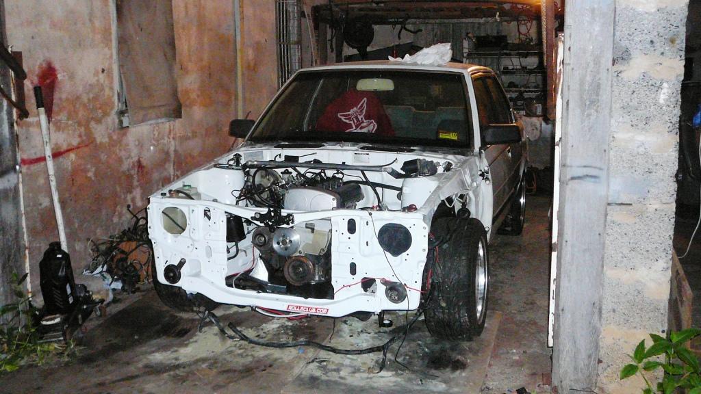

LittleRedSpirit Posted March 31, 2010 Author Report Posted March 31, 2010 (edited) Getting there mate, getting there........... your gonna be tearing up the streets of Brisbang before I am I know that much... You can go get an exhaust and tune and beat me to it. We kicked it over tonight. The starter cranked it no worries, with a little work. Haha. Its wired now, we just need to add an air temp sensor (which funnily enough niz is in your car, haha). :P Heres a photo. Tomorrow it gets dressed up, and taped together, panels and lights, dash back together and in with ecu and hopefullty it will fugging start and drive. Might run a bit odd, until the exhaust is fixed. Might be good, you never know... hahah. Edited March 31, 2010 by LittleRedSpirit
