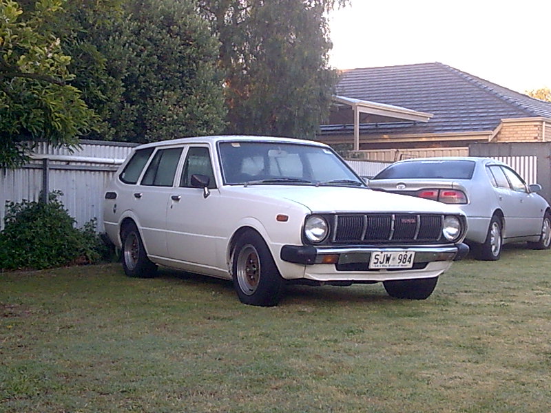

Smithius Posted September 21, 2009 Report Posted September 21, 2009 yeah i know it was stuffed before hand but the springs have made the problem a bit more noticeable. Â here is a photo of it as of this morning, so you can see how it sits. Â Cheers again Quote
SLO-030 Posted September 21, 2009 Author Report Posted September 21, 2009 Little progress from last night. More pics from Luc to come. Â Rear Doors are almost smooth. Front Doors are already off, ready for the first prime. Â Â Â A bit more rust cut out. Â Â Â . Â Â Made up some spacers at work and am now able to run the chasers on the front. Just need to get some 185/60/15's. Quote
