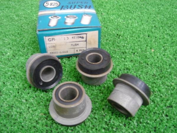

The KE1x bushes are quite different from the KE2x. 2 bushes per arm vs one bush.
Facing the same problems as you, I just managed to pick some up in Japan.
Unless some new old stock turns up somewhere, you may need to get some turned up in urethane, using your shells to guide measurement.
