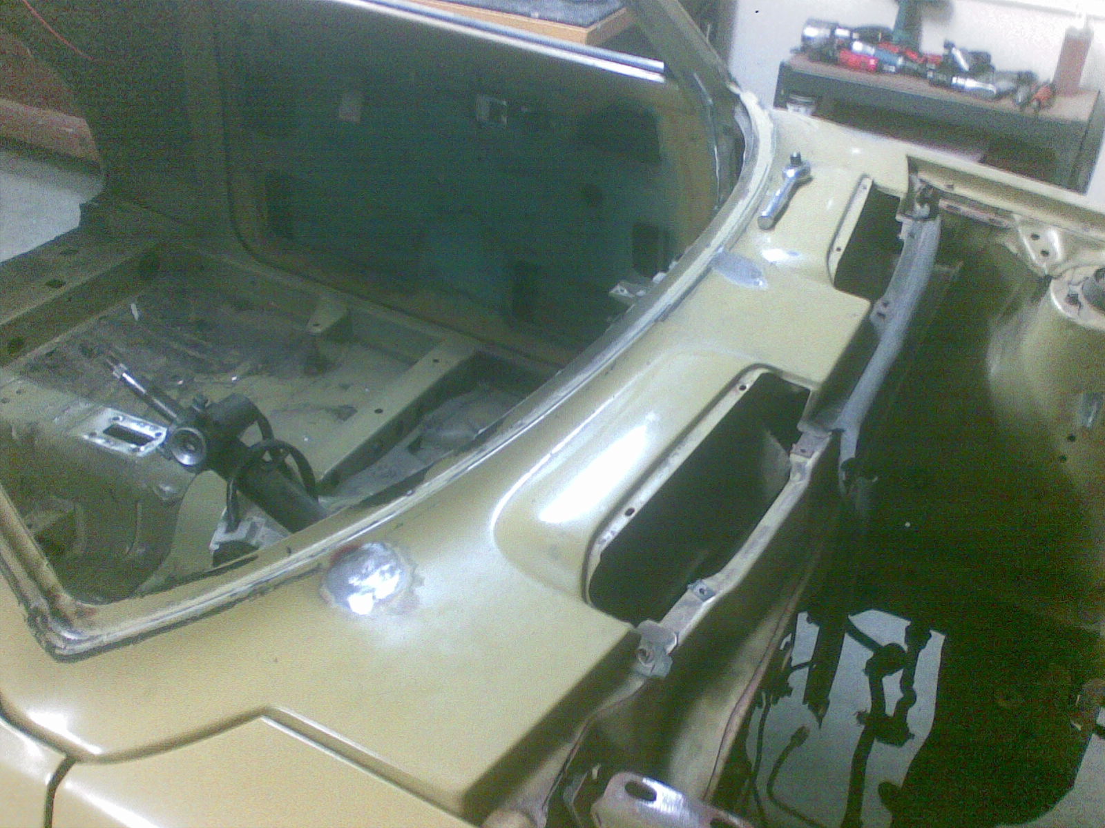

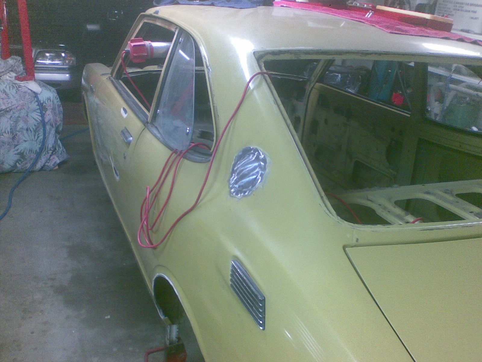

tipsi Posted October 4, 2009 Author Report Posted October 4, 2009 (edited) Got Busy over the weeken, was battling for some motivation this weekend after work but got through it. Stretched the rear gaurds for my 28x9 slicks, fixed 1 patch of rust, filled in petrol cap, washers, antenna and mirror holes. Edited April 15, 2013 by tipsi Quote

tipsi Posted October 5, 2009 Author Report Posted October 5, 2009 more pics.... slowly slowly...... Quote

PMP020 Posted October 5, 2009 Report Posted October 5, 2009 excellent!!! any progress is welcome progress. do you have any close up picks of the rear gaurds? maybe even an inside shot, just so we can see how much you had to pump it out? keep it up!!!! :) cheers, scott Quote
tipsi Posted November 10, 2009 Author Report Posted November 10, 2009 Progress has slowed over the last 3 weeks due to the exspense of the gearbox and rear end, how ever back into it now, will update with some pics. I havent pumped the gaurds just rolled the lips under, flared them and extended the gaurd by 70mm. I will dummy fit the engine, gearbox, and engine plate in coming weeks and throw some more pictures up. (new tunnell will have to be removeable to access the clutch... Been busy straightening rear quarters after spot welding, hoping to straighten and fill them this weekend and put in primer. Quote
