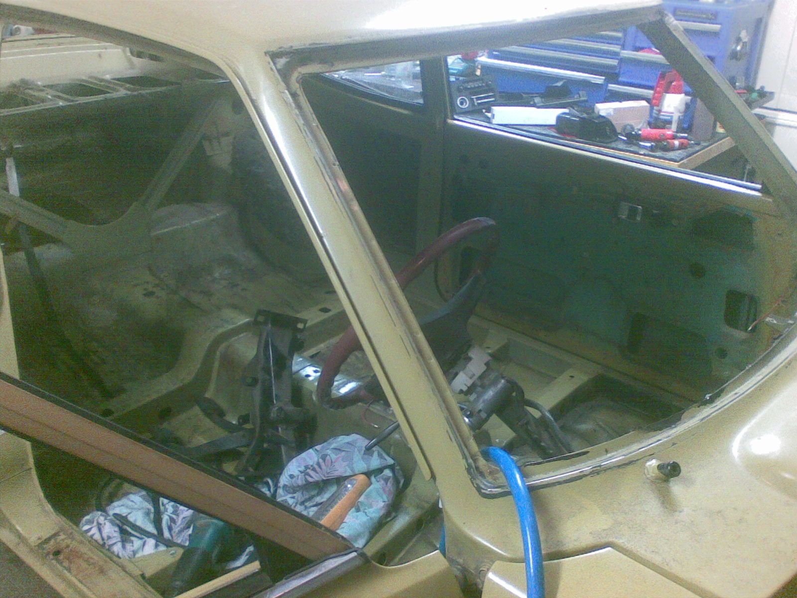

tipsi Posted September 15, 2009 Author Report Posted September 15, 2009 Here are some more pics; started to mark out firewall and recess also trimmed the dash bracing away, removed pedals and column etc.. from the car which now leaves me with a clomplete bare shell. I will begin cutting the floor out and sizing up the rear end this weekend. :lolcry: Slowly but surely. Quote

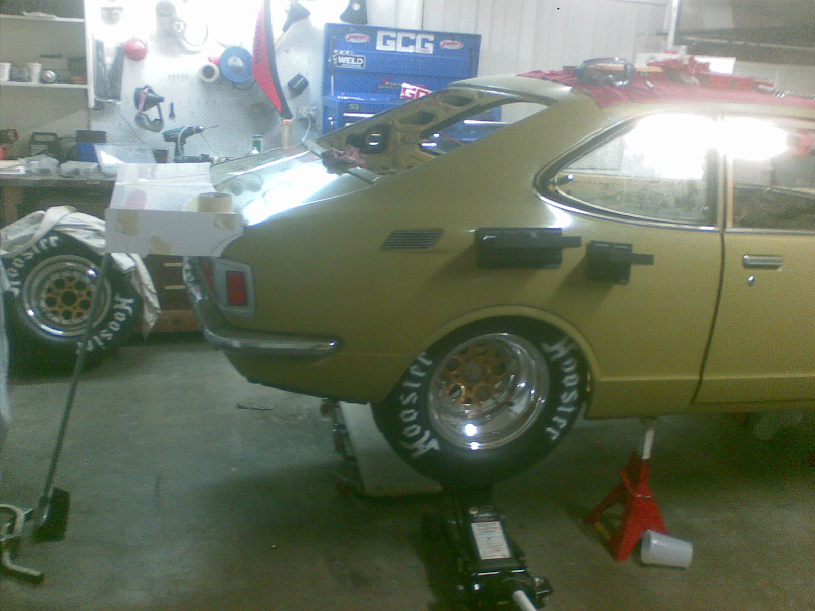

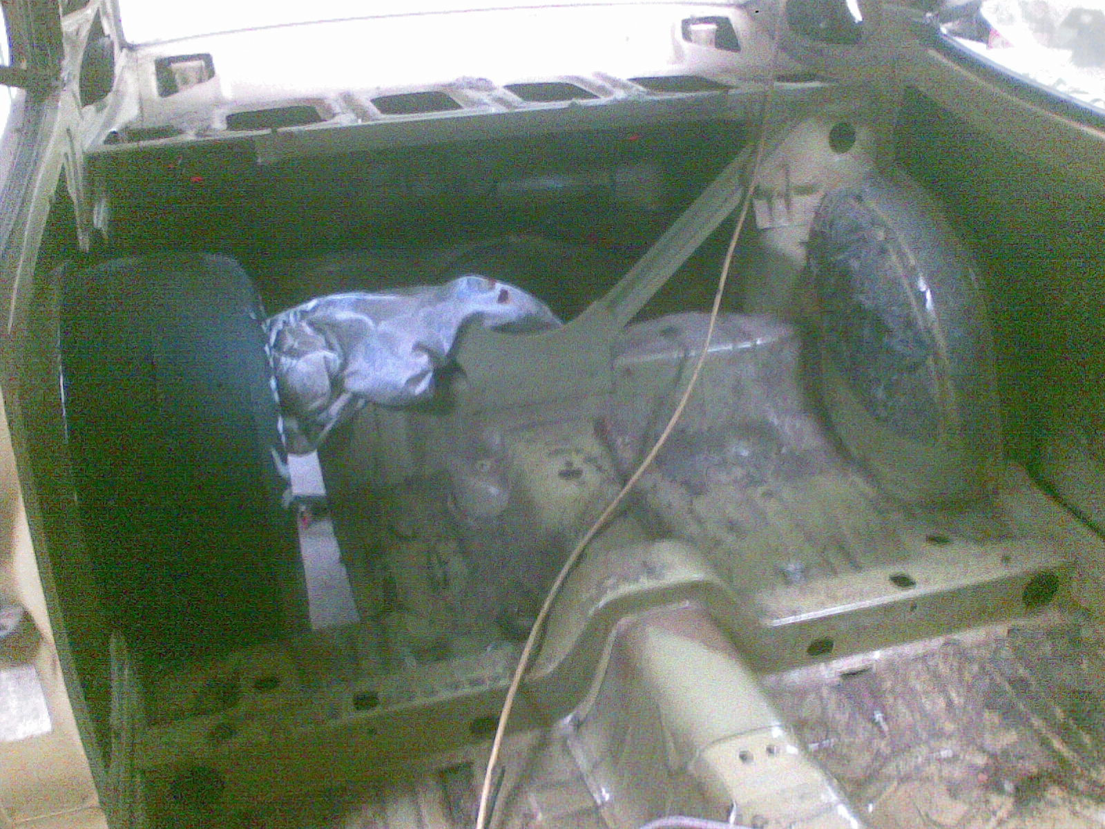

tipsi Posted September 21, 2009 Author Report Posted September 21, 2009 well my rims arrived from USA monday and tyres came in from VPW. I have cut the wheel arches out and meausred up the rear end and diff. Here is a shot of one wheel tube cut out and the rims I will be using. Rear end wont be too far away. Just got to stretch the rear gaurd a bit. Quote

HIGH ROLLER Posted September 22, 2009 Report Posted September 22, 2009 You are an absolute maniac.....just puting it out there. How will you keep it from being pretzle-ified?? big cage and bracing?? Quote
Tally Posted September 22, 2009 Report Posted September 22, 2009 Great choice of wheel!!! What a beast!!!!!! Quote

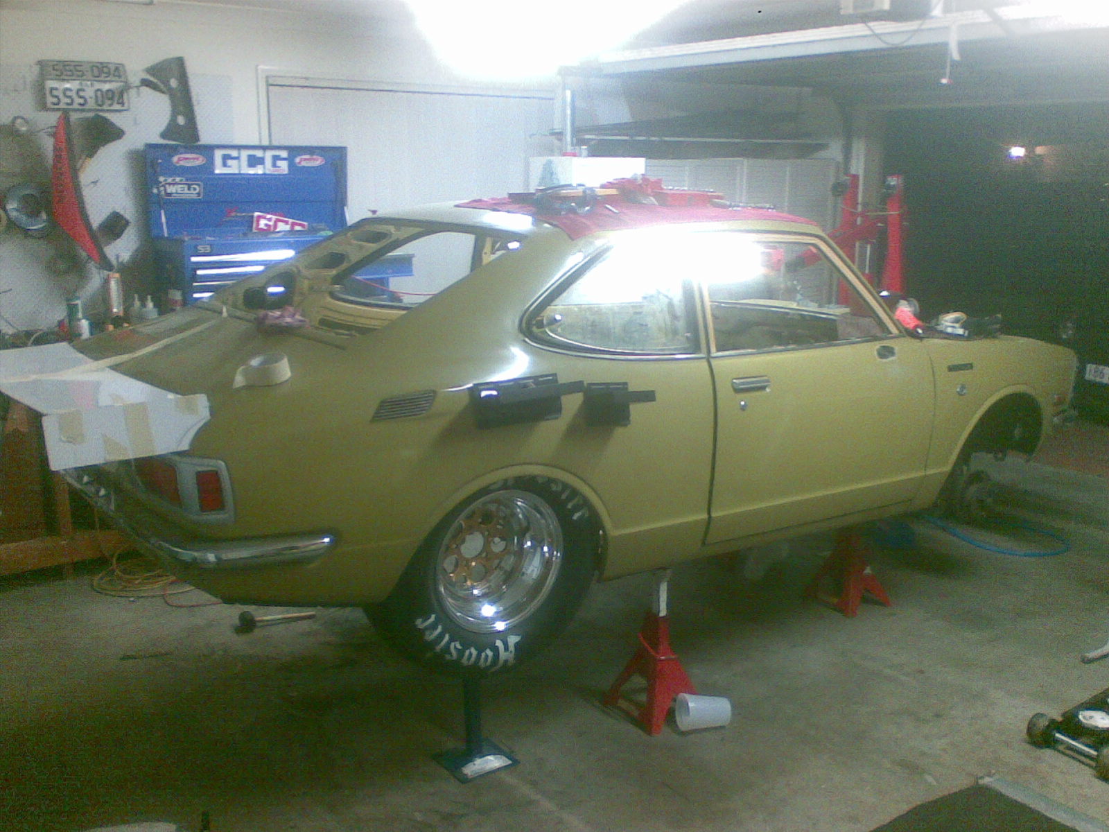

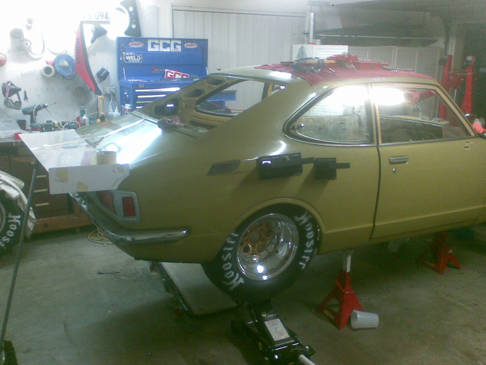

tipsi Posted September 25, 2009 Author Report Posted September 25, 2009 Small progress at the moment. Have decided on a 33'' ladder bar setup with the 9'' for now. New crossmembers and chassis bracing. :jamie: Will 4 link it and full tubs if i get serious later on. I have been tackling small odds and sodds lately, filling in time to more parts arrive. :( Rear wing templated, will be making it from 225 Carbon. The motor is currently being built, will dry fit with Liberty gearbox and engine plate, when it returns and the gear box arrives. This weekend will be spent filling in petrol cap, patching the gaurds and removing wiper holes, and removal of sound deadner. Quote
