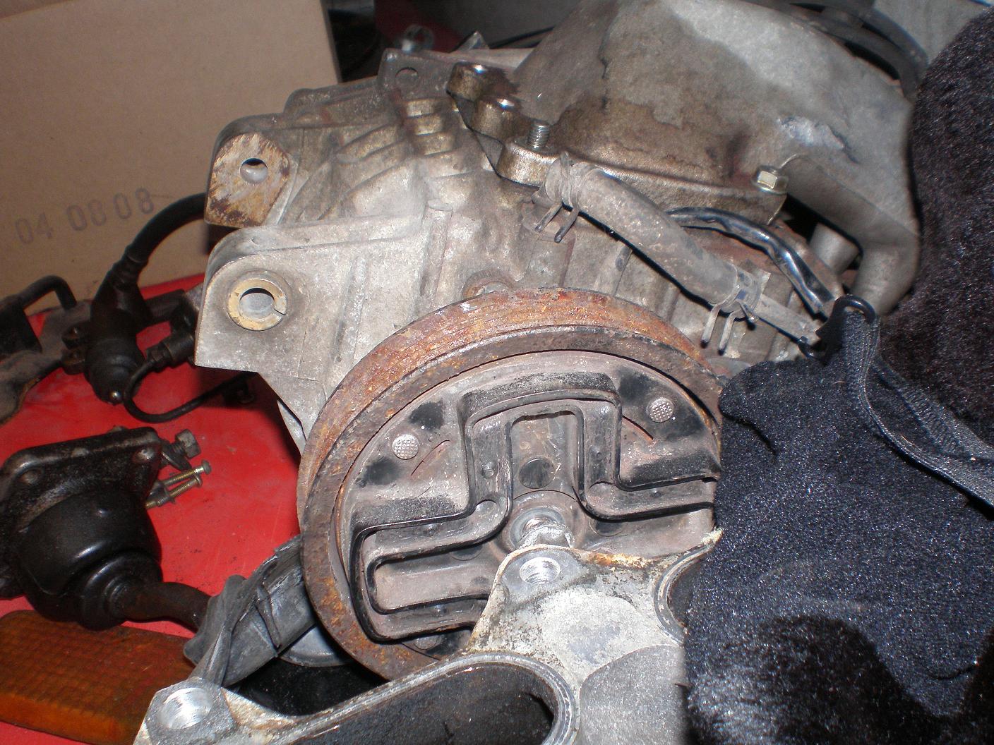

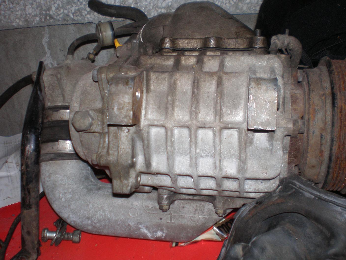

eberbs Posted September 9, 2009 Report Posted September 9, 2009 Hello, I found an ad for a roots supercharger out of a ae101 4AGZE and was wondering if it would be possible to install it into a AE92 4AF corolla. Quote
