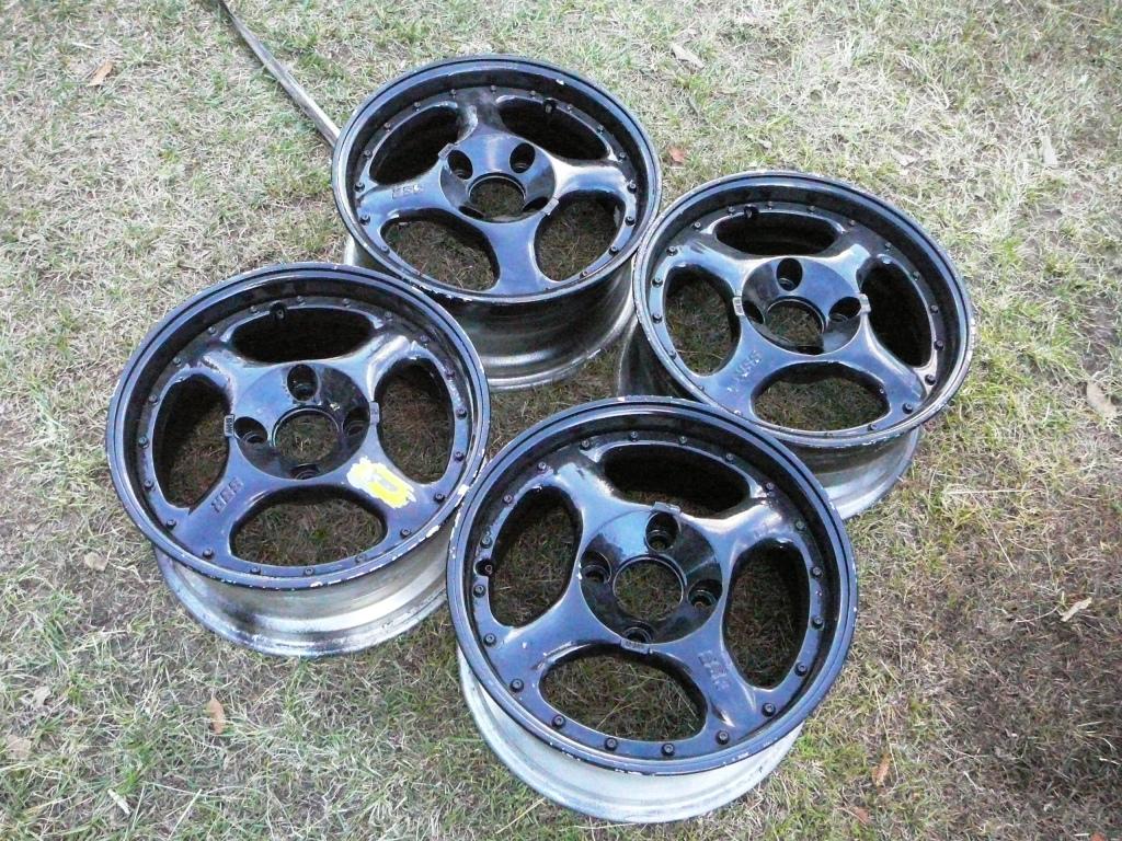

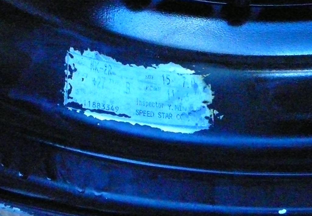

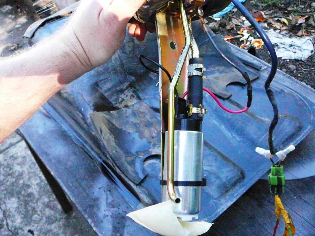

LittleRedSpirit Posted September 10, 2009 Author Report Posted September 10, 2009 Also, Heres the wheels I scored from ebay. SSR MK 2 R in 15x7, offset is +27. I was close with my guess of +25. Might need a small spacer on the front, but will go straight onto the rear on stock gaurds, and I could widen them and have wheels that fit over 4 piston brakes perfectly for the other cars front end in the long term. Theres a half inch step there to aide with spoke clearance over modern calipers. Phil dropped em off today and we did some exterior work to his car, which was good fun. Heres a shot of my new walbro fuel pump, too.
Evan G Posted September 10, 2009 Report Posted September 10, 2009 Also, Heres the wheels I scored from ebay. SSR MK 2 R in 15x7, offset is +27. I was close with my guess of +25. Might need a small spacer on the front, but will go straight onto the rear on stock gaurds, and I could widen them and have wheels that fit over 4 piston brakes perfectly for the other cars front end in the long term. Theres a half inch step there to aide with spoke clearance over modern calipers. Phil dropped em off today and we did some exterior work to his car, which was good fun. Heres a shot of my new walbro fuel pump, too. mate please use 2 metal hose clamps not 1 medium sized cable tie!
Undertaker_is_the_best Posted September 10, 2009 Report Posted September 10, 2009 Also, Heres the wheels I scored from ebay. SSR MK 2 R in 15x7, offset is +27. I was close with my guess of +25. Might need a small spacer on the front, but will go straight onto the rear on stock gaurds, and I could widen them and have wheels that fit over 4 piston brakes perfectly for the other cars front end in the long term. Theres a half inch step there to aide with spoke clearance over modern calipers. Phil dropped em off today and we did some exterior work to his car, which was good fun. Heres a shot of my new walbro fuel pump, too. totally liking those wheels you scored of ebay, what a great place to find the odd bargin or 2 well done will look pretty awsome on the car

LittleRedSpirit Posted September 10, 2009 Author Report Posted September 10, 2009 mate please use 2 metal hose clamps not 1 medium sized cable tie! It had less than that holding it from the factory. Fusion, no lip on this one bud. Cheers undertaker. Trev, I knew what you meant. "Off white, Beige, stucco".
