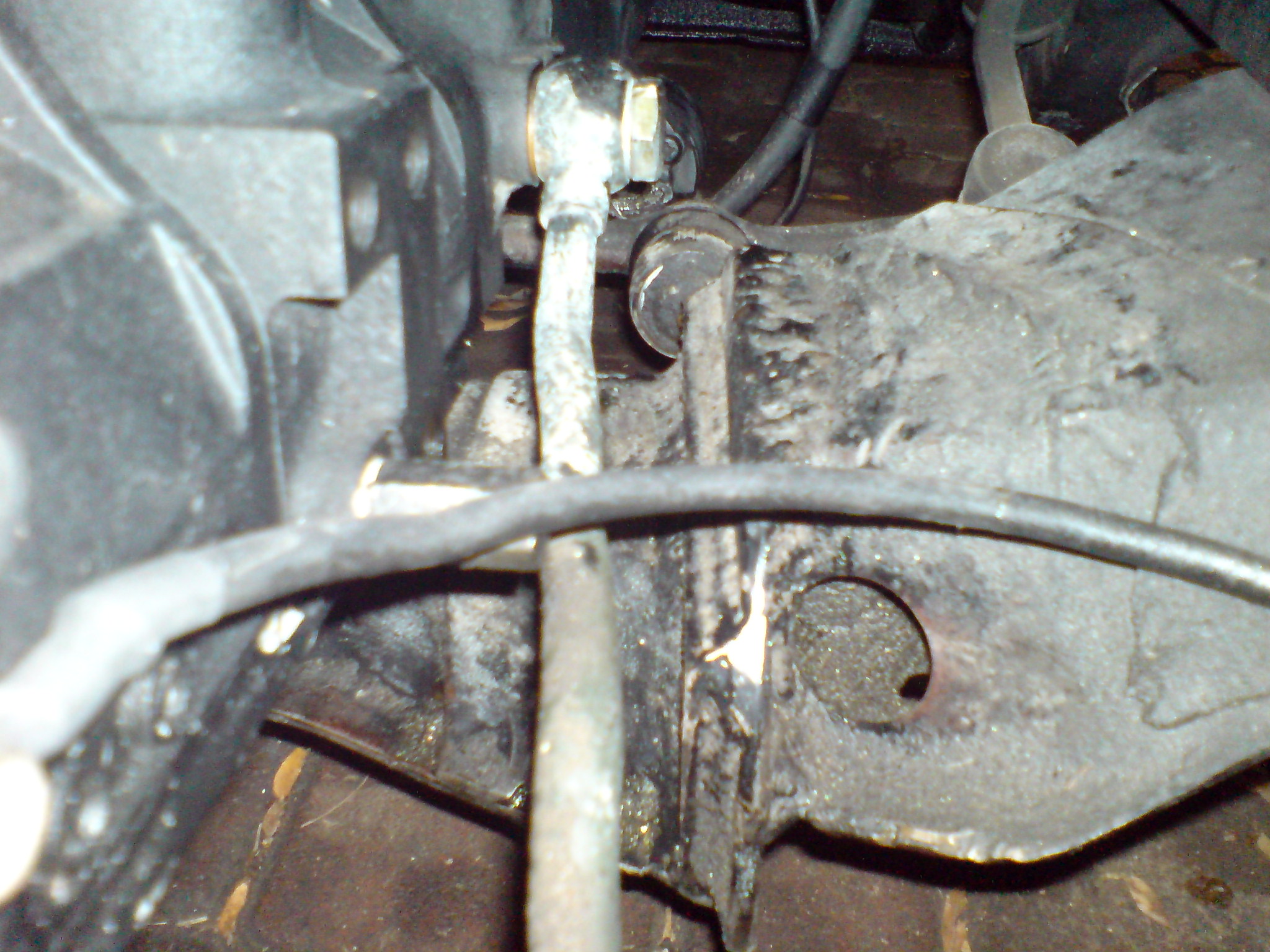

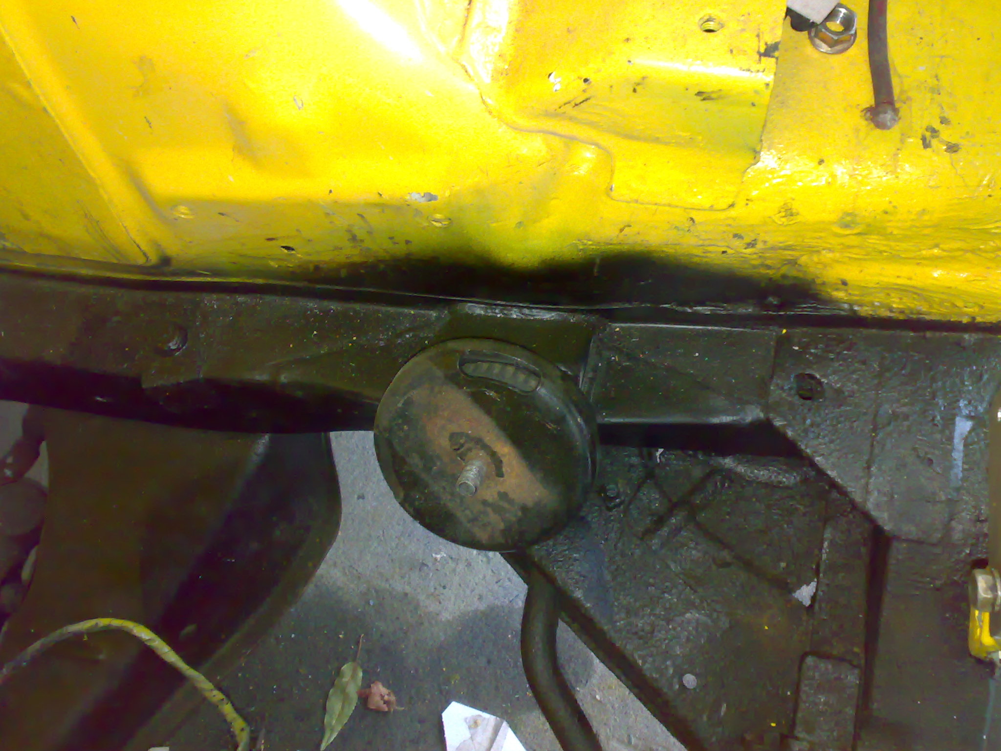

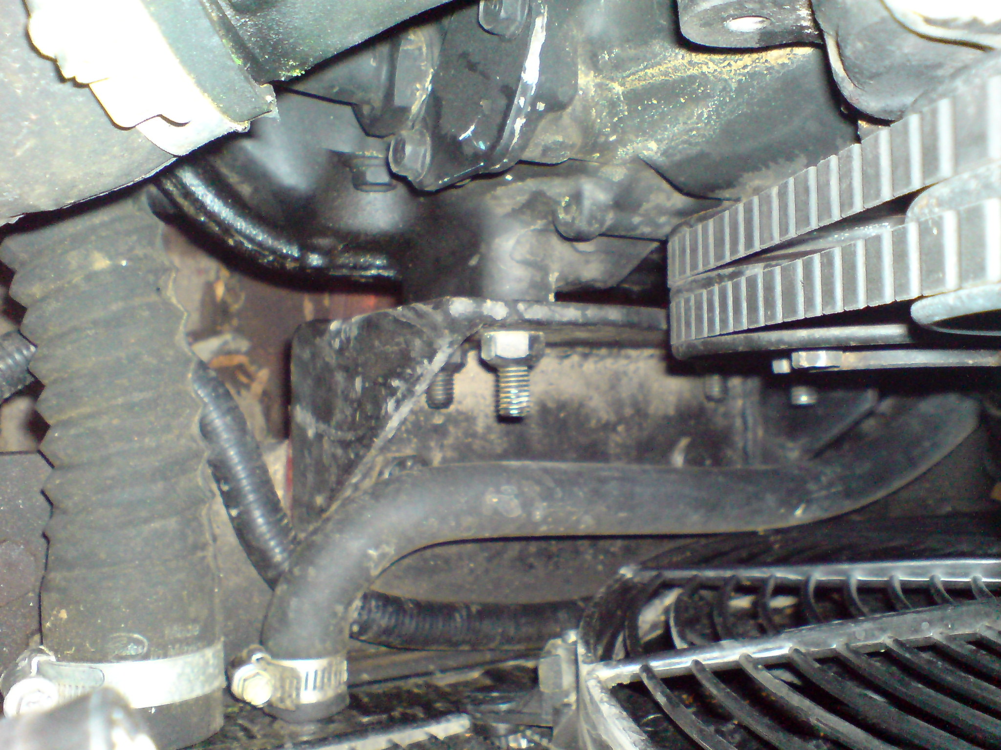

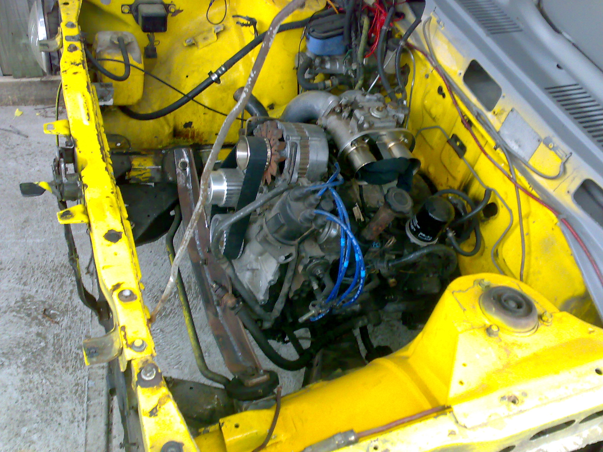

13BT_KE20 Posted August 29, 2009 Report Posted August 29, 2009 crappy pics but you get the idea. Mounted to the front, small nolathane (very hard) blocks between mount and K frame. So basically solid mounted crossmember cut and rewelded lower to allow better clearance for the sump and also allow the motor to be mounted lower in the car :y: Quote
