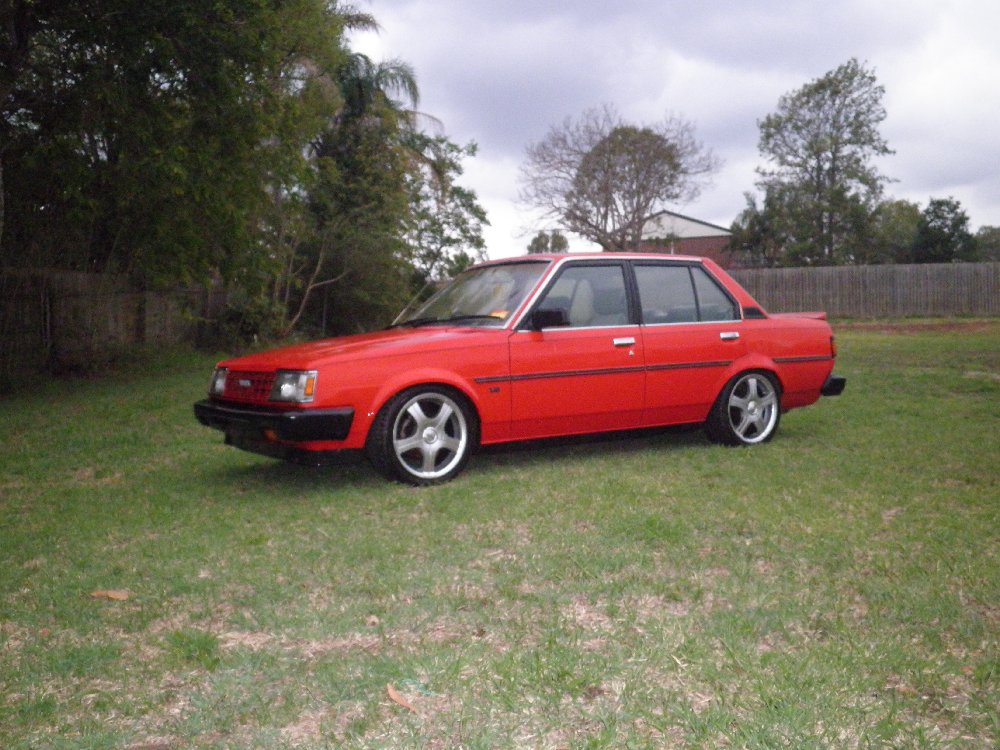

love ke70 Posted November 27, 2012 Author Report Posted November 27, 2012 Yeah, I'm happy enough with how the 15's look, just don't wanna go to the 16 that would let me fit a brake setup much easier. with the 15 I can easily run a 280 disc, but i want to run closer to a 300, which means I need the rims before I can finalise anything, which is a bit annoying. basically snot, its all going to be custom with a custom hat. at the moment I'm tossing up between te37's http://www.rays-msc.com/wheels/index.cgi?d=90 and these meshies http://www.ae86drivingclub.com.au/forums/attachment.php?attachmentid=26586&d=1345101447 Quote

love ke70 Posted April 14, 2013 Author Report Posted April 14, 2013 SO, I bought wades old rims for street duties, more photos here: http://s29.photobucket.com/user/arowland2/media/wades%20wheels%20now%20mine/IMG_2307_zps8c5abbf1.jpg.html?sort=3&o=6 2 rims are 15x8,-10 offset these are fitted with 195/50R15 Marshal with plenty of tread 2 rims are 15x8.5 -17 offset this are fitted with 195/50R15 Duruns with plenty of tread And I am still waiting to here back from Rays about details on the TE37's I am looking at which I will use for circuit. Under the rims I have bought I can fit a 299 rotor with a ZR34 caliper from Performance Friction. They make some cool shit. http://www.pfcbrakes.com.au/products.php?pageId=43 was going to reuse the old calipers off the alfa diff for the rear, but they seem to be 9 parts ʞ©$ɟed, So i might bite the bullet and go good shit all round first up. Suspension, looking into S13 hub with MCA suspension http://mcasuspension.com/red-series/ dealing with MCA to supply suspension, I like the look of the red although not sold on the single adjuster, 2 way would be nicer, but i question whether I will need it or not?? Ken at accurate suspensions is going to set the car up, I have the whole front end out of a S13 here, and we will throw that in and decide if its what we want, or what we are going to do. At the same time I will get him to mount the new rack I have bought, to do away with the wobbly old steering box, I have purchased an AW11 rack out of the states, which is the same as an AE86, Elvin, the guy who helped me out so much importing the car has sourced the rack and is going to post to me, and I have ordered a quiafe quick rack out of Palmside.co.nz as they were able to match prices with a British supplier. So that should get the front end out of bumpsteer territory and nasty kingpin angles etc, if it doesnt I will decide on something different. I have done away with the power steer thoughts at the moment, Just see how it goes first. Tonight I actually moved the car into the shed, pulled the axles out with the aim of getting the wheels and axles re drilled to suit the 4 x 114.3, as the rear at the moment is currently 4 x 108. Hopefully it can be done. I will be bummed if it can't. I'm sure someone will be able to do it though, then the wheels I have bought will actually fit front and rear. I have also ordered a bunch of seals etc from ebay, and got my glass back from PGI after it being lost for 2 years. as it turns out they can't remake it for me, but owell, at least I'm back where I started. I have a lead on a dude in philipines, malaysia, indo? somewhere in that region who recreates vehicle rubbers, so I am going to approach him about doing new seals for the pop out glass, as I can't find it anywhere, and I'm not the first person to not be able to find it. The car is also booked in to have cage finished, seat and pedal box mounted etc etc in june, so all the suspension, steering and braking needs to be sorted before then. Might actually make some progress soon hey! all input appreciated guys, on any of the things I am doing. Cheers, Andy :) Quote
