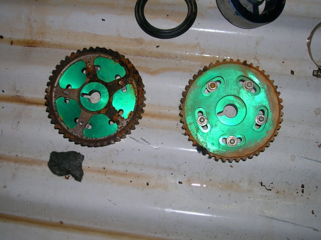

love ke70 Posted February 20, 2011 Author Report Posted February 20, 2011 so thats sorta how anything in the car came out, alternators, starters, cams, seats, etc then i pulled the motor down, apart from the cams everything was good, and the cams were not too bad in this motor, definately salvagable, but theyre babies, HKS 248, 7.3 and 256 8.1 before putting anything away it got degreased and pressure cleaned, then what needed to not rust was wd40'd so should make a nice clean reassembly. then i did the gearbox, which even though had a bunch of water in it, the gearsets had stayed dry, so they were good. and i think i said thats been rebuilt? :) then it was the diffs turn, which too has been rebuilt, but there was no water in it, which made me rather happy, considering its a near new crownwheel and pinion. so just needed pinion bearings and the limo reset this is how the cams looked when they came out the car one of them still wrapped from where it had been sent to wade cams and reground, due to a couple of pitted lobes. as you can see, pretty poor looking, but the mechanic reckoned he could fix it on the lathe with some emory paper, so i had to find out for myself, before taking them to him. so i got some emory paper and had a little go they cleaned up alright, surprisingly, so i took them to him, and he will finish them, and hopefully they hold out just fine :) bought all new headlights yesterday, might get to fit them this afternoon :) Quote

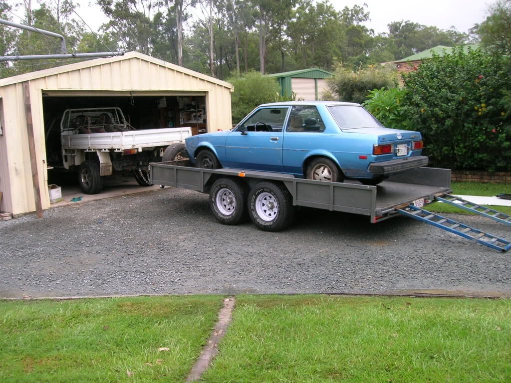

love ke70 Posted April 12, 2011 Author Report Posted April 12, 2011 so on the weekend, which i spent most of working, then fixing the ute. i got to the corolla. tail light earth and dead stop light fixed. exhaust leaks identified, flange from manifold to pipework, and a dirty big crack behind a weld, the thing is ready to fall in half. grr nothing that can't be patched though. pulled off the steering idler and inner tie rod, got replacements. getting the tie rod off was a hell of a job! replaced tie rod went to replace steering idler, and of course, cause i said match it to a t18, the bracket and everything is backwards, lhd rhd etc so thats all good i thought, use old bracket, new idler. wrong, the centre hole was the wrong size. like alot of things on this US car, the stuffs bigger. and they must have had the thing on the shelf for so long the rubber had perished and just fell to bits. got around it though, pulled the old rubbers out of the old idler with a spigot bearing puller, fitted them to the new idler, cause it was only the balljoint that was f@$ked, and put it all back together. win :) which brought me to the siezed shock, and the seemingly simple idea of swapping the struts. well, it should be but i had to go and make it hard, looking at the RA65 steering arms, and got to thinking they would work so much better if i could swap them left to right anyway, i started a thread on here and one on toymods, and was met with, the angle might not work, and if the angle does work, it will be good for scrub radius. so measured it up, and decided to give it a try, got to the point of putting the strut in, and discovered te72 strut top bolt pattern doesnt match ke70. so my adjustable tops don't fit now. now to decide whether to swap to standard tops, order new adjustables and delay the install and hope i end up using them with the final suspension setup. or just replace the siezed shock in the standard strut and pass rego with that. then come back to the swapping steering arms left to right game, which i may never get to, as the rest of the suspension and steering conversion will be getting done... i dunno! haha Quote
love ke70 Posted April 17, 2011 Author Report Posted April 17, 2011 alright, so after work on saturday swapped a standard shock in, fixed the flange leak and welded the exhaust, got eveything back together and on its wheels, happy that everything for roadworthy was done. did a mad burnout in reverse, filled the shed with smoke, and called it a night, deciding the handbrake had jammed on one side. so this morning i had a play, and after repeatedly doing the same thing i decided it must be a stuck cable, and i had also broken the outer, so without removing the brake shoe i got the cable out, which is easier than it sounds. people that have removed one before will know how fun it is to get the 3 tabs flattened out and through the hole. stripped a cable out of a spare diff laying around, installed, adjusted and took it for a spin. lovin life :) got my 15x7s on the front with toyo t1r, sticks like shit to a blanket :D Quote

love ke70 Posted May 31, 2011 Author Report Posted May 31, 2011 so its rego'd :D its so f@$king slow its pathetic, but i still like driving it. its slower than my old 4k ke70, the auto just makes it feel dead, the auto wont change unless throttle is almost shut, got beaten off the lights by a grandma in a yaris not trying, :lolcry: car also doesnt like to start once hot, and when i was driving in the rain it was as if the lockout got water in it, and wouldnt recognise i was in park or neutral, just wouldnt turn over. changed its mind after 5 minutes but i try to not turn it off if i drive it somewhere haha but owell. not for long. gonna contact my engineer and see what capacity i can go up to, seeings as this starting weight is more than a ke70, not sure by howmuch though... not sure whether to stick with the 1g or not, just due to weight distribution, can always move it back, but its gonna be a big section of firewall to play with.. wanna get it together and just corner weigh, and estimate cage weight and what that will do. can't really build cage til motors in, or not the front section bracing the strut towers anyway. might get the rest done... dunno if i posted pics of the only way the car does 110? tehe :D Quote
