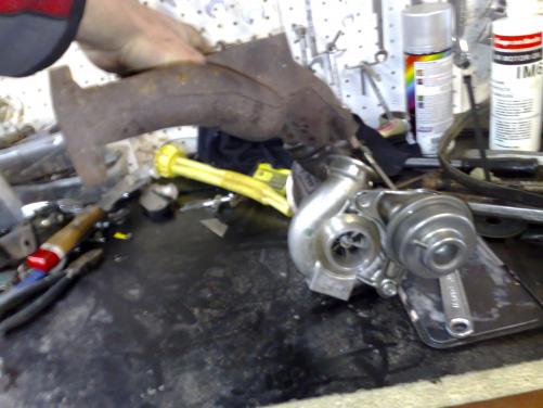

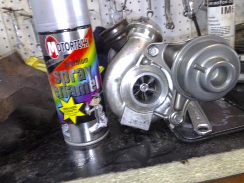

Taz_Rx Posted August 19, 2009 Report Posted August 19, 2009 yoooohooo taz_rx where areee youuu :y: 1, That turbo is WAY WAY too small. Are you sure its from a 1.5lt motor?? Looks more like a turbo from say a Smart car... yes they're 600 odd cc turbos. Oh and coming from a 335i would indicate its a 3.5 litre BMW (first 3 is the series, last 2x numbers are engine size - 318i is a 1.8lt 3 series). Can you try and clarify for us what car this is indeed off?? It looks even smaller than my old CT12 and that was rediculously small. 2, the turbo is sooo small i reckon a 4k will spool it at 1 grand But at six grand shit will fly It doesn't work like this. I would dare say that with a 4k at 6000rpm, this turbo would be such a restriction on the exhaust flow of the motor that it wouldn't go much better than a stock 4k!!! Only time it would be any good would be the spool up, once thats over you might as well be NA again!!! 3, I hate to say it, but most of the FAQ turbo K series info its pretty incorrect. It was pretty obviously written by somebody that had never actually turbo'd a K motor, but collected info by others on it. I mean really, anybody that has done it would not say that they can't take any more than 10psi..... thats just when the fun really starts. :lolcry: I have been meaning to re-write the whole lot for quite some time and I can now cover xKTC's and xKTE's with my personal experience. I've actually just started a months holiday so maybe I can get it done soon. 4, Yes a 4k head on a 3k will drop the CR a bit, just like in reverse. This is a much better idea than using a thicker head gasket or spacer plate to drop the CR, as its also going to send your quench area all up the shit. 5, I think on 10 pound you're going to blow the shit out of your motor, not only problems with pinging. Fool! :) First thing to go will nearly always be the head gasket. After that expect some busted ring lands. 6, aym23q has already mentioned the carbon seal issue, and I highly doubt this turbo would already have them. Hence it want to use it budget for around $600-$1000 for a rebuild to get it up to draw through specs. He's also correct on the fact you can't use an intercooler. 7, and as for this...... I'm thinking again about this project, ill probally end up spending $1000 on a rebuilt 4kc and parts, and a sr20det costs $1300? Sure you might be able to get the motor for $1300, but you're not going to get it running in the car for less than say $5k!!!! :cool: Where as, build a turbo K and $1k is all you need. :bash: Quote
