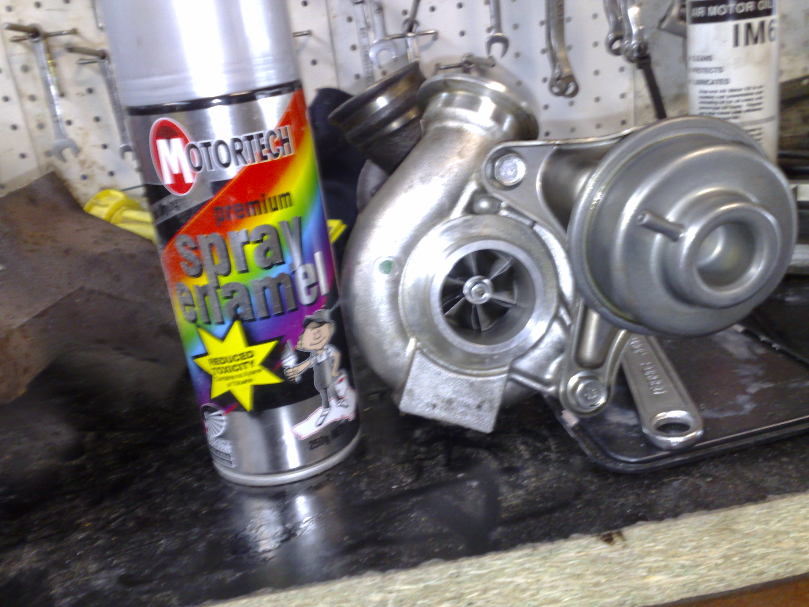

Evan G Posted August 16, 2009 Report Posted August 16, 2009 hi people, i got a turbo from a bmw 335i, its a 1.5L turbo that runs from 3 exhaust ports I'm planning to run 6 - 8 psi bog stock engine carby on the inlet of the turbo (10 pounds on fresh engine) questions.... how long will it last before KABOOM also i know i should decomp the engine, can i use a 3k bottom with a 4k head? its on a budget TURBO PICS yoooohooo taz_rx where areee youuu Quote
