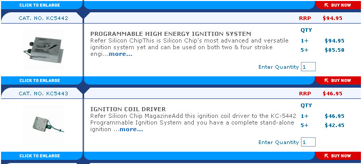

altezzaclub Posted May 26, 2010 Report Posted May 26, 2010 What does the ignitor look like Taz?? A fat transistor with two wires? I'm currently hunting around for electronic options for the 4K. Just the transistorised voltage booster would do, and keep running the points on a lower current. Seems like there are- -Kits from electronics people like Jaycar that you assemble. -Aftermarket boxes that you bolt in. Some seem to be replacing the points with a Hall Effect sensor, others run with points. -Replacements from other cars that fit, like the Starlet dizzy above. A lot of the stuff on the web is from years back and is no longer available. Anyone got some recent ideas? Quote
altezzaclub Posted May 26, 2010 Report Posted May 26, 2010 Ah- OK, the Jaycar kit needs a separate igniter too- $145 would do it- Quote
